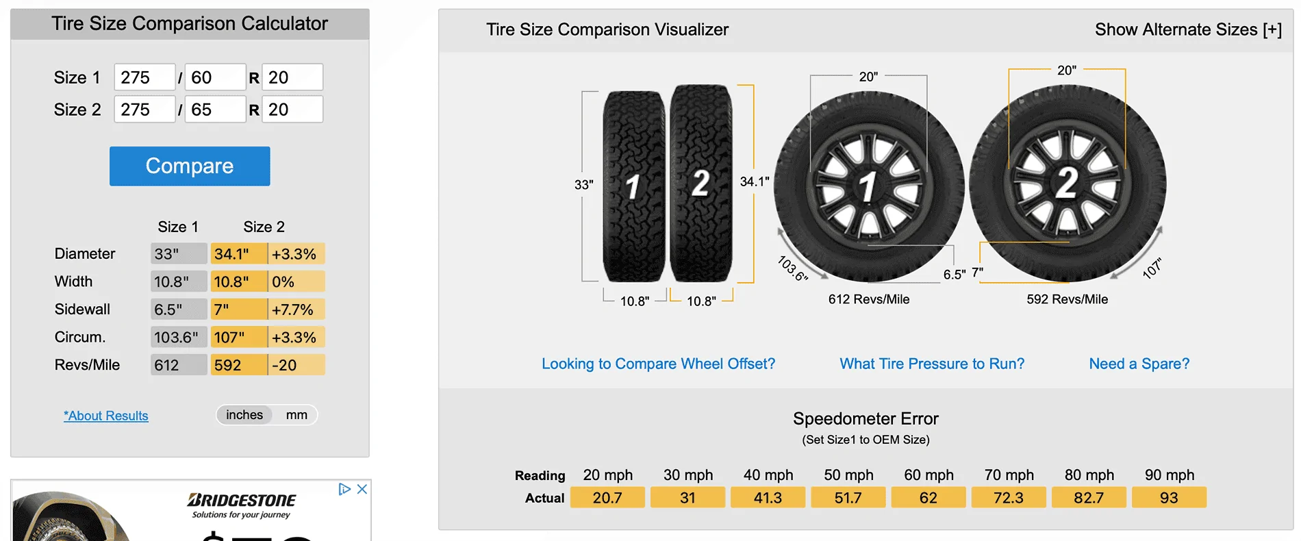

Would someone with these tires post pics from dead on front and back? My biggest concern is the narrow width looking awkward...
They're the same width. 275/65/20 and 275/60/20 both have roughly a 10.8" width. Nokian says they're 11" wide and Pirelli says they're 10.98" wide.
You're only losing 0.5" of ground clearance just like the 21" has. Here is a comparison visual:
I guess I'm confused... On TireRack, it says the Michelin's only have a tread width of 7.8" vs 8.8" for the new Goodyear OEM option and 9.1" for the original Pirelli ATs.
Tread width is different than tire width. Tires are often rounded and not square. Visually you don't really notice it too much, but when you measure the actual tread, it will be different. If you want a better explanation watch this starting around 7:50 mark
