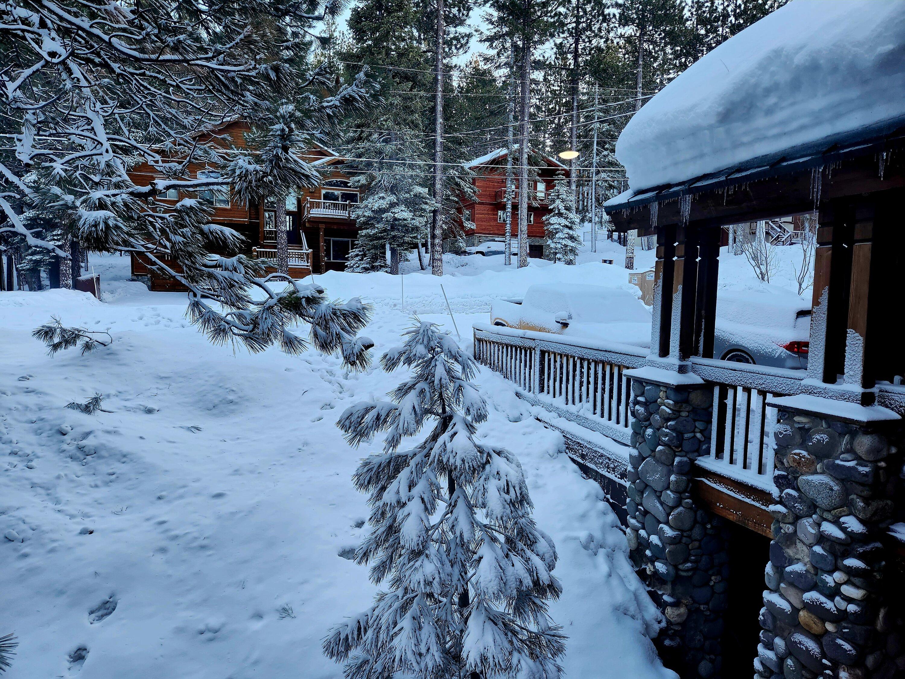

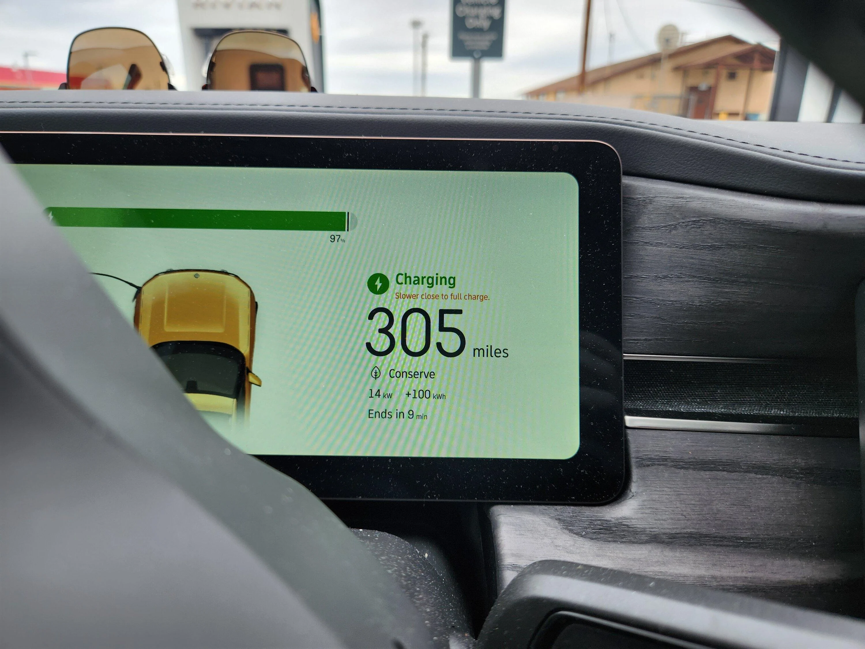

Just got back from a ski trip in the Truckee area (Tahoe) with the Nokian HK LT3s on the standard 20 AT rims. Very stable and secure-feeling. Having a RAN charger right in town didn't hurt :cool:
My range was great but then it was just around freezing or a few under most of the trip.
