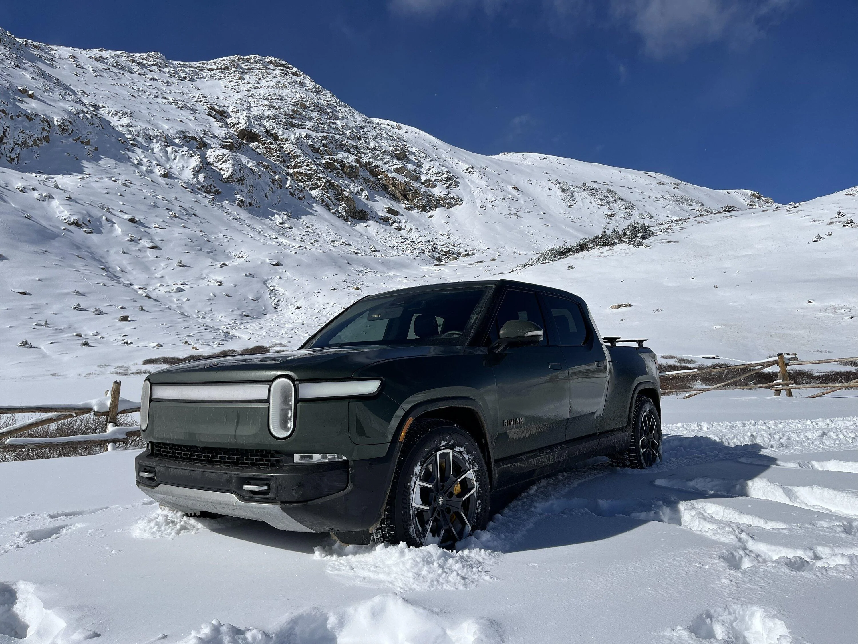

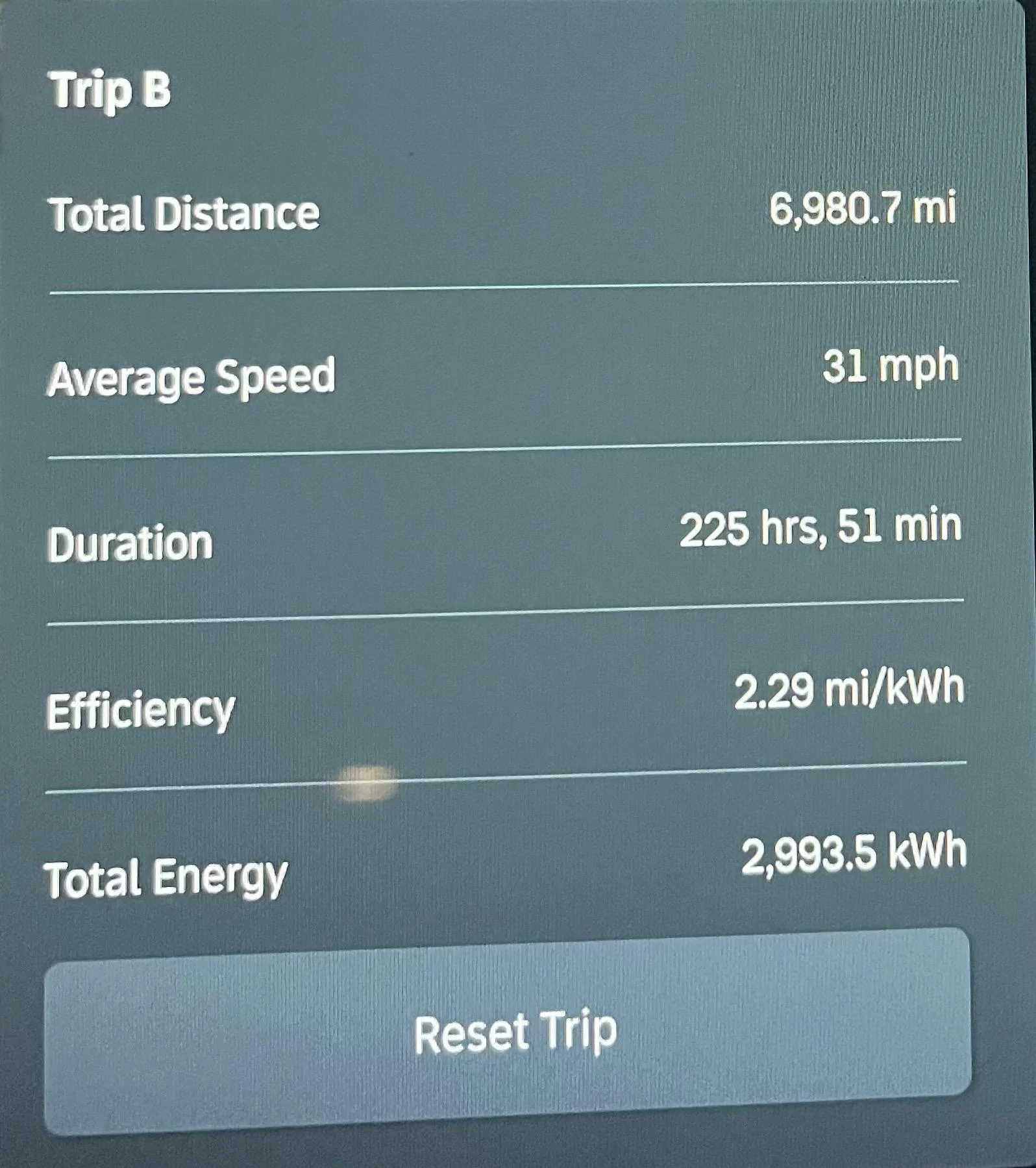

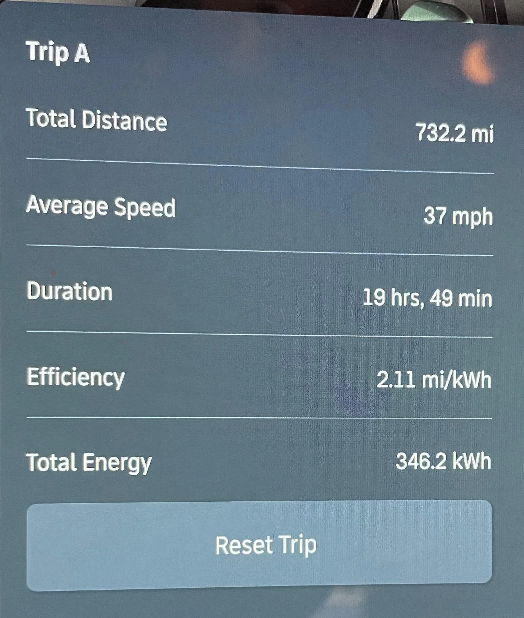

732 miles in, here are the details. It is not a scientific test; both time periods have had rooftop tents, skis, bikes on the crossbars... the recent driving has had some colder weather driving but not too much below freezing. Definitely some heat use, I would say temperatures averaging closer to 50 degrees compared to the summer of closer to 80 degrees. So lately about 92% efficiency relative to the 20" AT tires, with the cooler temps and blizzaks. Not too much time on snow yet.
Rivian R1T R1S 20” Blizzak snow tires installed IMG_7884

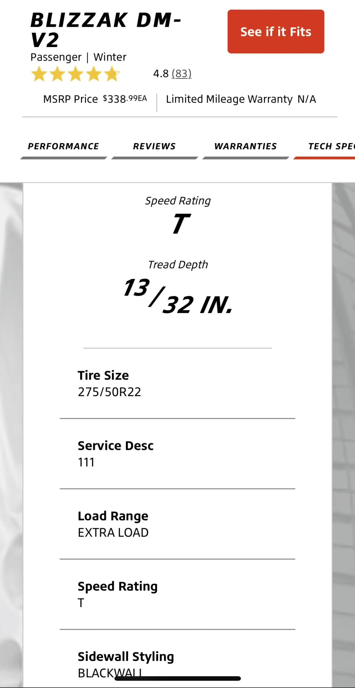

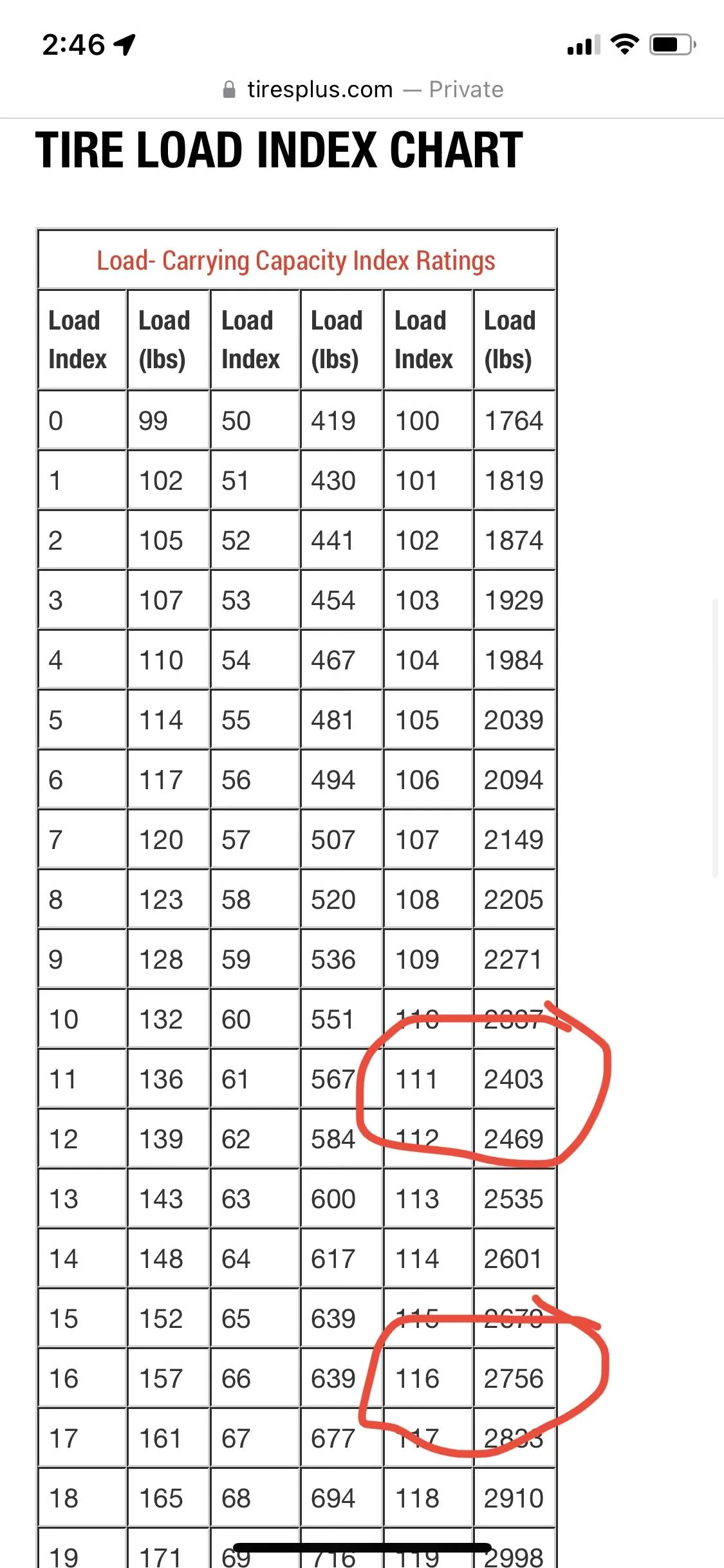

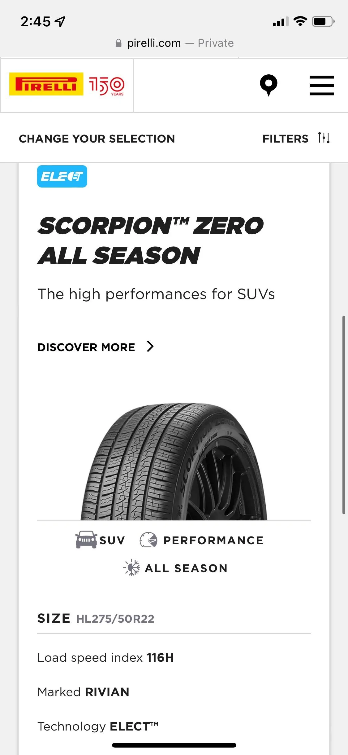

Are you concerned at all on the load and speed rating on the Blizzaks vs the stock Pirellis? The Blizzaks have both lower speed rating(not really an issue as I don’t intend to push my Riv above 100 mph too often ha) but also load rating.
