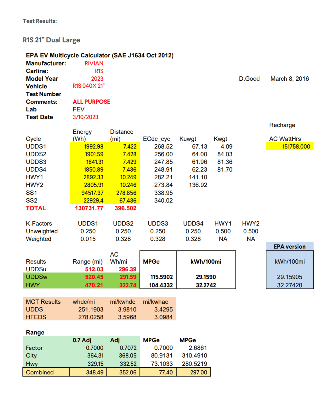

what does that all mean (is it the combined # that is going to be the range)? I looked at the report and one section had " Equivalent All Electric Range (miles) 520.45 " but unsure of what that means? I'm assuming all this testing was with the large pack, not Max Pack?

If I'm reading the chart correctly, it would seem that the dual-motor R1S with 21" wheels, has a prospective adjusted combined EPA range rating of ~352 miles. That compares with 321 miles for the quad R1S on the same wheels, and is only about a 9.6% improvement.
While that's not trivial, it's quite a bit less than I would have expected in going from four motors down to two. Is one of the conclusions that the new Enduro motors are not particularly efficient?

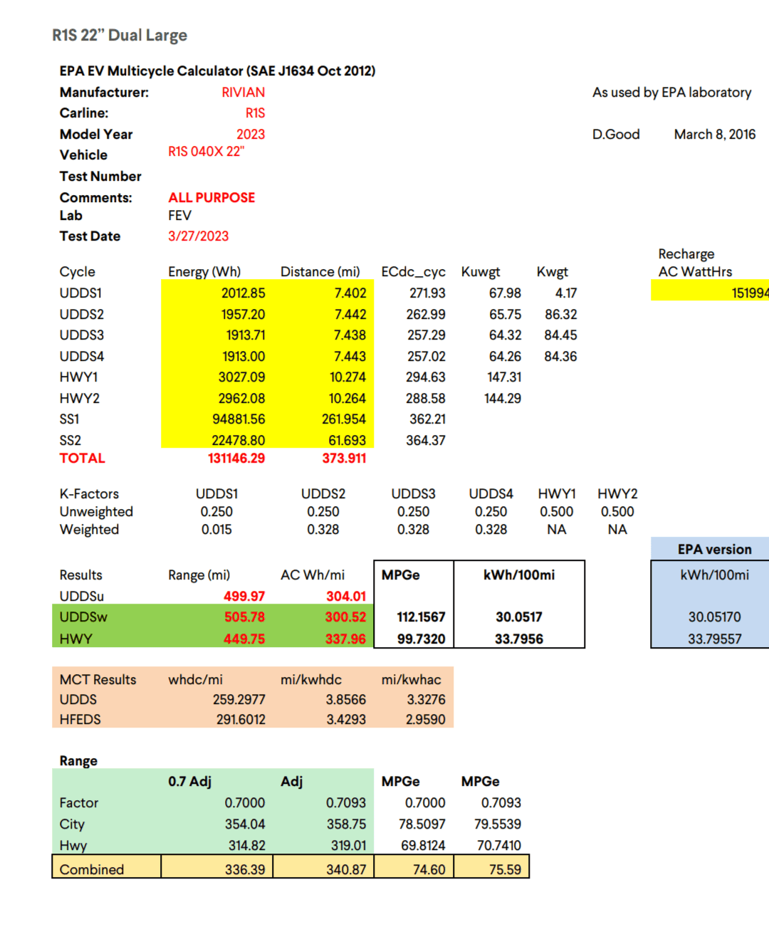

Rivian's website lists the R1S 21" wheel dual motor range at 340 miles. So, the EPA numbers seem a bit better than Rivian's own published figures.

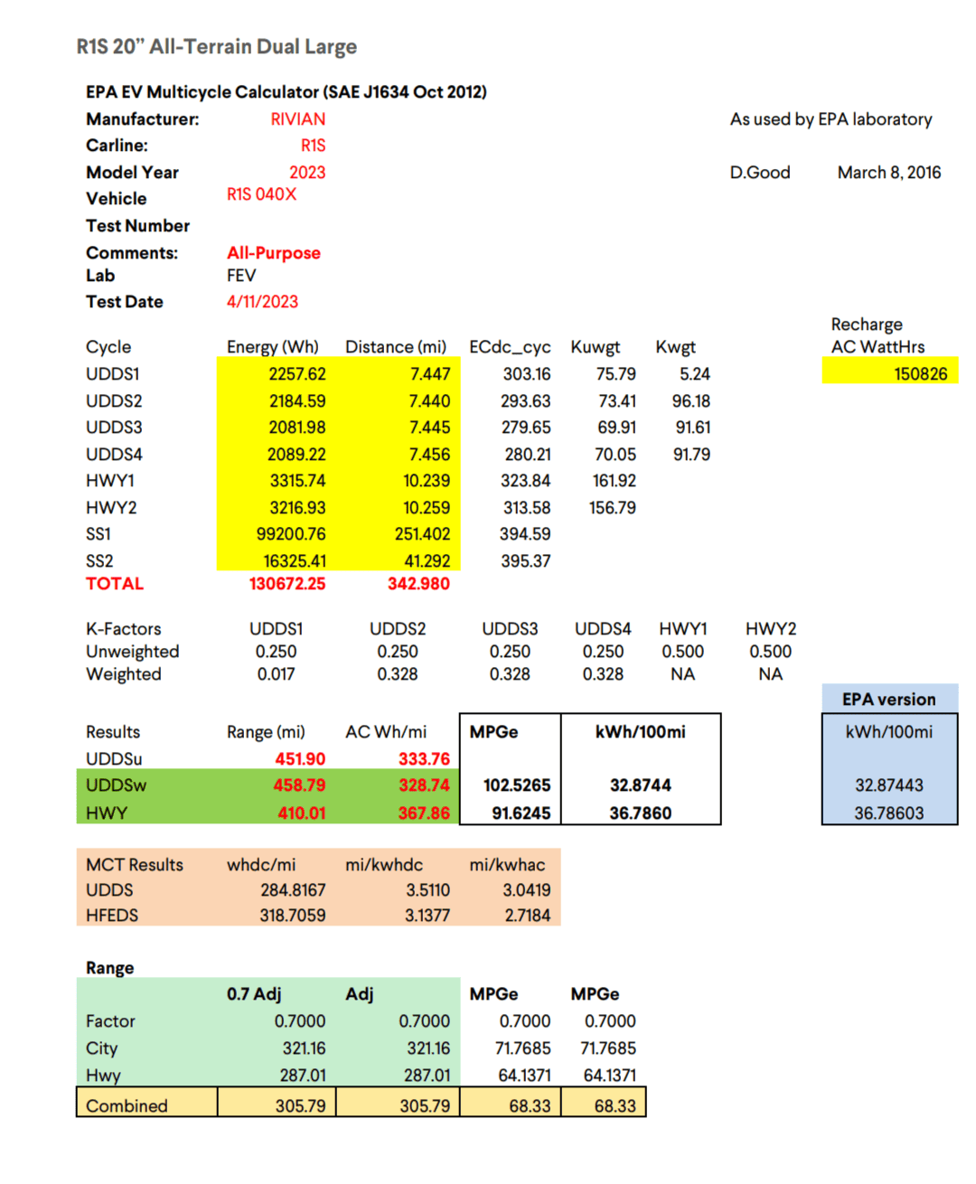

has anyone seen the dual R1T with the standard pack? that's what I really was looking for. 340 with a large with the R1S I think is pretty great actually.

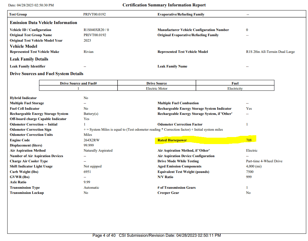

Showing rated HP at 708.
The tests are run in a lab, so no wind resistance. A correction has to be applied to the lab range numbers to simulate real world driving conditions and estimate on the road range.
