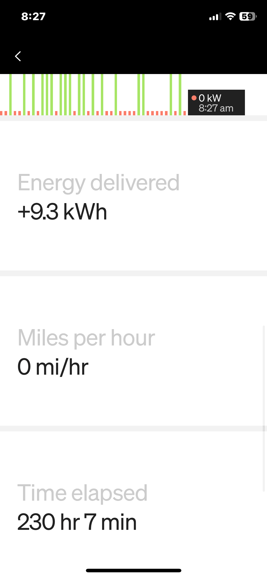

I've never tracked vampire drain. Perfect opportunity to track while on vacation for 10 days. Left vehicle in garage plugged in with charging set to 70%. Left Gary on for everywhere. Not as bad as expected. 9.3kWh over 230 hours seems ok to me. Cost would be about one dollar.

Is your garage heated?
With that level of drain, you should be able to leave your vehicle parked somewhere while on a backcountry trip and still come back to a stress-free drive home.

No Heat. Daily temps about 32-62 during that period

That's about the same as mine- 40.44 watts per hour (9300wh/230hrs)
The truck is greedy when it is plugged in though and like someone else said, the app graph cannot be trusted. Leaving it unplugged would give you a more accurate vampire drain picture.
Wasn't referencing the graph. Are you saying the total energy delivered is incorrect? I would say it's pretty darn close
I believe he is saying that the truck uses more energy while plugged in than while unplugged, taking advantage of the fact that it is not energy-constrained, so it may not be fair to characterize the vampire drain of the truck from its 'plugged-in' state
Yes, correct. Thank you for your much more eloquent response. ?

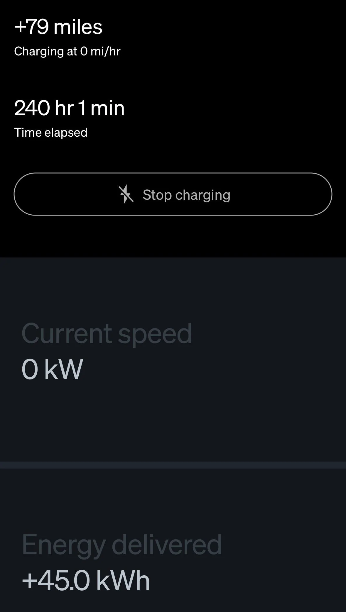

This is A LOT better as compared to similar observations I had while away in 1/2023. Car was plugged in the entire time and by day 10, the truck added a whopping 45 kWh of juice.
However, things are much better now since the OTA that fixed the frunk sensor preventing sleep issue. My vampire drain is now about 1-2% per day, which, as others have opined, is still too much but tolerable.
