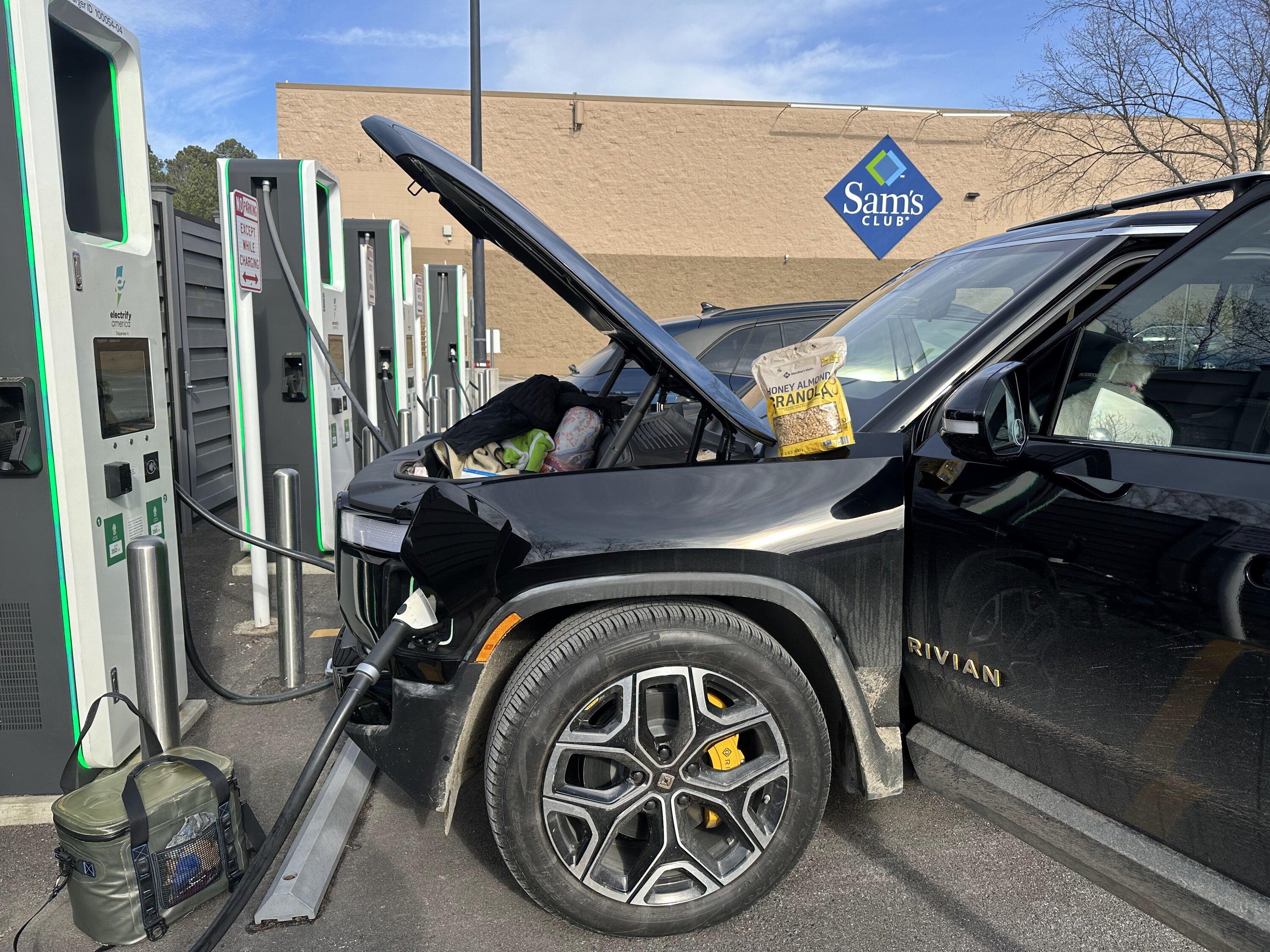

I haven't yet been able to drive more than 200 miles without feeling an overwhelming urge to stop at Sam's or Wal-Mart to go pee and buy some granola, but maybe that's because I have 22s and usually drive in all purpose auto. I thought that might change after the most recent update but it didn't...

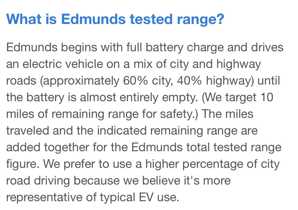

Edmunds buries their methodology. 60% city is the reason they have inflated numbers. I prefer 100% Highway testing since that is when most people care about range on those long highway drives
