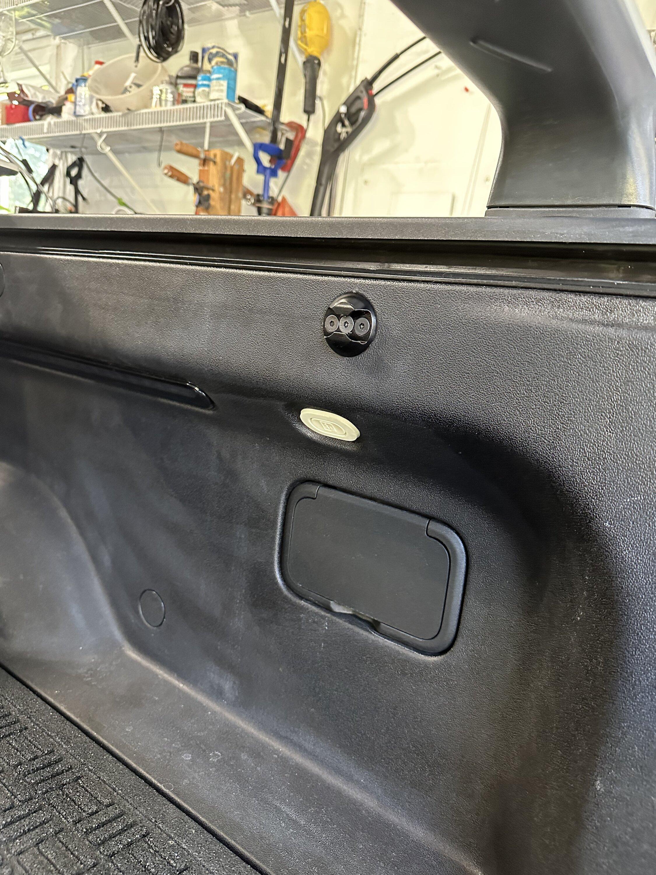

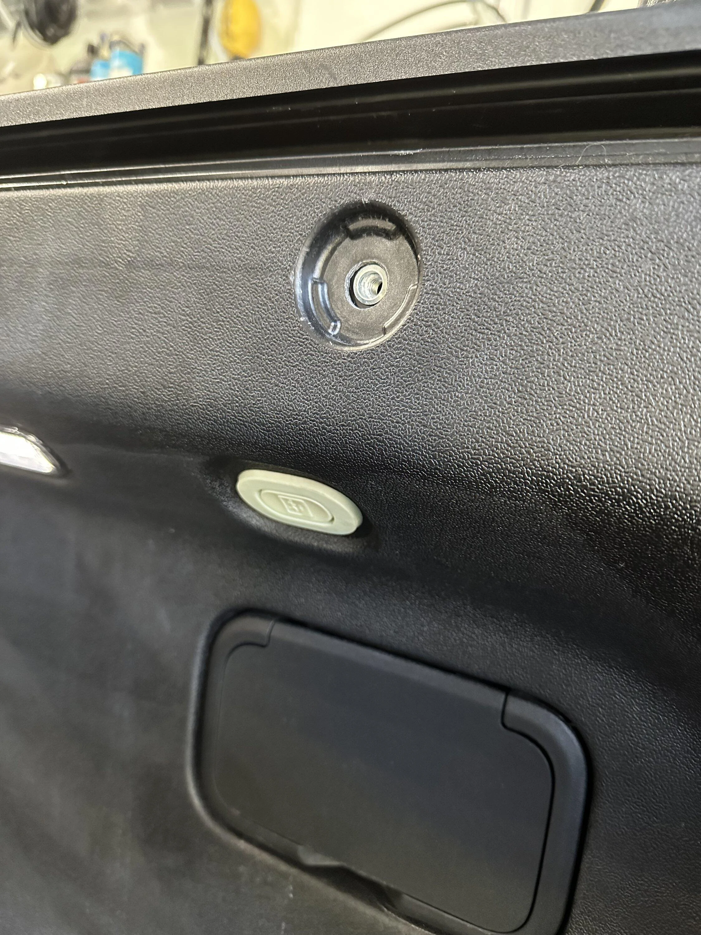

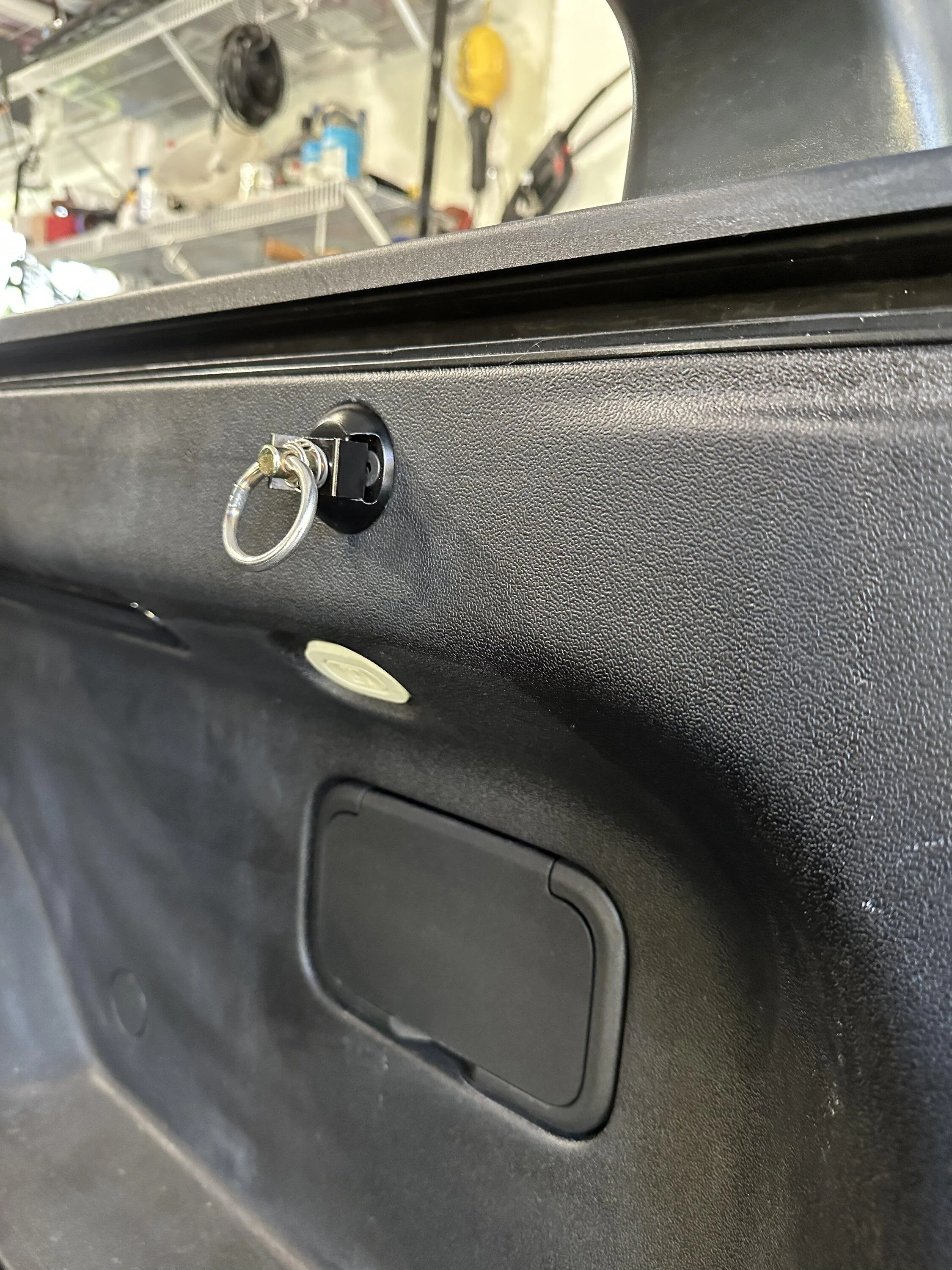

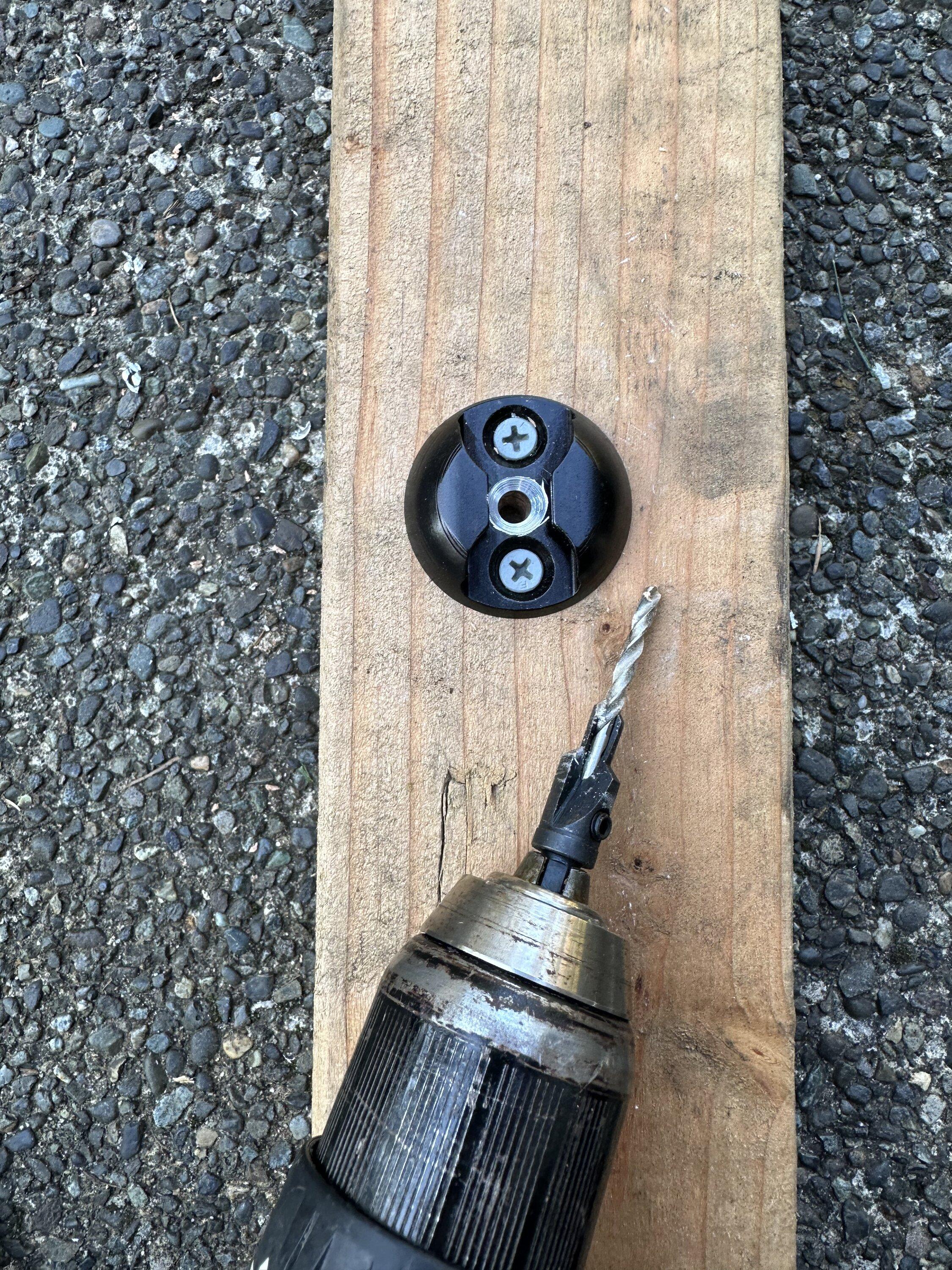

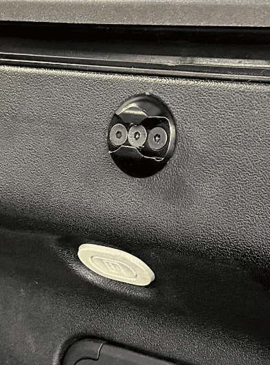

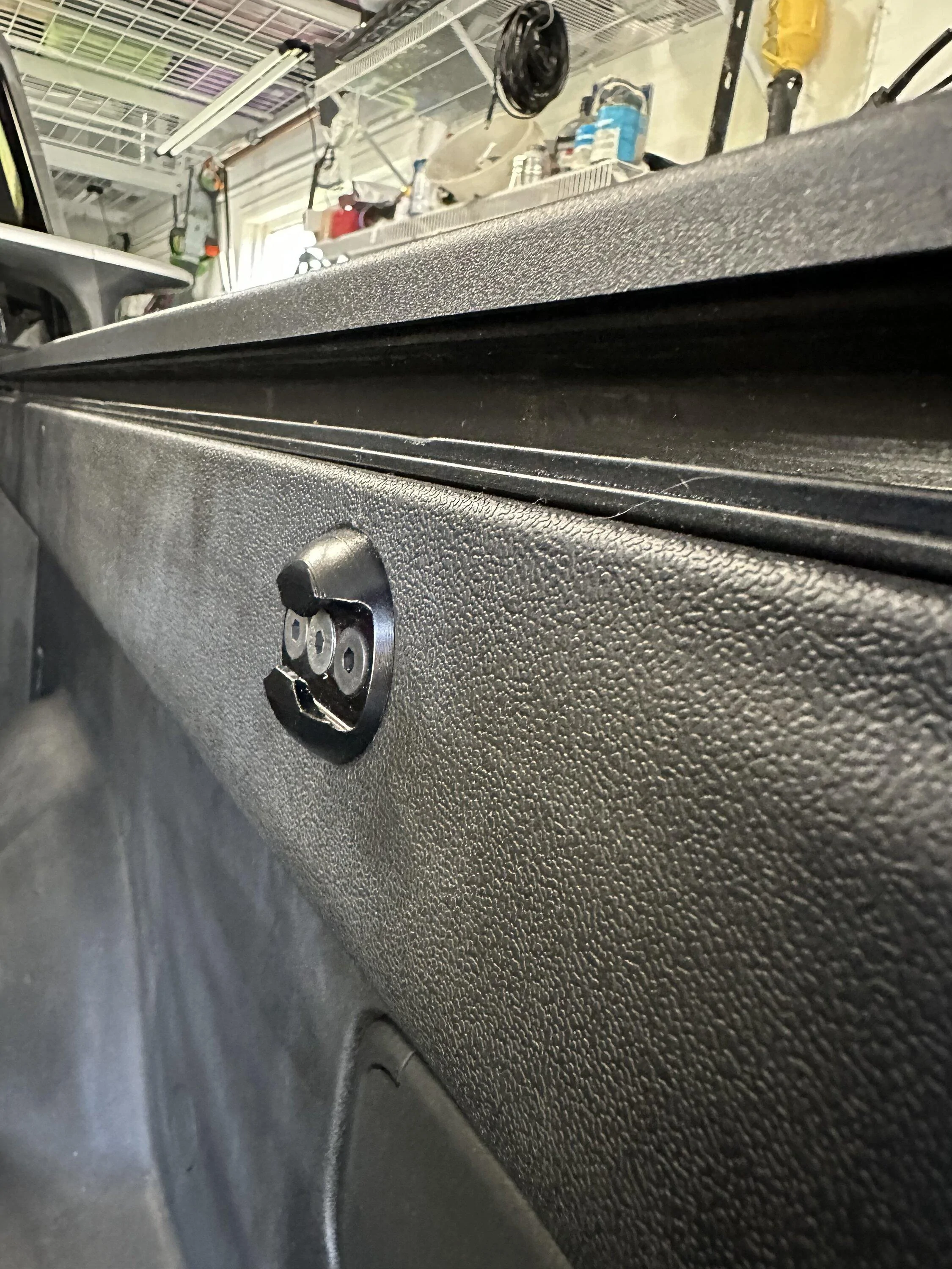

Hello again, fellow Riviarians! In addition to completing my @EV Sportline running board tread plate welting mod, parts arrived this afternoon for my much needed tie down mod.
No modifications or drilling into the truck! And more importantly, no “weak between mounting points when using L track (perpendicular to track loads)”!
For those interested, I can post a BOM and instructions later, however, as they say, “a picture is worth a 1000 words”!
Edit: I know I need to clean up the center countersink; just wanted to get the post up.
Eight added to existing recessed covered fasteners rear upper mounts for my cargo net!
Nope or dope? Vote in poll, please!

Hello fellow Riviarian! In addition to completing my running board tread plate welting mod, parts arrived this afternoon for my much needed tie down mod.
What?
I can only suggestion using separate sentences.
You have found tie-down hardware that fits the plastic bed liner where there's existing threads in the body.
You've drilled that hardware with a new hole to line up with the existing threads in the body.
A single threaded machine screw with a countersunk head connects the hardware to the body.
If wanted, someone could drill two more holes into the body and use self-tapping countersunk screws to add some alignment and perhaps strength.

What?

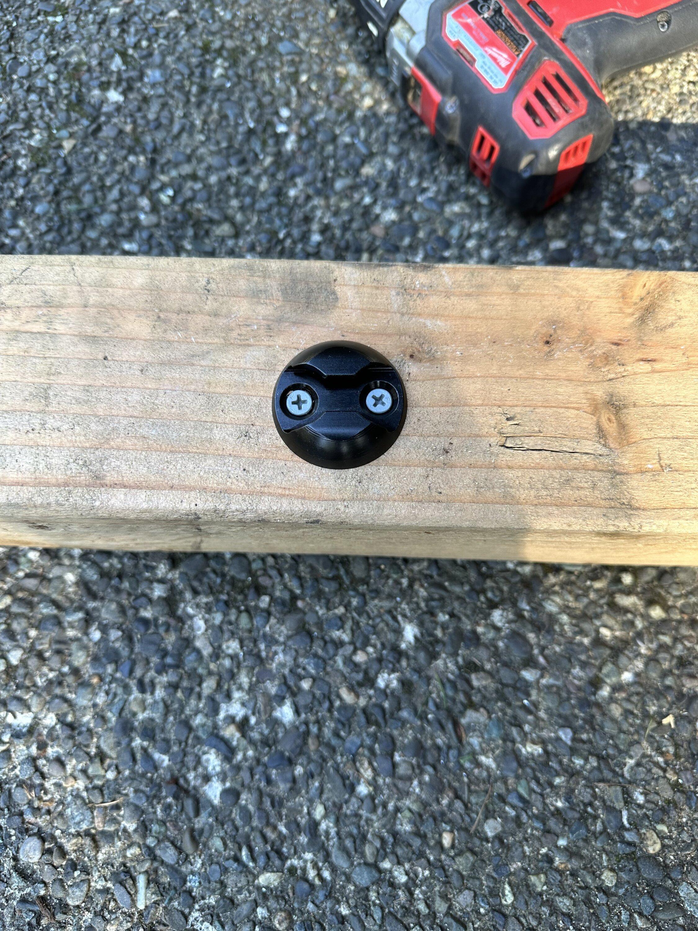

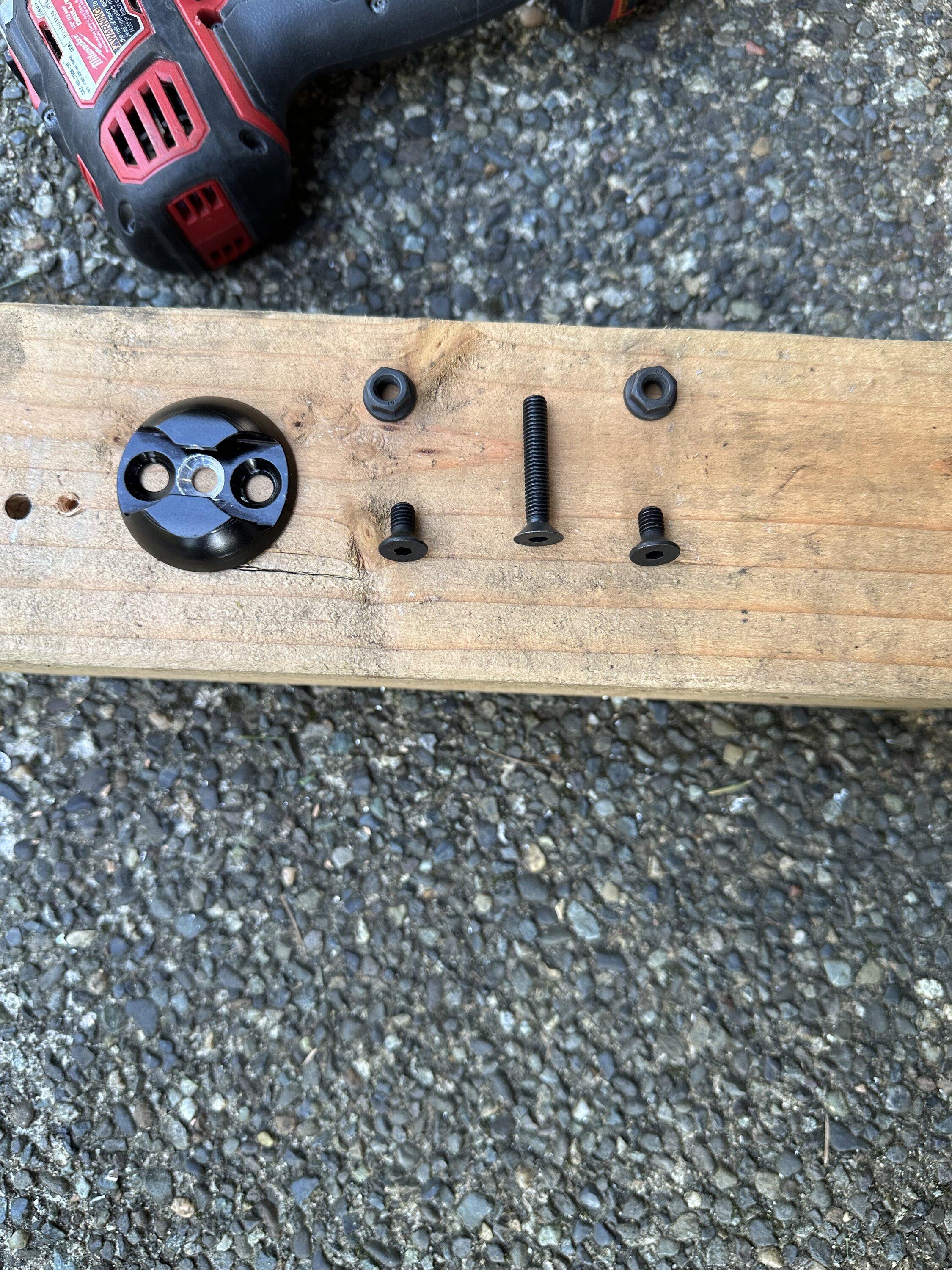

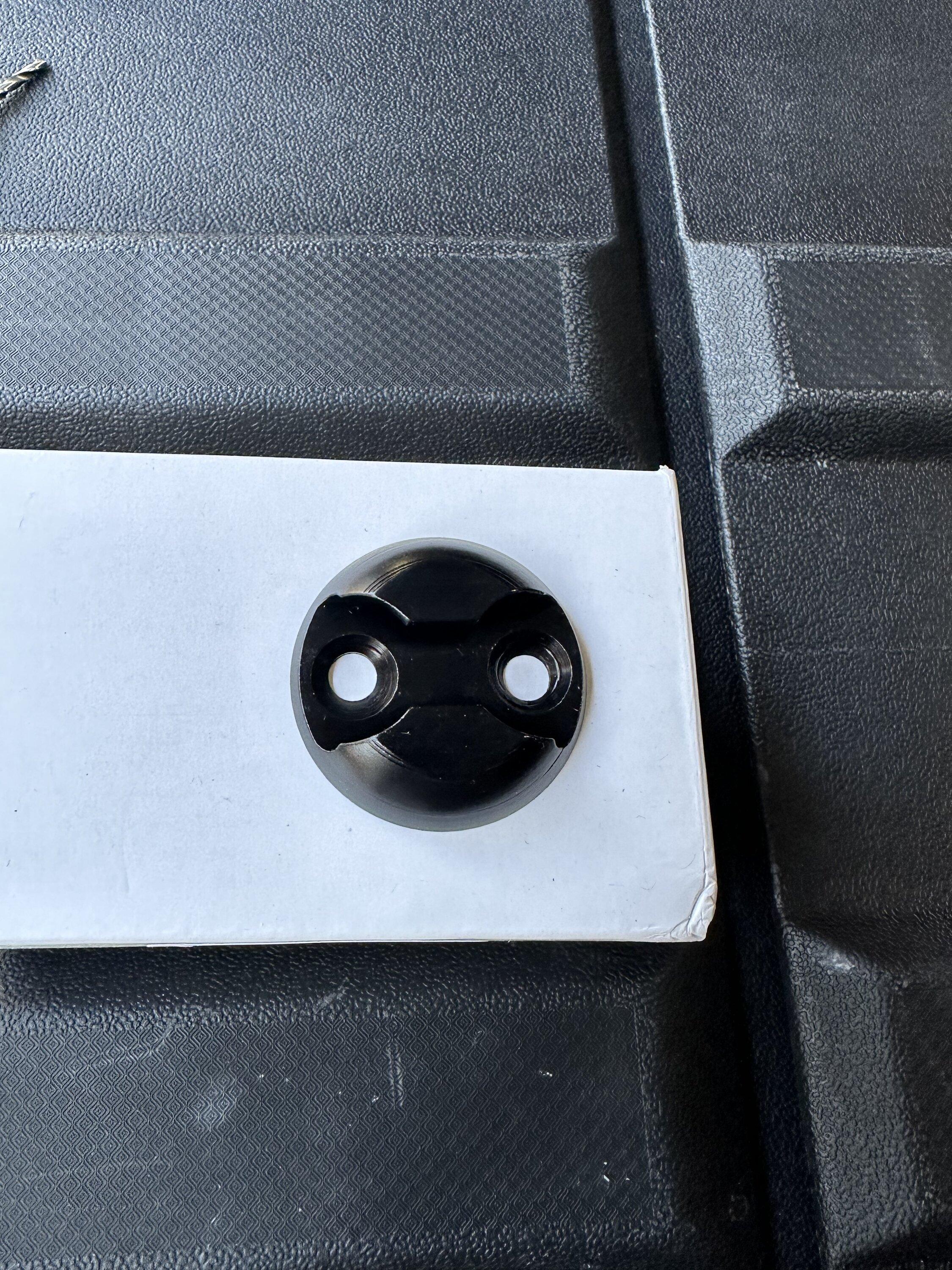

Where did you get these? I wanna do this asap
I ordered these for prototyping, because they were inexpensive and arrived over night. Turns out they are anodized black aluminum, vs. painted steel - and I wanted black anodized aluminum, so Inwill be keeping these. I got the M6 black bolts at my local fully stocked non big-box hardware store (Johnsons Hardware).
HERCOO Round Tie Down Anchor Point Kit Bolt on Track Fitting with Quick Release Compatible with Pickup Truck Motorcycles Snowmobiles https://a.co/d/7CL6ViS
Note: Many versions/variants are sold by many vendors, and they all have different dimensions. These just fit in the existing side panel depression, which is also what I wanted.
