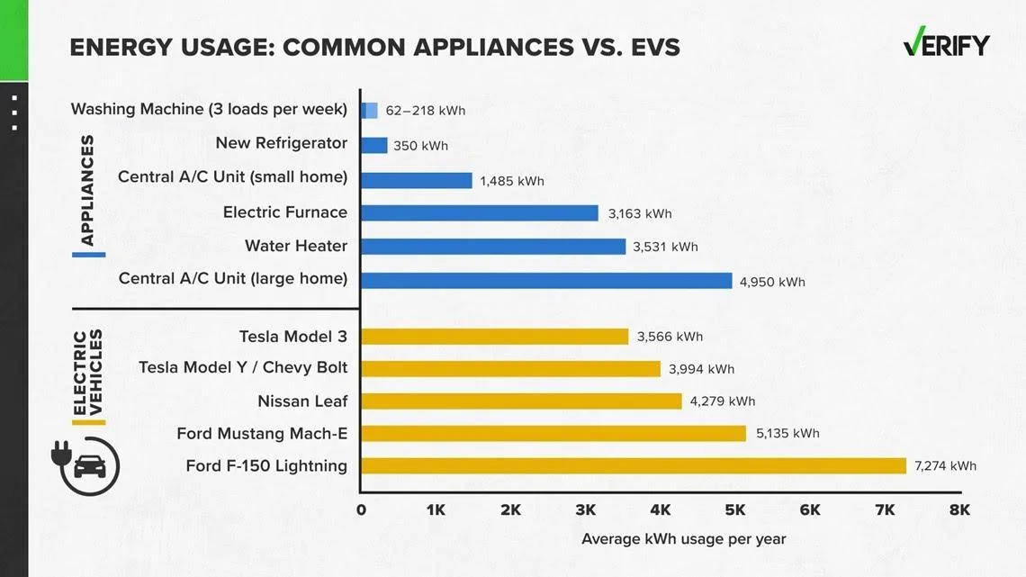

Interesting article about average annual electricity consumption of EVs vs other household appliances. Anyone know where our Rivians are in this mix?
Quote :
Here’s the breakdown of how much electricity each of six popular electric vehicle models would use annually using this model:
Tesla Model 3: 3,566 kWh at 0.25 kWh per mile
Chevrolet Bolt: 3,994 kWh at 0.28 kWh per mile
Tesla Model Y: 3,994 kWh at 0.28 kWh per mile
Nissan Leaf: 4,279 kWh at 0.30 kWh per mile
Ford Mustang Mach-E: 5,135 kWh at 0.36 kWh per mile
Ford F-150 Lightning: 7,274 kWh at 0.51 kWh per mile
Rivian R1T R1S Rivian vs Tesla vs Frigidaire?! (Average annual electricity consumption) b5f55734-edd9-4425-8faf-1d653d39f83f_1140x641
150
13,707
27,820
Engineering, Dog Petting

I guess articles like this have some value to illustrate concepts of what kWh usage translate to. But I'm not using my Rivian to store groceries, nor am I driving my Thermador fridge to work or vacation, so the value of that comparison is minimal IMO. ?
Exactly. So the more relevant comparison is the energy equivalent usage of a gasoline-fueled vehicle of the same class. e.g., the EPA-estimated fuel consumption of the popular 3L 6-cyl version of the F150 is 20 mpg city/hwy. Driving the national average 14263 miles/year, that F150 would burn 14263/20=713.15 gallons of gas, which when multiplied by 33.7 kWh (the EPA's estimated energy equivalent of one gallon of gasoline) results in an annual energy consumption of 24,033 kWh.
So by my calculation the Lightning consumes ~30% (7274/24033) of the energy consumed by it's gas-powered equivalent.
That comparison means nothing in real life though. Although a gallon of gasoline contains the potential energy equivalent to 33.7kwh it cannot be extracted efficiently into actual usable electrical energy.
And yet the EPA thought it was valuable to introduce the notion of MPGe. Clearly they see some educational value in the comparison, even if you can't simply empty the gas tank and convert it to equivalent electrical energy.

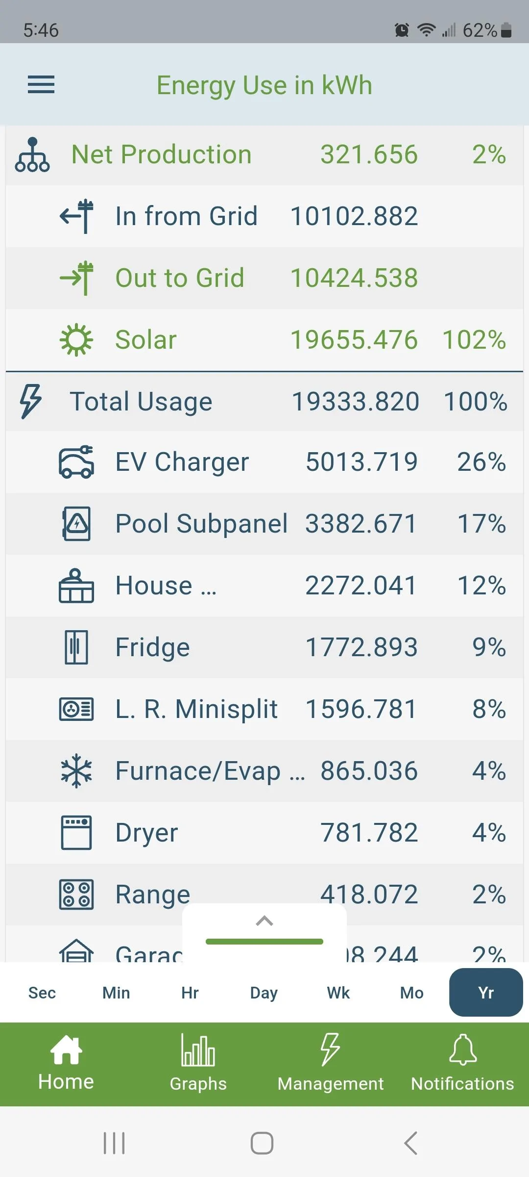

I installed an Emporia energy monitor a couple years ago, and it's been interesting to see how much things use. We have a bmw I3 that we use for as many errands as possible, so around 15k miles per year and basically only charge at home. With the energy monitor all the associated energy use is captured, including preheating and charger losses. This screen shot shows last year. In December I finished installing mini splits so this year the solar won't cover all our use. It's probably worth noting that our pool has a heat pump water heater, and we have a hot tub. Also the 'furnace' circuit is primarily the evaporative cooler, or 'swamp cooler'. Also the fridge circuit had a lot higher draw last winter because of a space heater, while during the summer the fridge uses about 70kwh per month.
Rivian R1T R1S Rivian vs Tesla vs Frigidaire?! (Average annual electricity consumption) Screenshot_20230219_174647_Emporia Energy

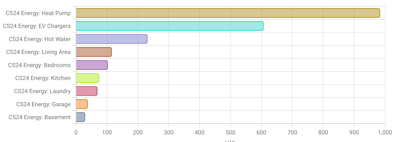

2023 R1S, 2022 Mustang Mach-E GT
My month of January results for an all electric home:
- two Mustang Mach-E's in the garage
- geothermal heat pump with resistive backup
- about breakeven with 26,000 kWh of solar production in 2022
Rivian R1T R1S Rivian vs Tesla vs Frigidaire?! (Average annual electricity consumption) 1676868665957
