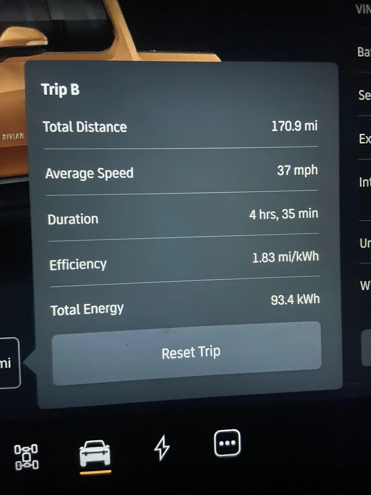

As many were aware, the previous software version (2022.47) severely miscalculated total energy to the point that it was reporting total energy usage as roughly half of what it should be. This bug seems to be fixed in 2023.2.3, which allows one to calculate how much the truck is losing to vampire drain / idle energy usage.
I reset the trip meter right after updating. After 48-hours checked the numbers:
Total Distance: 65.9 mi
Duration: 3 hr 7 min
Efficiency: 1.89 mi/kWh
Total Energy: 37.9 kWh
If I'm reading this correctly, during the ~3hrs of driving, the truck used 34.9 kWh of energy. That leaves 3 kWh of total energy usage unaccounted for during the other 45 hrs of this measurement, which equals 1.6kWh of vampire drain per every idle 24 hours.
These numbers are with gear guard enabled everywhere. High of 61F and low of 39F during this time period. I didn't charge the truck during this measurement.
Overall, these numbers are in line with my anecdotal observation of 1% daily vampire drain and similar to what others have reported. It's not that big of a deal to me or enough for me to disable gear guard, but still I hope Rivian is able to further optimize and reduce idle energy usage.
You might want to check your methodology again.
After the current update if you take distance /efficiency you get the exact kWh and not missing energy (i.e vampire drain) see 180.9/1.83 =93.4 (this is over two days and I had plenty of vampire drain)
To get vampire drain is pretty easy. Just reset a trip counter and read energy before starting truck again.
Rivian R1T R1S 2023.2.3 software fixes trip total energy enabling accurate vampire drain calculation IMG_7613
