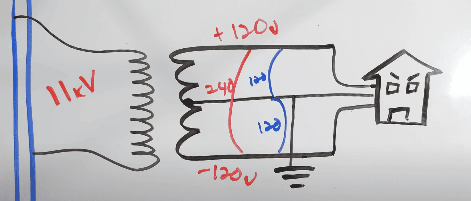

For those that don't know the US "version" of 240v is drastically different from EU, that's why there's no magical switch inside inverter.
We have two 120v phases working at 180° from each other with common neutral/ground whereas EU simply has a single phase working at 230v
US is still single phase. Transformers are just center tapped here, splitting it into equal halves.

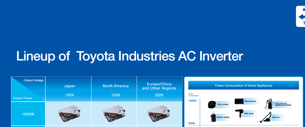

More info about the unit and other cars it's used on. Apparently there is a 220V version also...
https://openinverter.org/forum/viewtopic.php?t=2693
Very interesting he mentions in the video he claims Rivian is running 3 in parallel, and he plans to run 2 in parallel. Not only do I wonder what is needed to run them in parallel, but also I wonder where he got that info, and perhaps was Rivian originally planning to have 3 for more power?
Suppose you could stack two 120s instead of parallel, you might actually be able to do 240v. But it all depends on how they can be operated in parallel. I doubt they auto sync when the outputs are simply connected.
I wish there were some part numbers and documentation for these. If they are used in Prius, perhaps there is more info out there, better yet CAN message commands.
I think it was just some bad information about how Rivian is using them to be honest. There's only a single inverter in the Rivian.
Been looking for a datasheet from toyota on it but I haven't had much luck.
