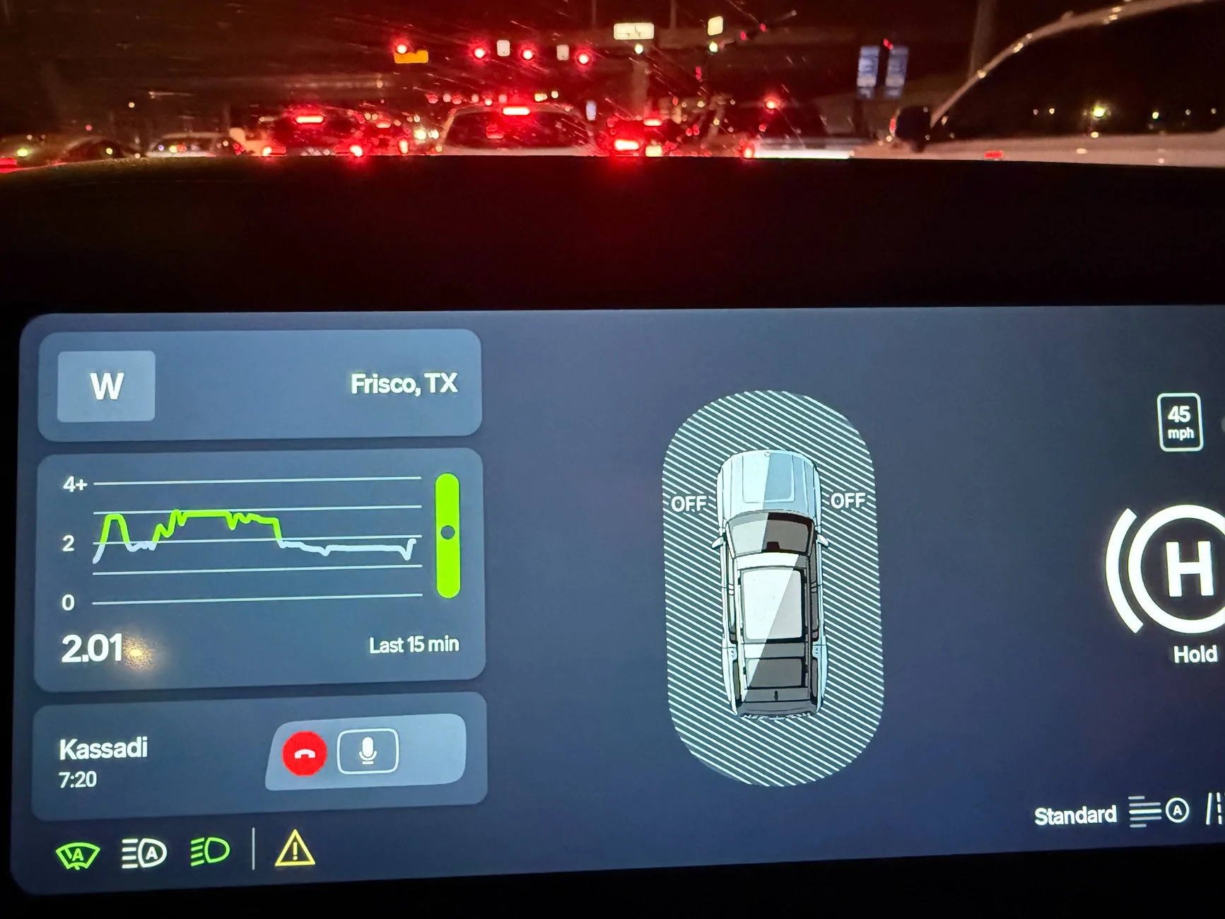

Leaving Costco tonight, a yellow triangle warning symbol appeared on display (also notice that either cameras or sensor were suddenly off). What does this mean? Haven't tried to re-boot yet, but will later tonight. Hopefully, a re-boot will clear the warning.

Did a soft re-boot, seems to have cleared the warning sensors/camera are functioning again.

Tap the notifications/alerts area on the left side of the center screen to read the specific message tied to that triangle.

I have seen this a few times when I am quick about get in, start, and roll very quickly.
Gives a warning the sensors/cameras did not boot completely. Always resets next drive.
Then I get in slower....

It usually means parking sensors are not available. It clears for the next drive. Usually happens if there are people moving around the car while it's in drive, or if I go into drive while a door is open. Sometimes, randomly too. Happened maybe 10 times in 3.5 years.

I think it happened to me in heavy rain too. Likely, If the car thinks sensors are blocked or faulty during start up, it throws this error.

Good to know , mine came on the other day . The car wash seemed to help
