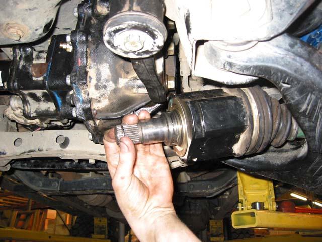

Yea pretty much every differential leak I've ever fixed was a shaft seal. Easy to do if you have a driver tool but easy mess up if you don't. They are fragile and don't like being installed crooked or to the wrong depth. If the OP is going to do it, buy two seals along with spare cir-clips for the shaft just in case one gets damaged pulling the shaft out. Find someone who has done it before since there's no service center. The cost of the seal is nothing compared to the labor. No need to remove the motor though. It's a custom looking seal from the pic I posted. You'll need to contact rivian for that part.

My business partner was just in Costa Rica. What a shame we could have delivered it for you. If you get it ordered but they won't send it to La Pura Vida I can help get it to you somehow or give you a USA address and then forward. Maybe call them if you don't have a guide assigned. Service people seem really friendly.
One thing to check also is that the axle shaft hasn't come unclipped and slid out slightly. If that is the case, the seal may not be riding on the mating surface entirely and leaking. Here's the best picture I can find off my Toyota front end. The cir-clip goes where my thumb is and expands to hold the axle in. The seal surface is at my pinky finger. Obviously the rivian is a little different.
