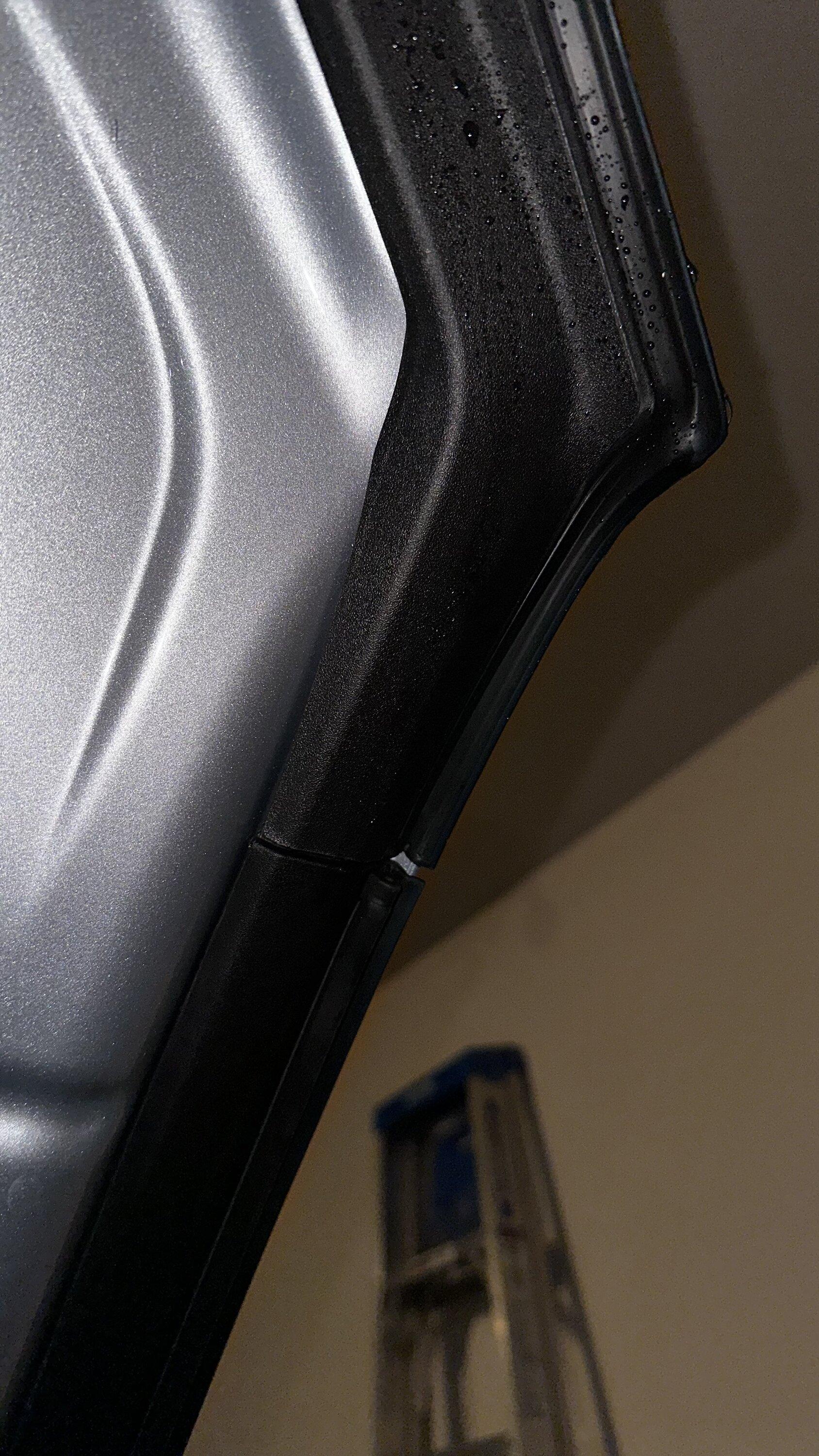

They replaced the entire hood? How'd the paint match? I just put in a ticket to have it "fixed" for a third time now. It's gotten a little better but I'm but happy with the depression still.
Yes, they painted the entire hood and it is a spot-on exact match. I'll need to get Quartz applied to the new hood, but I want to let that new paint cure a bit longer.

Can you provide pics of the updated seal? My hood doesn't deform but it definitely flutters at highways speeds.
Yes, I can get pictures this evening.
OK, here are the pictures of the new trim. It appears that the small sections of plastic that one could rotate with their hands at the front corners of the hood are now replaced with a continuous trim that prevents air from getting under the hood.
Rivian R1T R1S Wind depresses hood IMG_2746
I don’t have pictures of the original trim, but I know that i used to be able to rotate sections of the trim that were about 4” long at these corners previously. I’ve seen pics of that trim on the forums, but I couldn’t locate it.

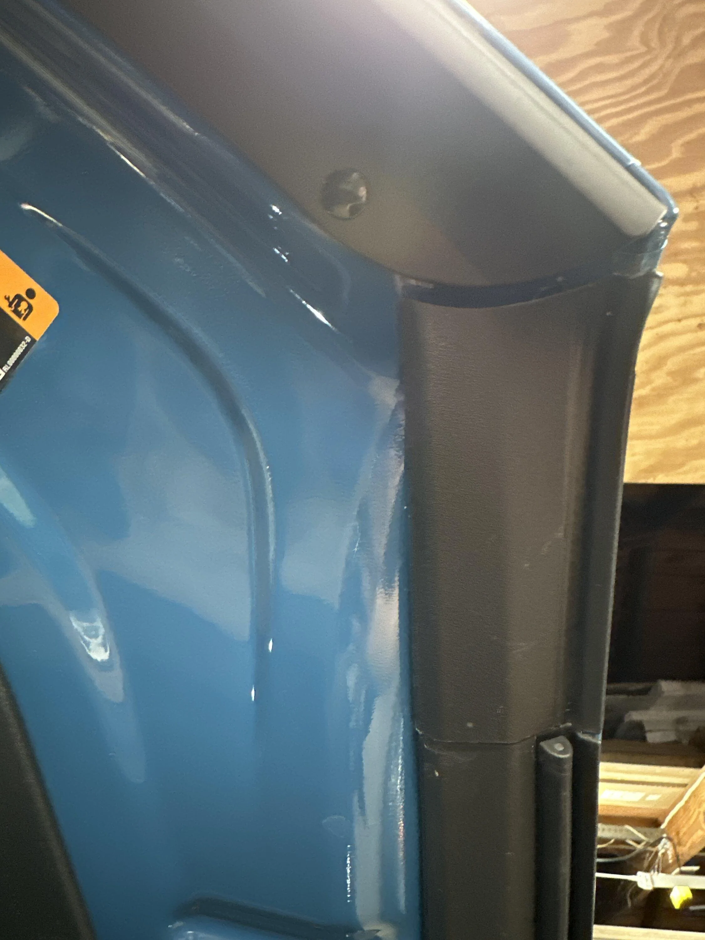

Here is the original on mine
