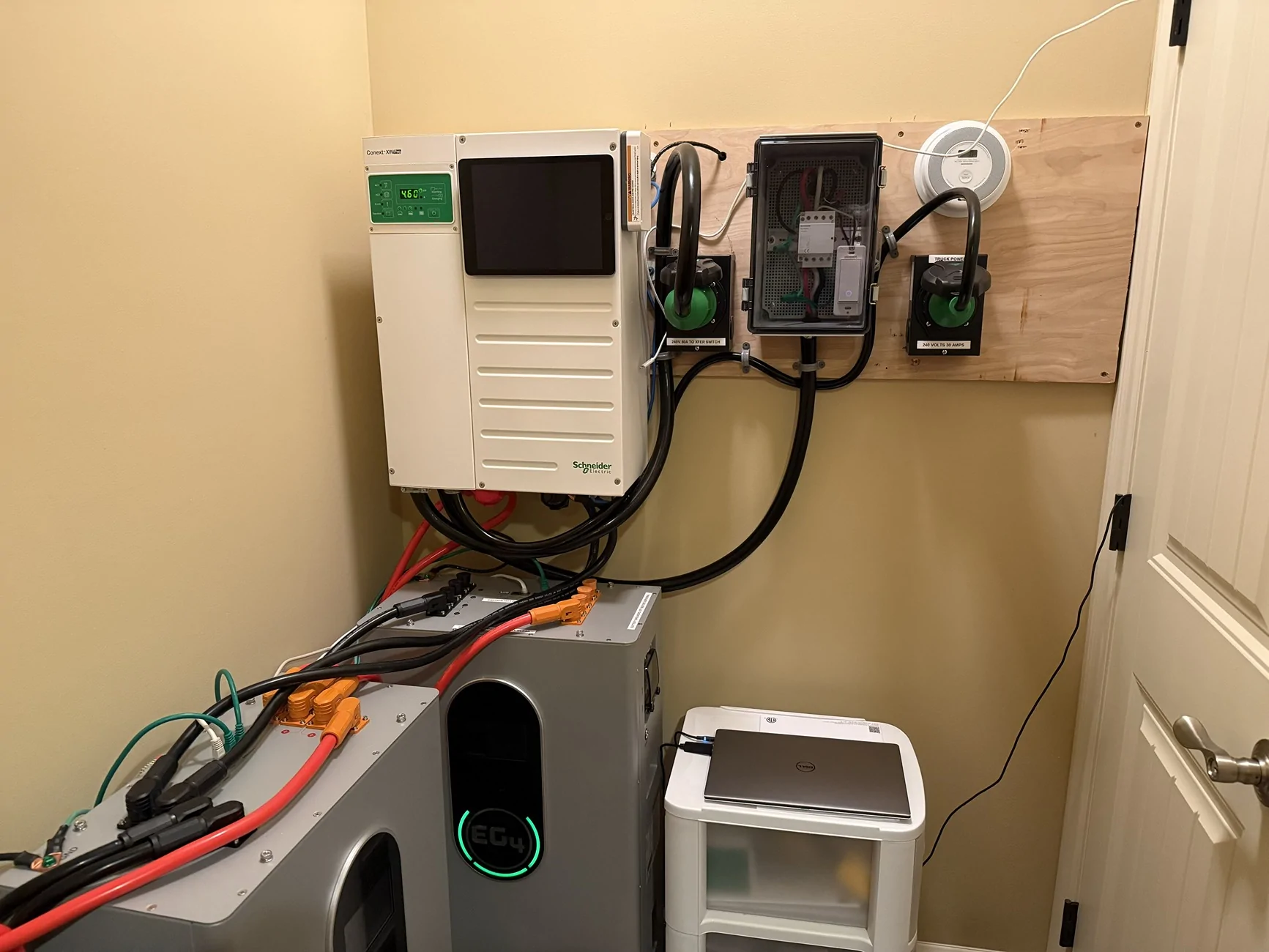

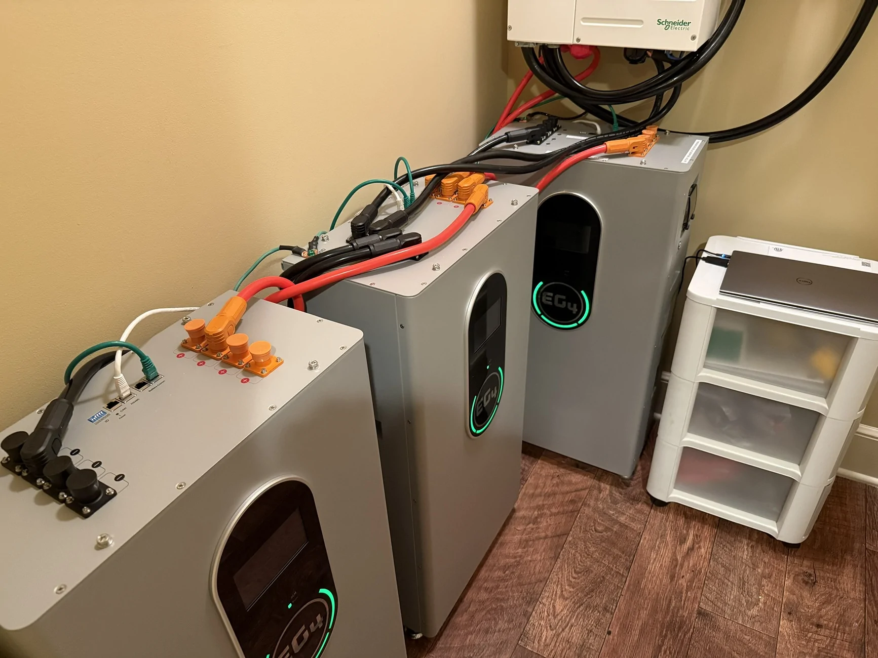

That 80 cents per kWh is insane. If you intend to keep the house long term might invest in an inverter and batteries. We power our house every day from 6 am to midnight with battery power. Can even run our 5-ton AC since it's inverter/variable. The batteries charge from midnight to 6am for .02 per kWh most of the year and for .03 per kWh in the summer.
We save about 2k per year doing this and the ROI is 4 years. Was able to get the 30% tax credit which is gone now thanks to the orange douche.
