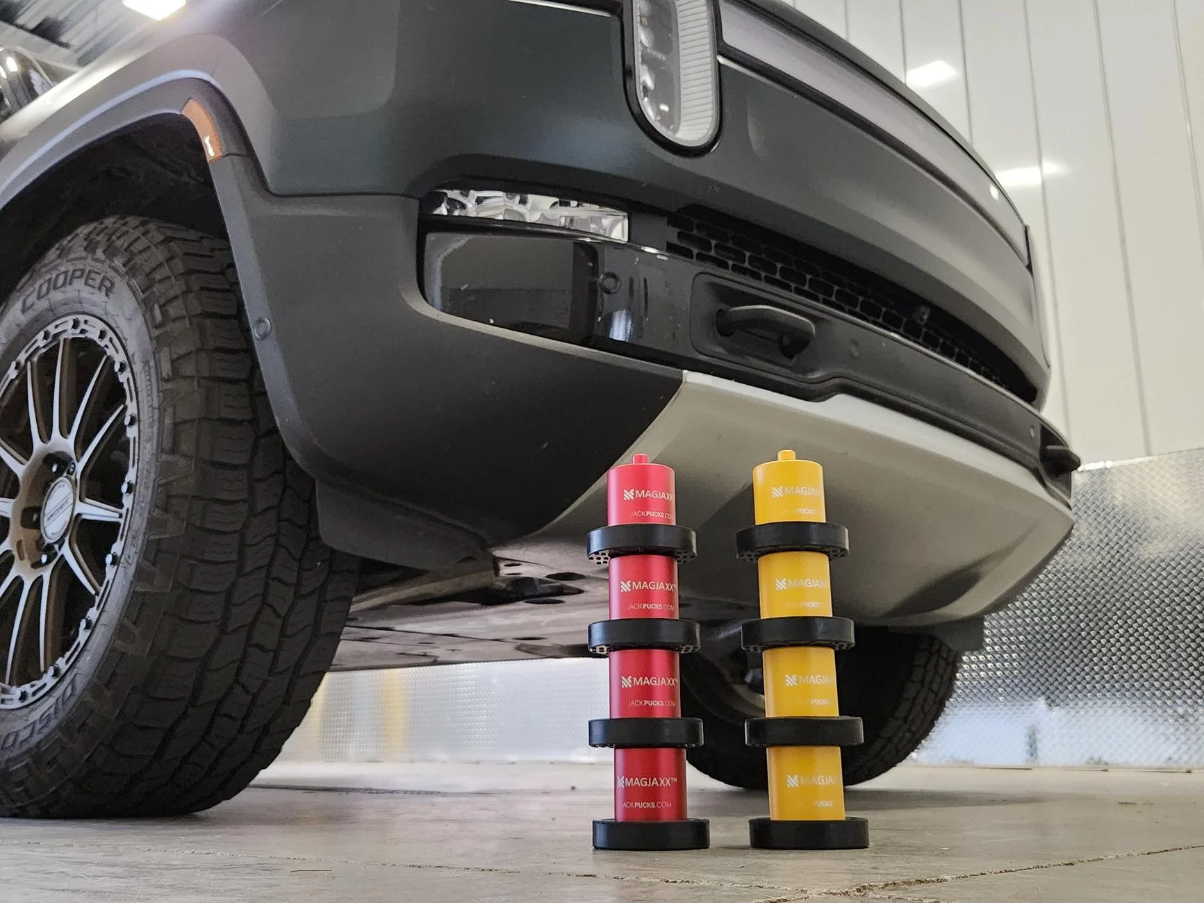

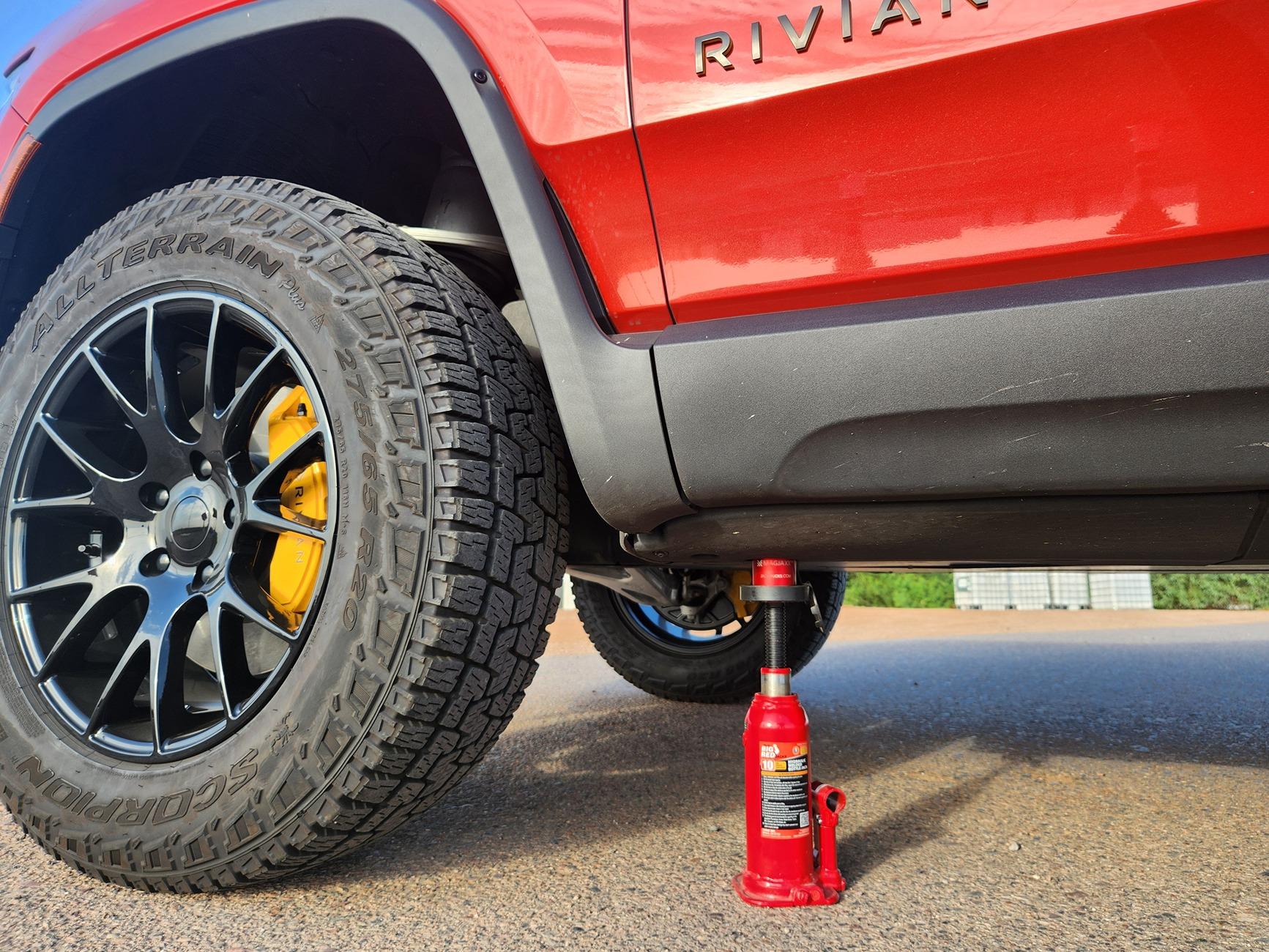

Welcome to Rivan Life and the forums. Both are an adventure. There are some very knowledgable guys/gals here,. Thanks for those that recommended our magnetic jack pucks, we do appreciate it very much!
As a site sponsor and owner of an R1T and R1S, we are all in on the Rivian experience. I designed the magnetic jack puck back in 2022 for myself, and then built them for the Rivian community and the service industry. With thousands shipped, it is much to do with our Rivian Forums community, so thanks again!

Tire Change Mode primarily eliminates the vehicle from adjusting suspension height when it's initiated. Why is this important? If you have a floor jack on one side of the vehicle and begin to lift it, then the vehicle will try to make adjustments in the suspension to level out the vehicle. This is an obvious no-no, when servicing tires or wheels.
On another note, lifting your Rivian for tire servicing via the suspension is an option, but it not the primary method, which is via the four ports Rivian designed for this purpose.
