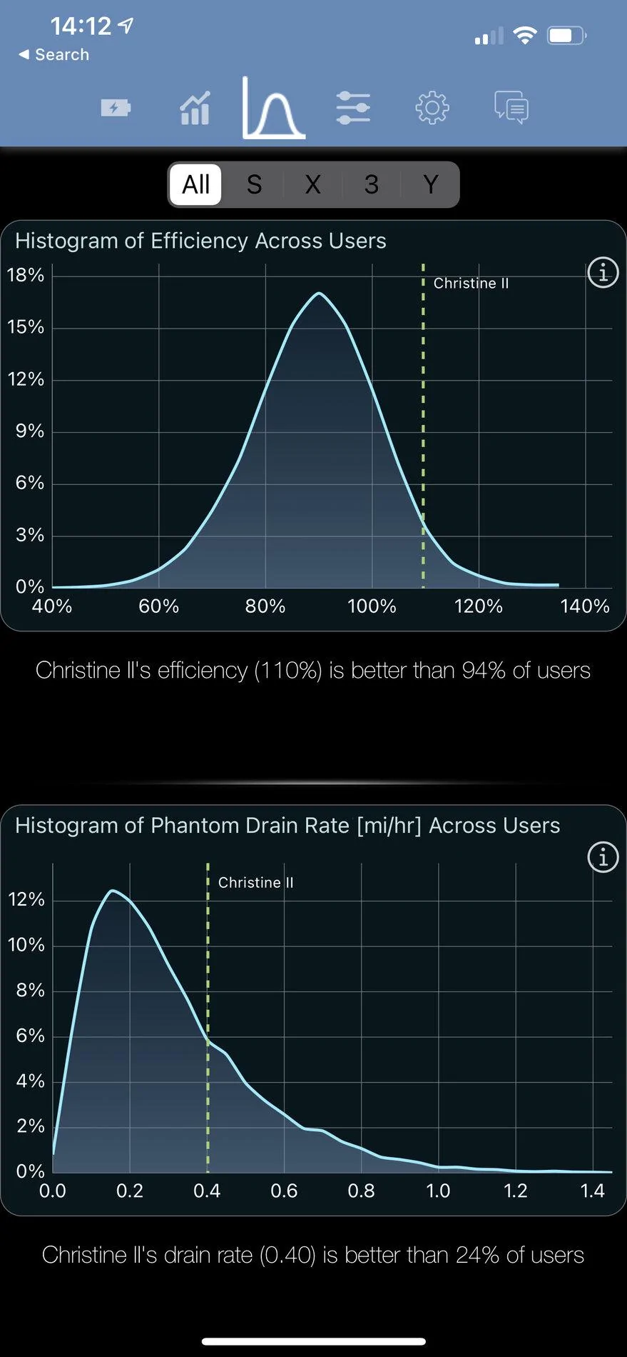

I think everyone appreciates that actual range is dependent on many variables and that, therefore, no single number can adequately describe what you will actually experience when driving. Thus "efficiency" (ratio of realized to rated range) is a random variable and indeed lookubg at data from he (Tesla) fleet confirms this:
Rivian R1T R1S What will be the EPA rating for the 135KWh R1T? IMG_1630
As the histogram shows a fair number of drivers average consumption that is better than the rated consumption. For them the rated value is "unrealistic" on the conservative side. For the majority, however, it is "unrealistic" on the optomistic side.
I think what you're wanting is a realistic highway number, like "flat highway, no wind, 75 mph", or something like that, right?
So let's change the EPA's method such that the consumption is scaled to the mode of the histogram. The dispersion would stlll be there.

I have previously suggested to Rivian that they share a more real world example of range such as what you described. The EPA range, for what it's worth, can still be the official metric but additional data points would be welcomed.
So let's do that. The dispersion will still be there.
What we are going to have to do is drive the vehicles and collect data both as individuals and collectively. Presumably people will develop apps that do what Stats does for the Teslas.
