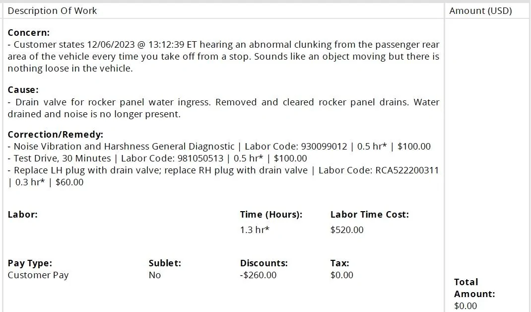

EDIT: Added service invoice.
This is an old thread, but I have new info from Rivian:
There are also plugs in the rocker panels!
I was hearing a thud, or bass drum-type sound, every time during acceleration. Service diagnosed it and wrote back with this:
“So we found there was water ingress in the underside rocker panels. We had to replace the drain plugs and water was cleared. Noise has gone away.”
I asked if there was anything I could check, myself, of maybe even do to purge water if I ever hear that sound, again. They said:
“For now, we made some modifications to the drain plugs so that it allows more water to exit rather than accumulate. The water should not build up again to that point.”
I asked if the truck could still ford water without getting more water in those cavities. They said:
“Water will ingress regardless. Only now, it will not stay inside in excess.”
That’s not very encouraging. I wanted the drain plugs to work one-way, as designed, and keep water out. I guess I’ll just have to find them and check for water once in awhile.
If your doors are dry, but you still have a sound, check your rocker panels. I don’t know where the plugs are, but I’ll find them someday.
