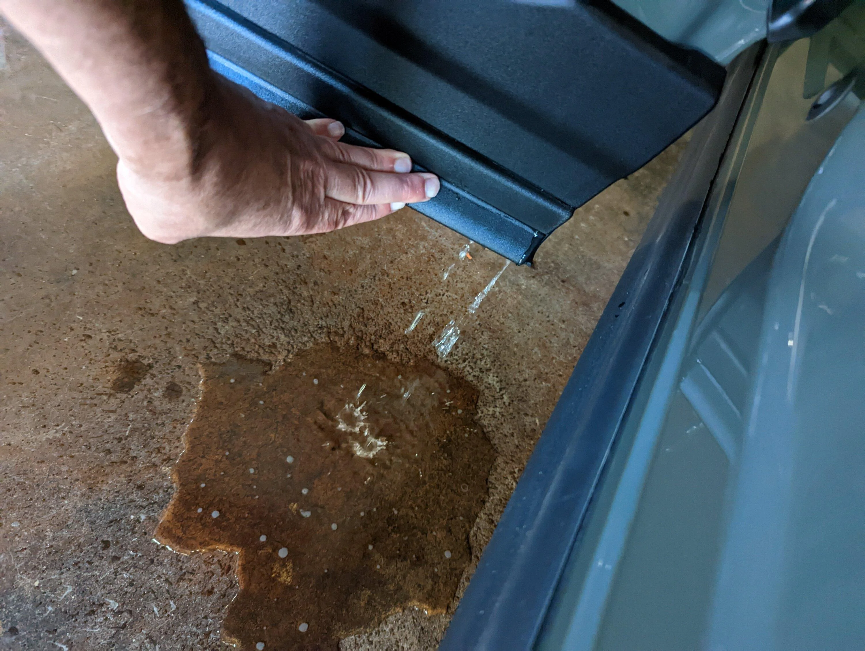

Push the lower facia out , i.e. towards the outside and see if water starts coming out. Mine retains water like my < >I better not go there :)

Tried this - nothing came out, on both the passenger-side front and rear door. Will keep investigating.

Yes, posted in a couple of other threads. Mobile service tech fixed it when he came for the recall. There is a little one way rubber plug that not infrequently gets applied a little too tight in assembly. The water is in a space where it is supposed to collect as it runs down the door frame. The plug was keeping it from draining. He checked the plug on the driver door too, and it had water marks where you could tell it was draining. The one from the passenger door looked brand new. Haven't had any water collecting since. I was relieved it was a space water was supposed to get into. It just wasn't getting out as designed.
