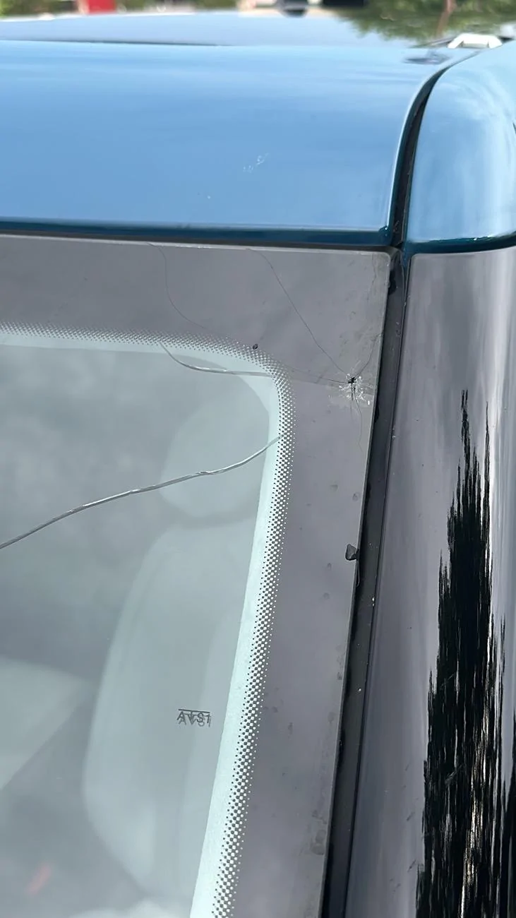

Just replaced my windshield in April, took a hit today and have three long cracks from the impact location. Its on the passenger side, so I will ignore it for now. We need an aftermarket brand with better glass, way to fragile.

So had an interstate incident. Trailer truck kindly sprayed me with gravel. Have a severe impact fracture that will require front windshield replacement. Thanks.
