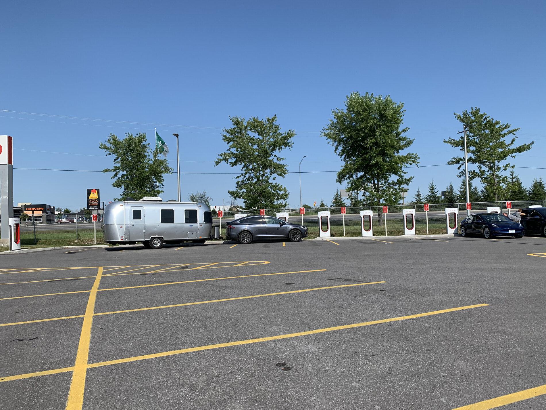

Yes, many times. I've done both. Driving in sideways and blocking stalls (only at superchargers that aren't busy and I standby to move it if required, see photo) as well as unhitching and then charging. Latter is a bit more involved of course but I'm now pretty fast at the manoeuvre. ;-)
Tesla also has a few pull in stations. For instance, the one in Berlin, Vermont. Look it up on Google you'll see what I mean. Not enough of those of course but overall, I manage.
More importantly, on short distance weekend getaways, I charge at the camp site. You actually save the time and pain of driving through a gas station with a trailer in tow.
