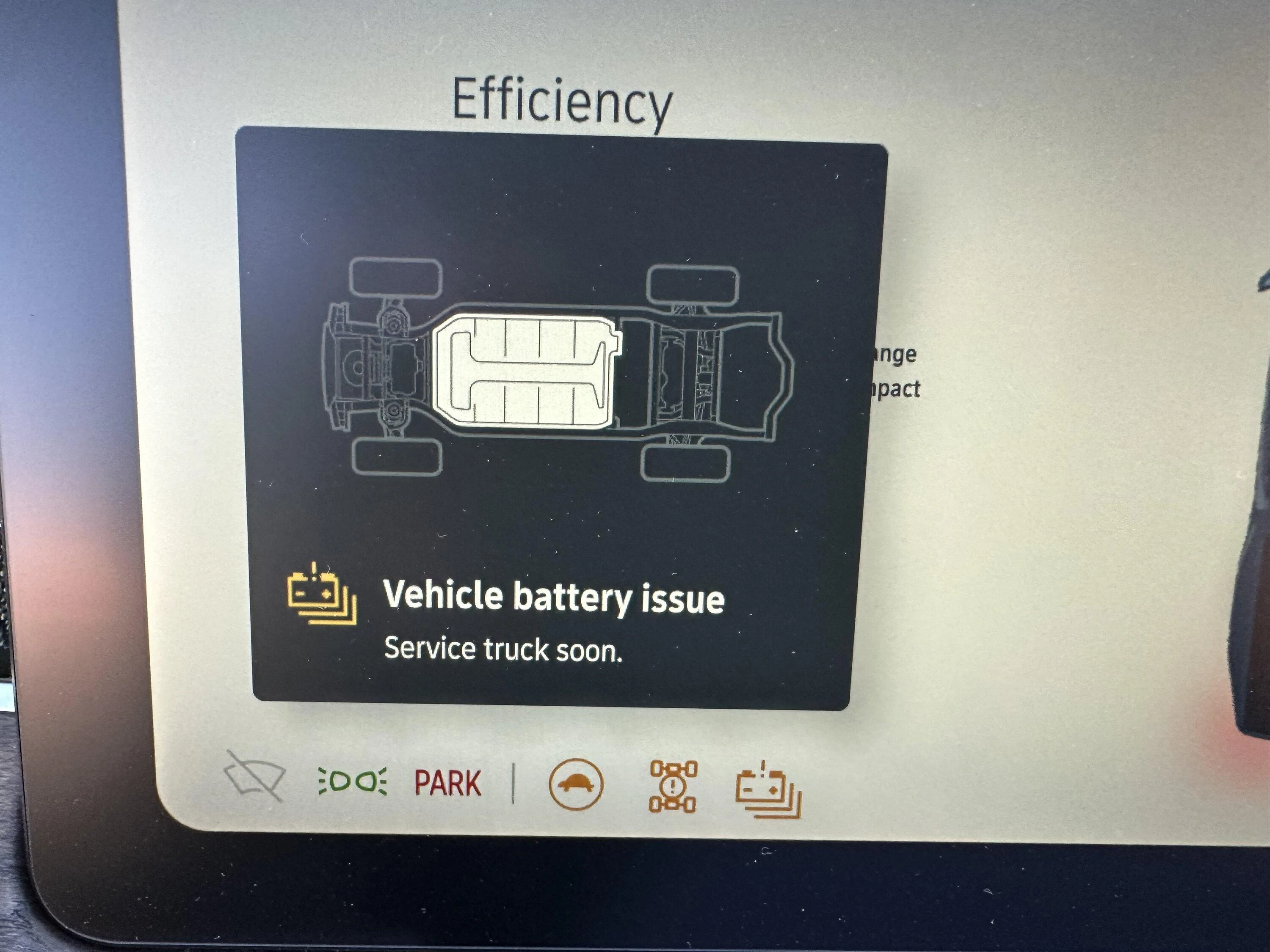

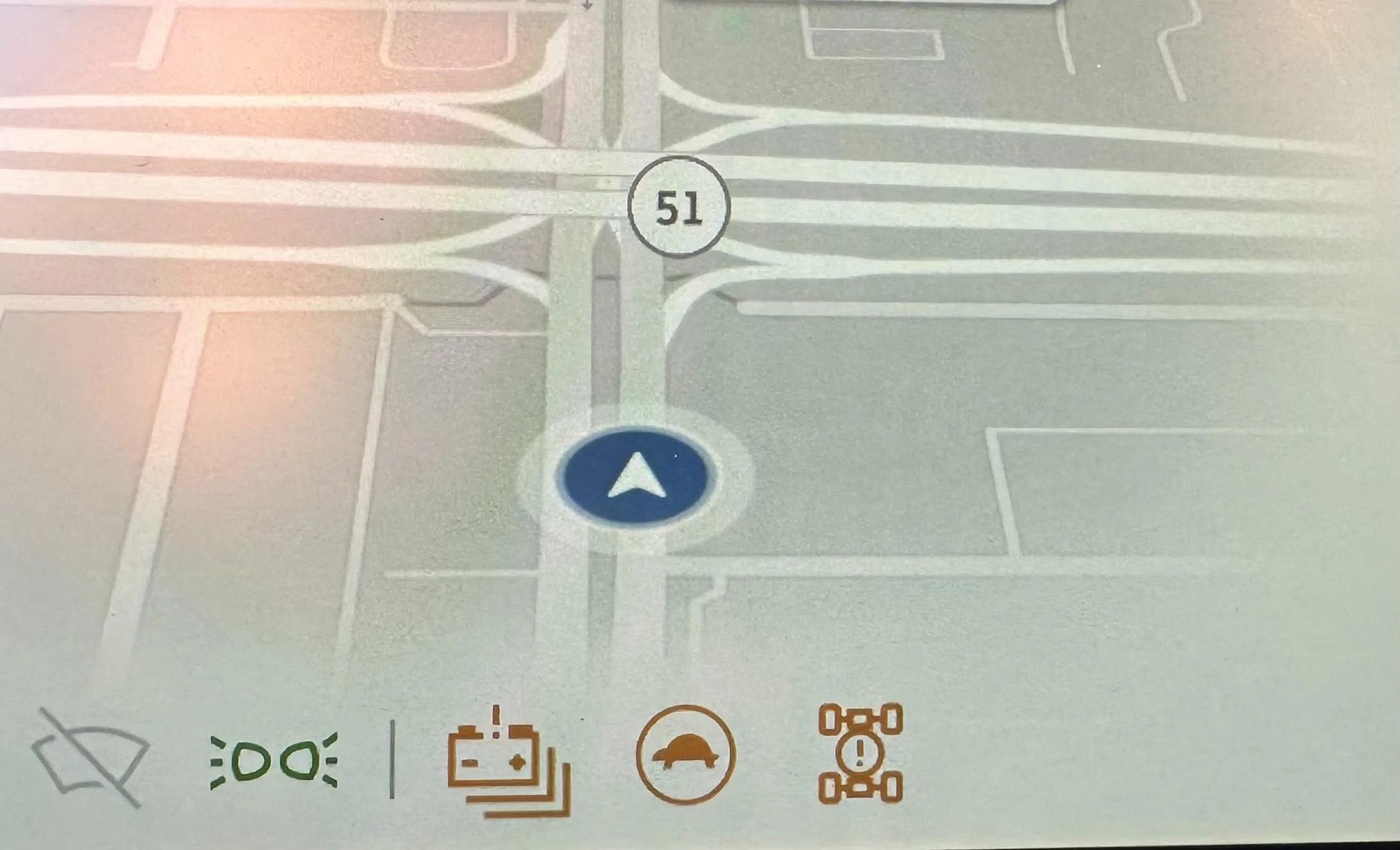

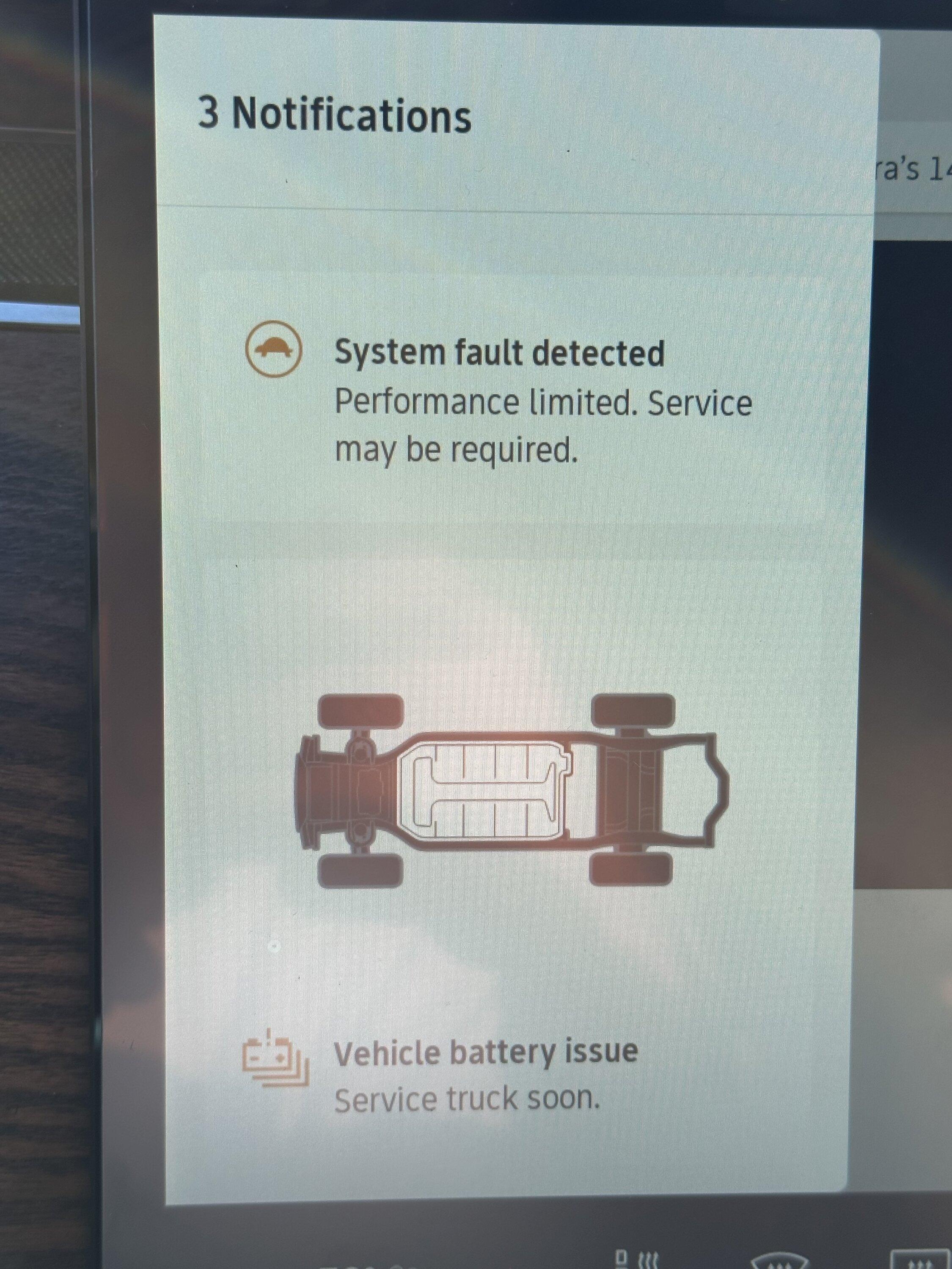

Well,
This is disappointing. I’ve been out of town for the past 6 days and my R1T has not been driven since I left - until this morning when my wife drove it to a work conference.
On her way home, she sees the following error messages:
“System Fault Detected. Performance Limited. Service May Be Required”
“Vehicle Battery Issue. Service Truck Soon.”
Latest update was installed yesterday. Did a hard reset at Rivian Service’s suggestion. Once the brake pedal is depressed, error message comes back up. Rivian is kicking it up to diagnostics and said they’d get back to me.
I have an upcoming appointment on 11/1 for 9-10 mostly minor issues, but the other major one is that my car doesn’t Level 3 DCFC.
VIN 98XX, built 7/2022, delivered 9/12/2022, current mileage 708.
I’m very disappointed, but am confident it’ll all get fixed.
Rivian said not to drive the vehicle in the meantime. They offered a loaner or rental, but I declined since I’m out of town but requested one for my service appointment on 11/1. Also told them I’d do a short test drive 10/31 to see if it can make it up to the Service Center on 11/1.
Will post some updates once I have them. Very bummed. Love the truck.

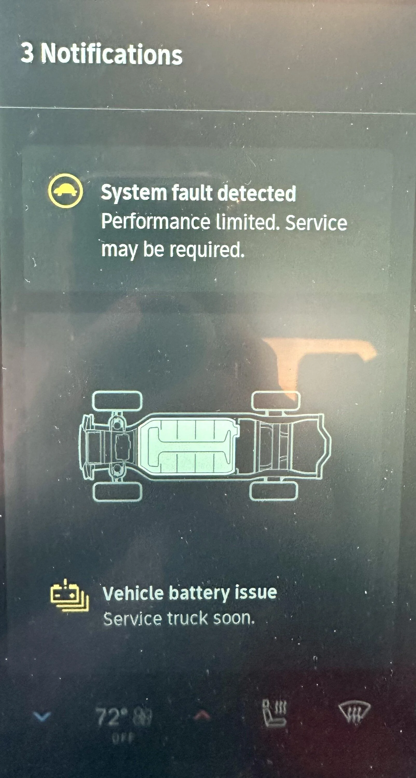

I got a very similar message except it said that my vehicle was overheated , this started yesterday after the update, the drive mode went from all purpose to sport and would not change. I parked the car went into the store. I started driving after about 1/2 hour and the truck was fine then in about two miles the same error message came on and it went into sport mode again. This morning I took the same route and no message the truck drove fine. I going to call Rivian now
