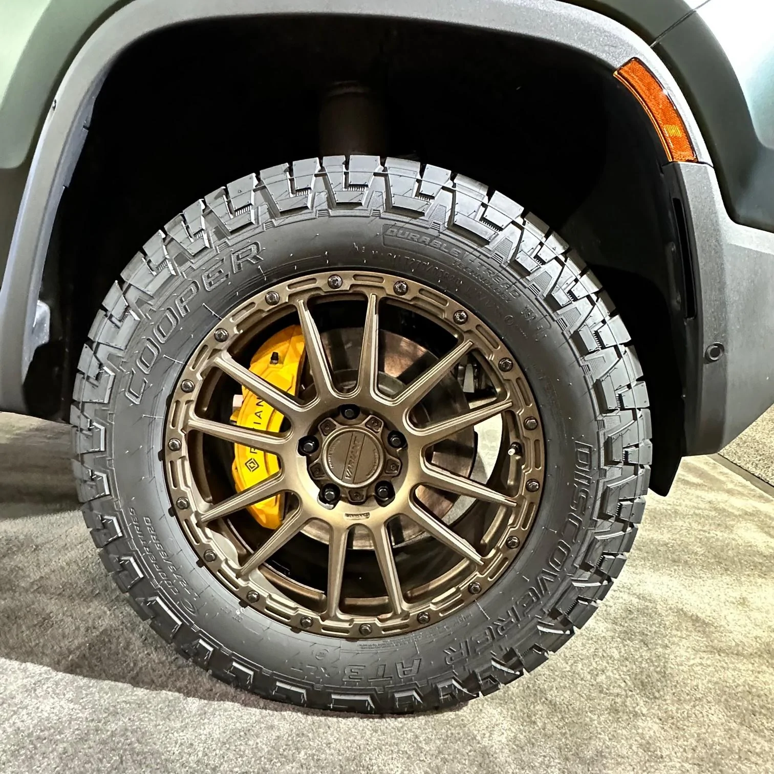

This is exactly what they told me! Road Force balancing by the SC helped a bit....BUT when I changed over to a more aggressive Cooper Discover AT3 XLT AT tire, my vibration went 95% away. I'm 4000 miles in and still about as smooth as you can get......no Road Force, just regular balance.......
Rivian R1T R1S Steering Wheel Shake at Highway Speeds IMG_0266
