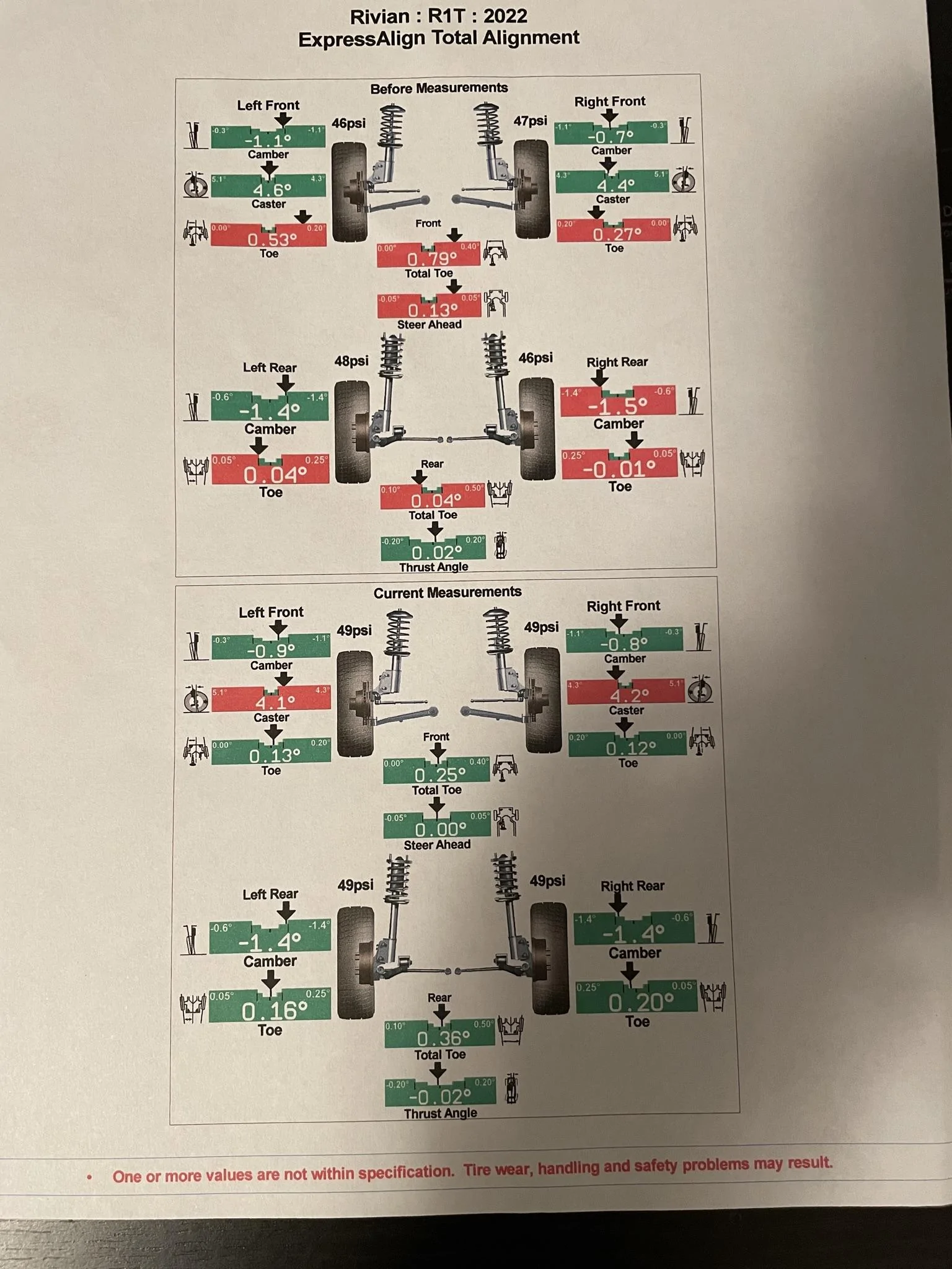

I had the same problem right at delivery. My steering wheel was off center to the left a couple of degrees and would drift to the right. When driving on the freeway it would track better but still slight drift to the right. Took it in for service appt today and was surprised my readings were that much off. No wonder it was going to the right. Vehicle will pull to the most positive camber and negative caster. Front and rear toe was off pretty bad too.
All good now? Mine has same issue and goes to sc on 16th
Yes it’s much better maybe .5 degree off center on the freeway but tracks straight. I could adjust the tie rods equal and opposite amounts to center the steering wheel perfectly but would probably have to recalibrate the steering angle sensor. Done that plenty of times when I did wheel alignments
