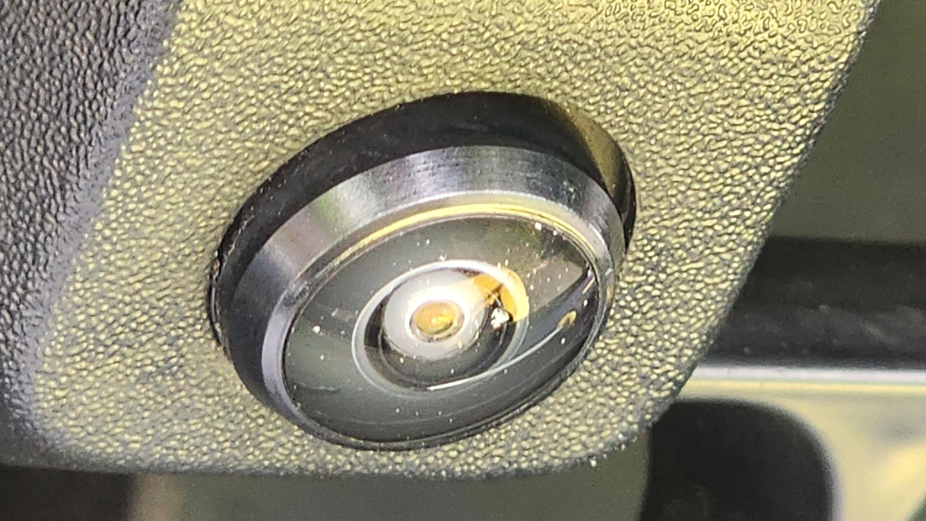

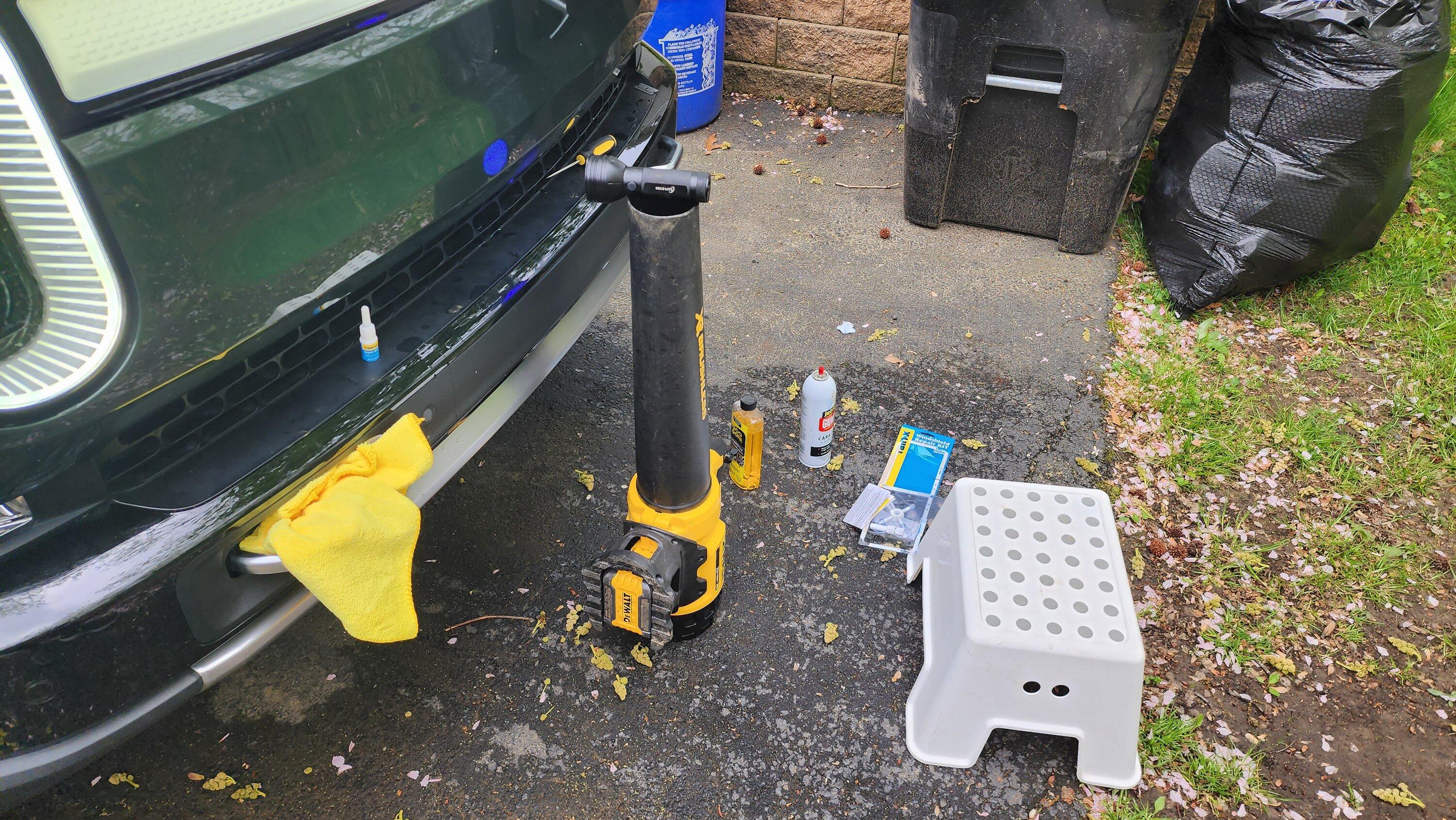

So quick update. Definitely protect your cameras, the small specs isn't dust, it's all tiny chips. This will become a big issue once there are more trucks on the roads
Windshield repair kit isn't working too well so far because it requires pressure to drive resin into the crack/chip and can't do that on tiny lens. Right now trying to just put a layer of resin and then polish it out.
Also the camera appears to be a part of the entire grille with fog lights and everything, which is probably why it cost so much to replace. Disregard, it's separate assembly.
Rivian R1T R1S Rock chip on front bumper camera 20230427_133351
Rivian R1T R1S Rock chip on front bumper camera 20230427_135040

yeah, I just went to poke around my front camera. The plastic is for sure part of the grill. The camera itself does seem to be mounted, there's a tiny bit of movement if I push it around, and I can feel some foam behind it (presumably wrapping the cables to the camera). Need a mini version of this.
Rivian R1T R1S Rock chip on front bumper camera 1682621774893

It's been raining for past few days so nothing new. The RainX windshield thing didn't work or made it even worse like someone said.
