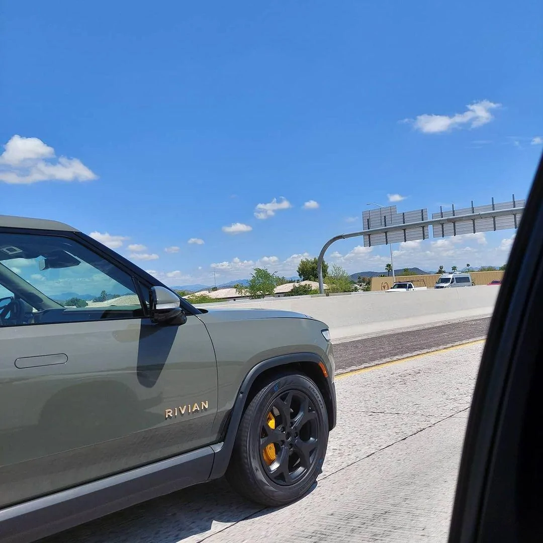

Would really be great if this Reddit poster could report on their experience with these 20" AS tires, and exactly which tire it is? Hopefully better range than the Pirelli OEM 20"AT tire.
