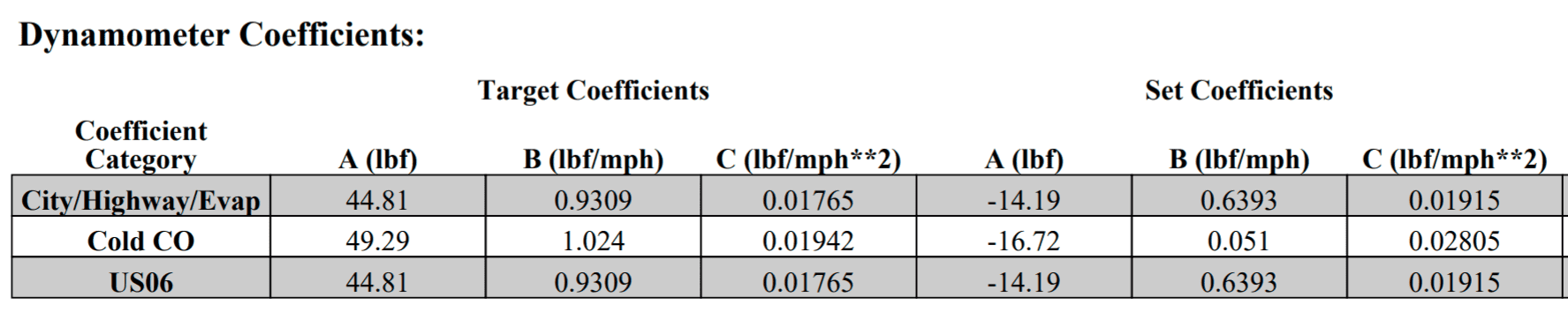

Wind resistance is factored in when configuring the dyno settings:
@DucRider Curious if you saw a drag coefficient value for the R1T or R1S in this data you found? I did not see any and was curious how they would determine these number or if they are simple calculations of frontal area.
I've seen numbers for the Jeep GC anywhere from .37 to .39 and was curious how the Rivian compared to these.
No drag coefficient is listed.
Manufacturer supplies these numbers, but not the calculations behind them. IMHO, this is an area that Tesla pushes a bit more aggressively. I haven't paid to download the full test specs/procedures so I can only glean info from what the various manufacturers have provided in their applications (not all use the same format or provide the same info - Tesla includes only the UDDS and hwy test data and not the other parts of the 5-cycle test like the Cold Weather portion)
The coastdown test supplies part of the calculation numbers. Tesla specifies placing their vehicles in a special "Coastdown mode" that does at least a few things that would yield a better result than under normal usage. But for the most part, how manufacturers arrive at the settings for the dyno is hidden from the public.
So, the ~30% reduction is for things like hvac, lighting, hills, etc?
In one of the videos today, it was mentioned 0.3... not sure of this is official though
