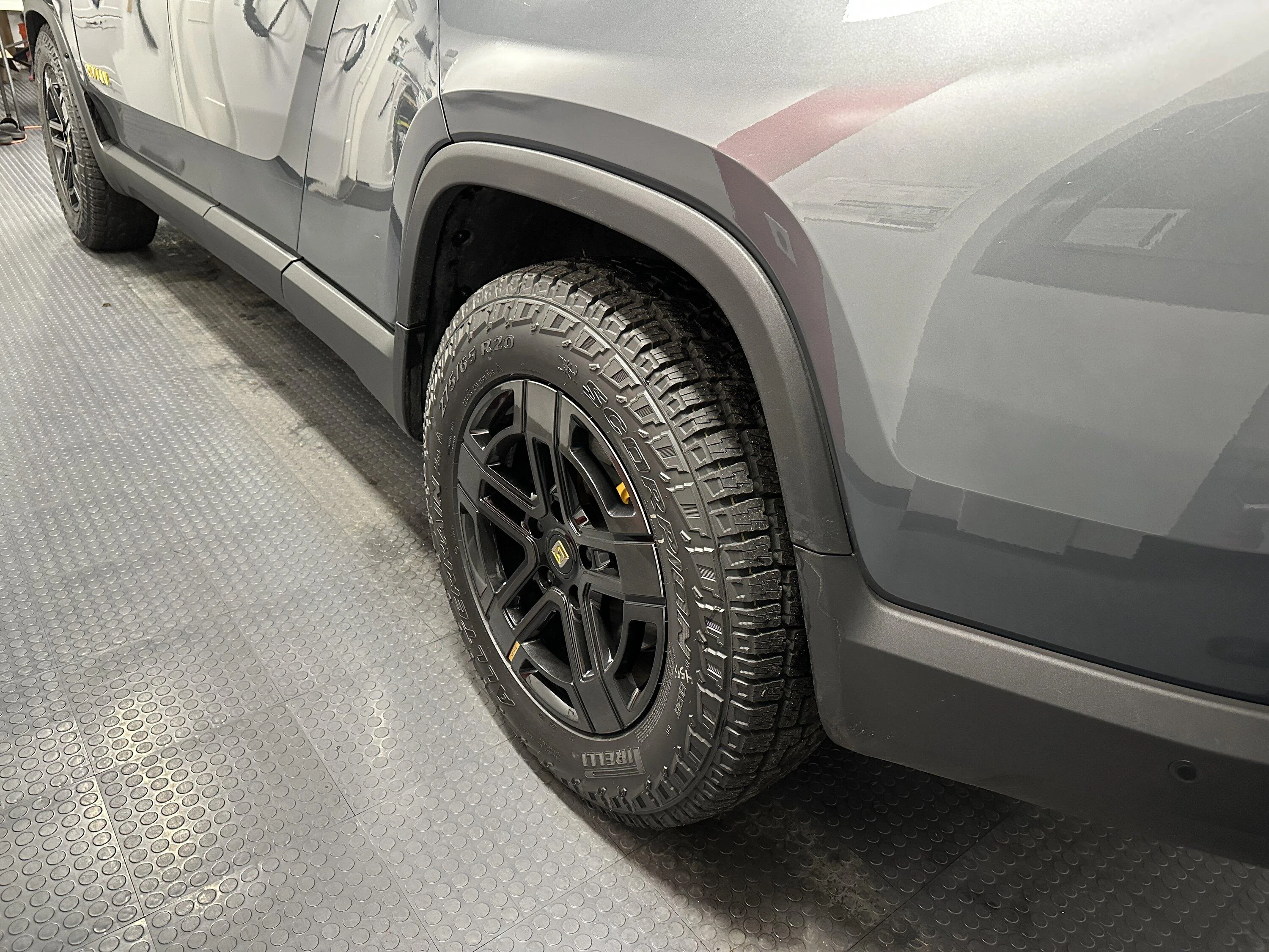

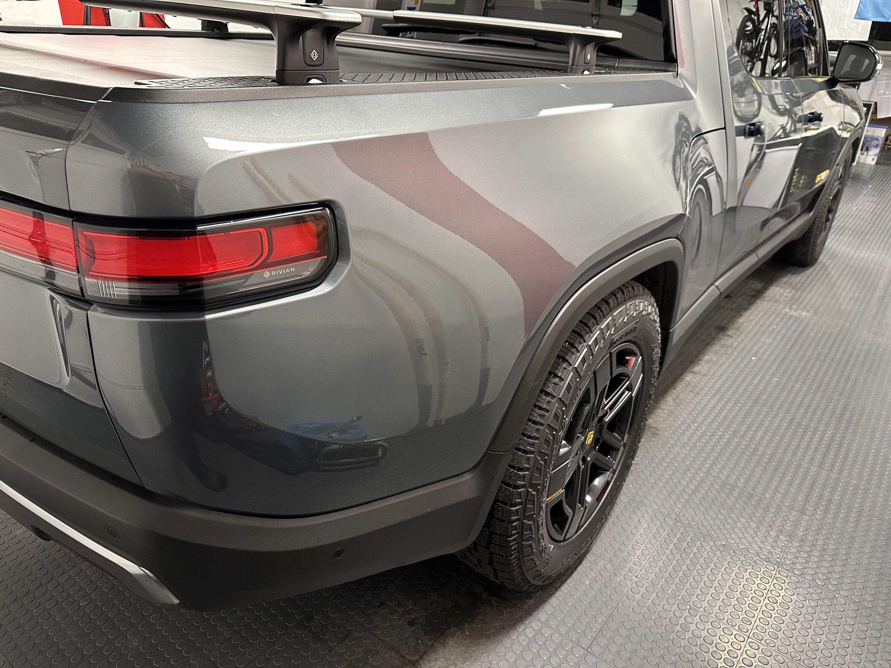

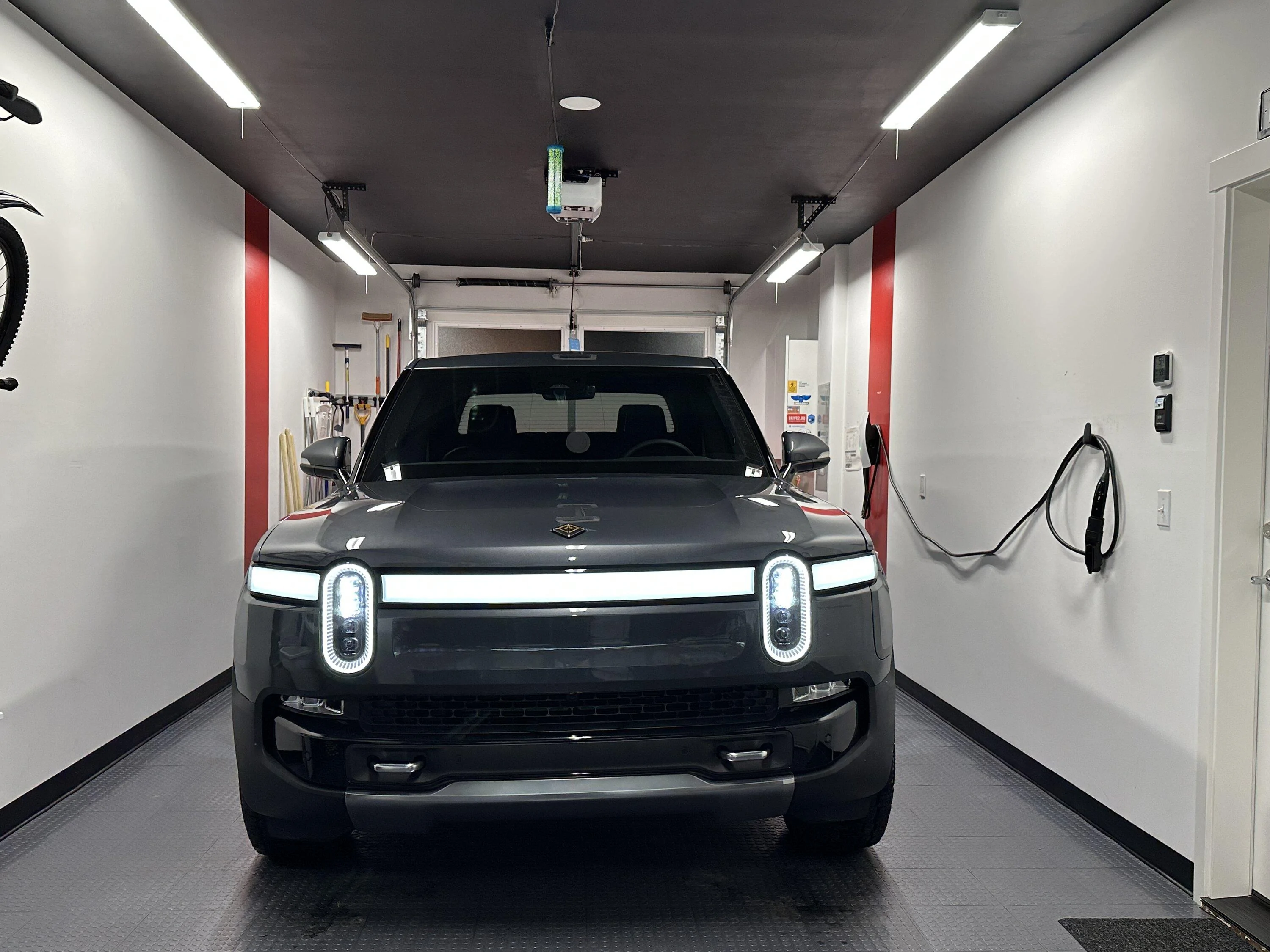

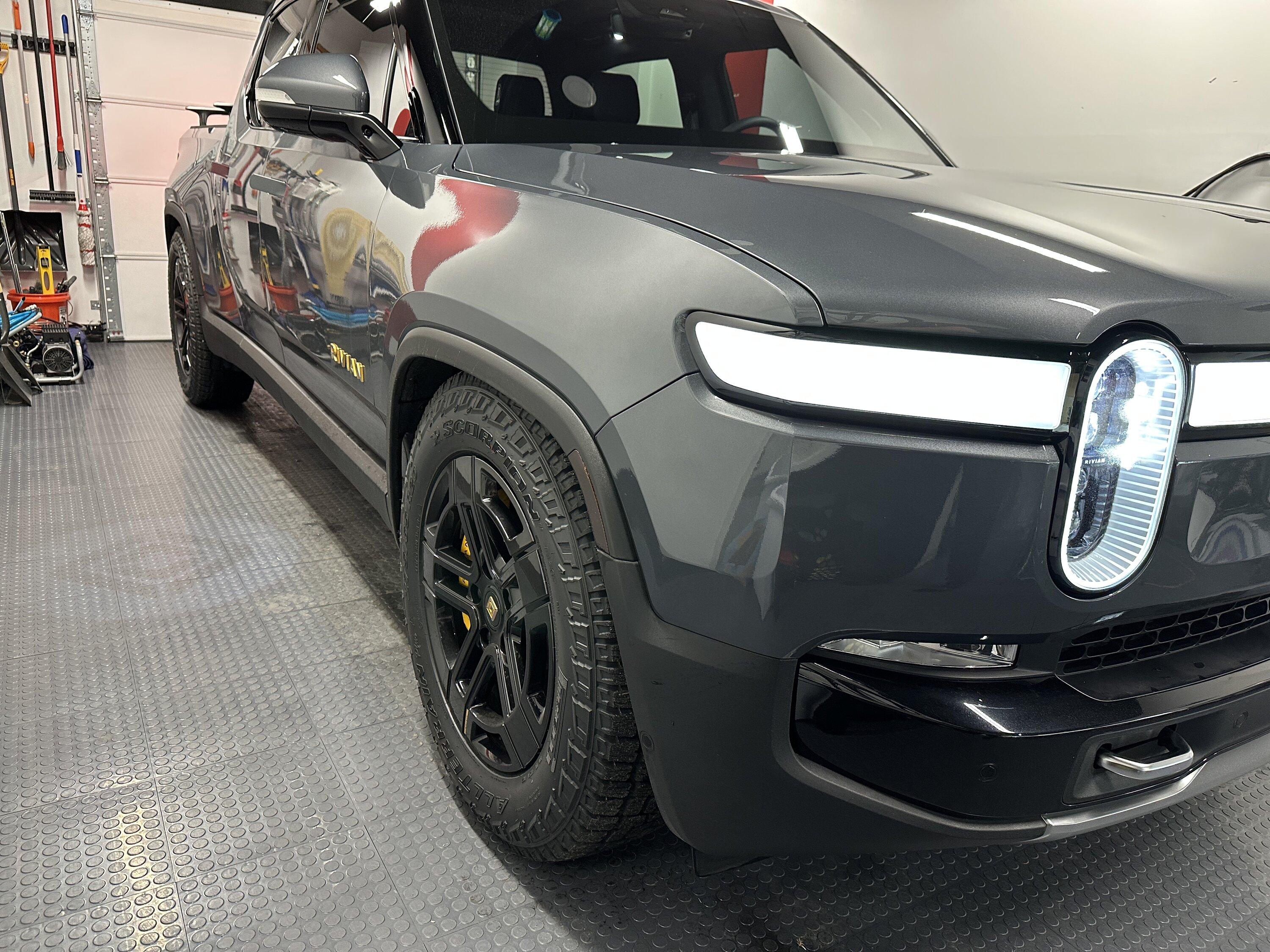

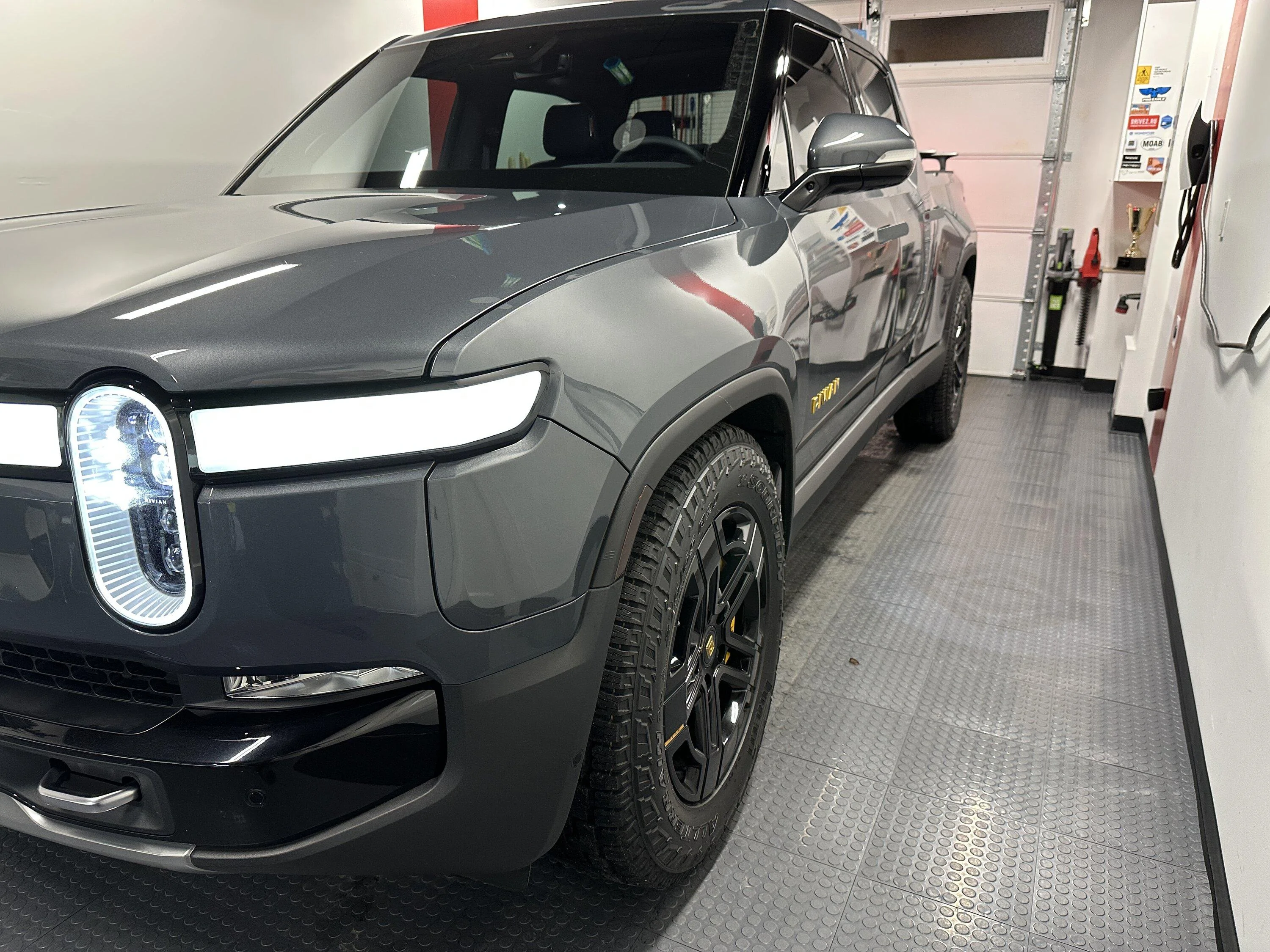

When I got back home, parked inside the garage, the car kneeled as always but I realized the front right corner is dropped more than other corners.
I got outside and saw this:

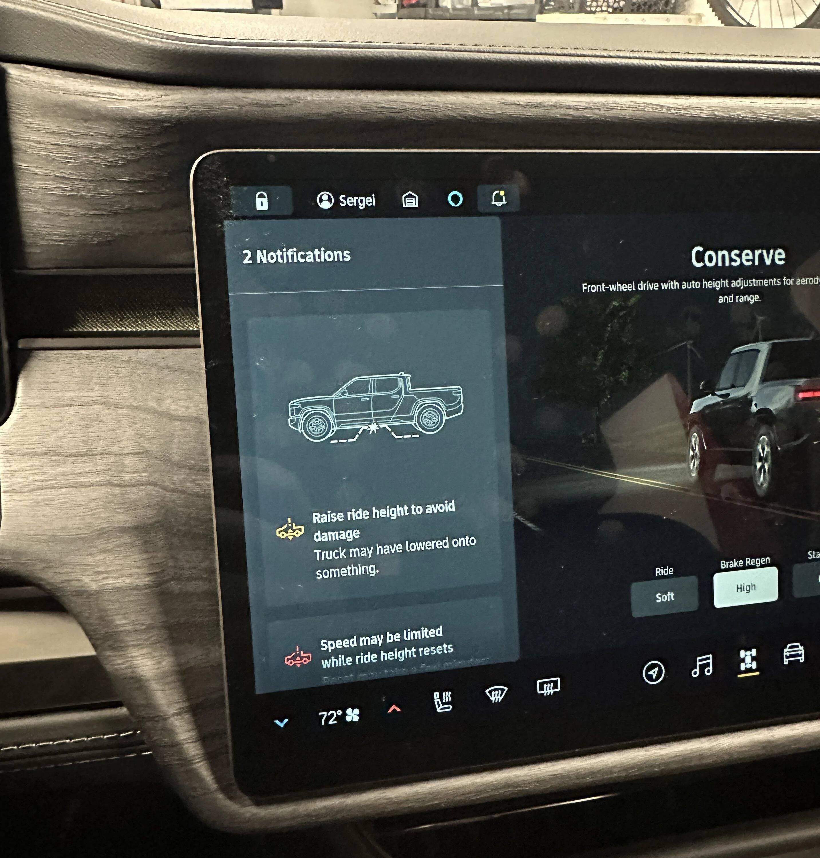

I decided to reboot the vehicle and completed it a couple of times, and the issue was not fixed.
Then I decided to use Leveling function in camping mode. I launched it and the vehicle was telling me that leveling is in process, but the car was not moving. After 10 minutes it was still going. I stopped it and clicked "reset suspension settings" and the car gave me the error that speed may be limited during the suspension settings reset.
I was in the car for about 10 minutes and the car still was trying to reset settings. I went on the drive and drove about 4 miles, but resetting was still in progress.
Parked in a parking lot and rebooted the car again. It has cleared the "resetting suspension settings" task, but the error that says the car will not drive above 20mph has not cleared. However, the car is able to drive over 20mph.
I raised the car to the highest settings and still was able to see that the truck is not leveled.
The FR was the lover point.
The FL was higher than FR.
The rear end was even higher than the FL side, but RR and RL corners had different heights.

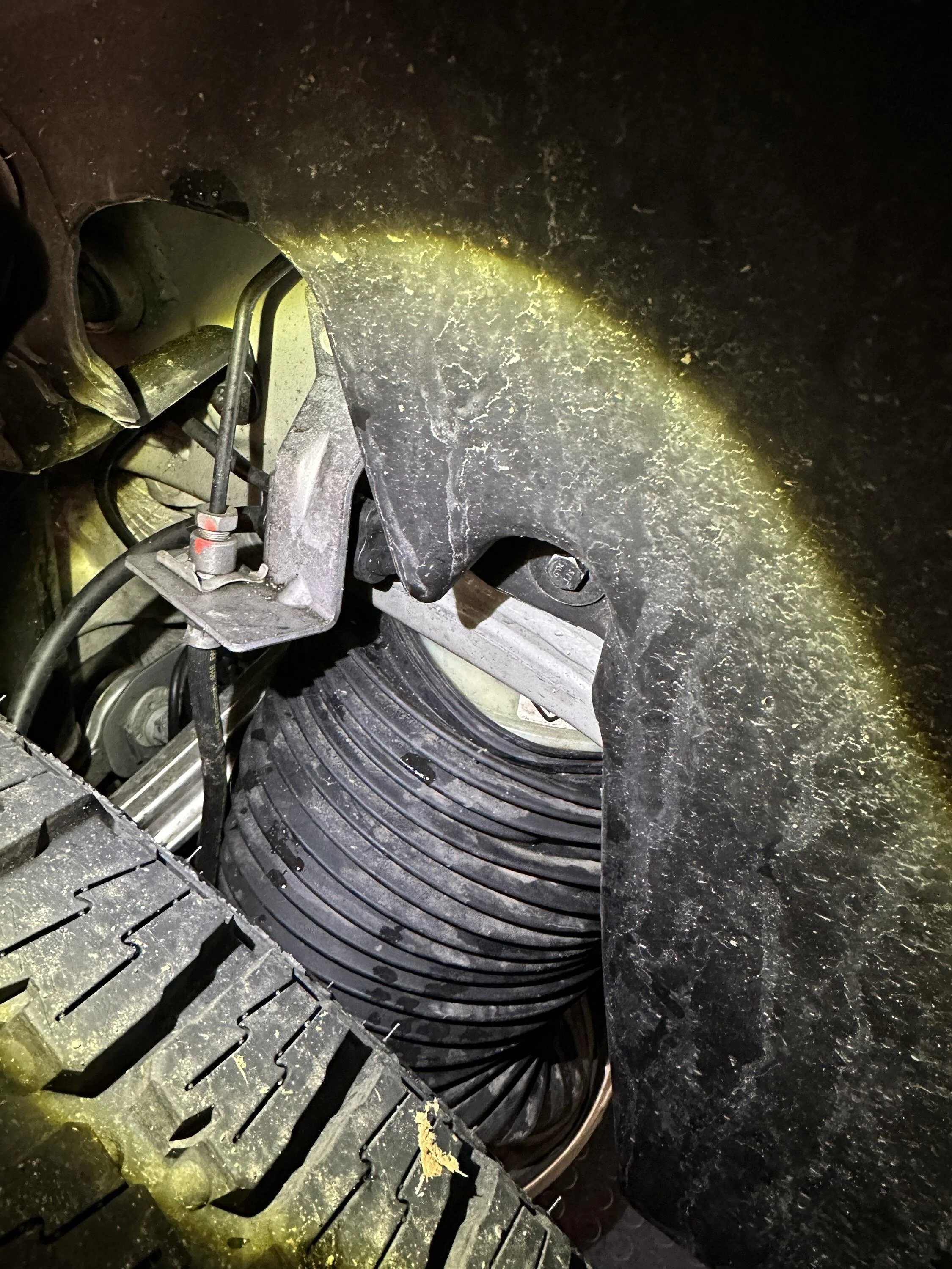

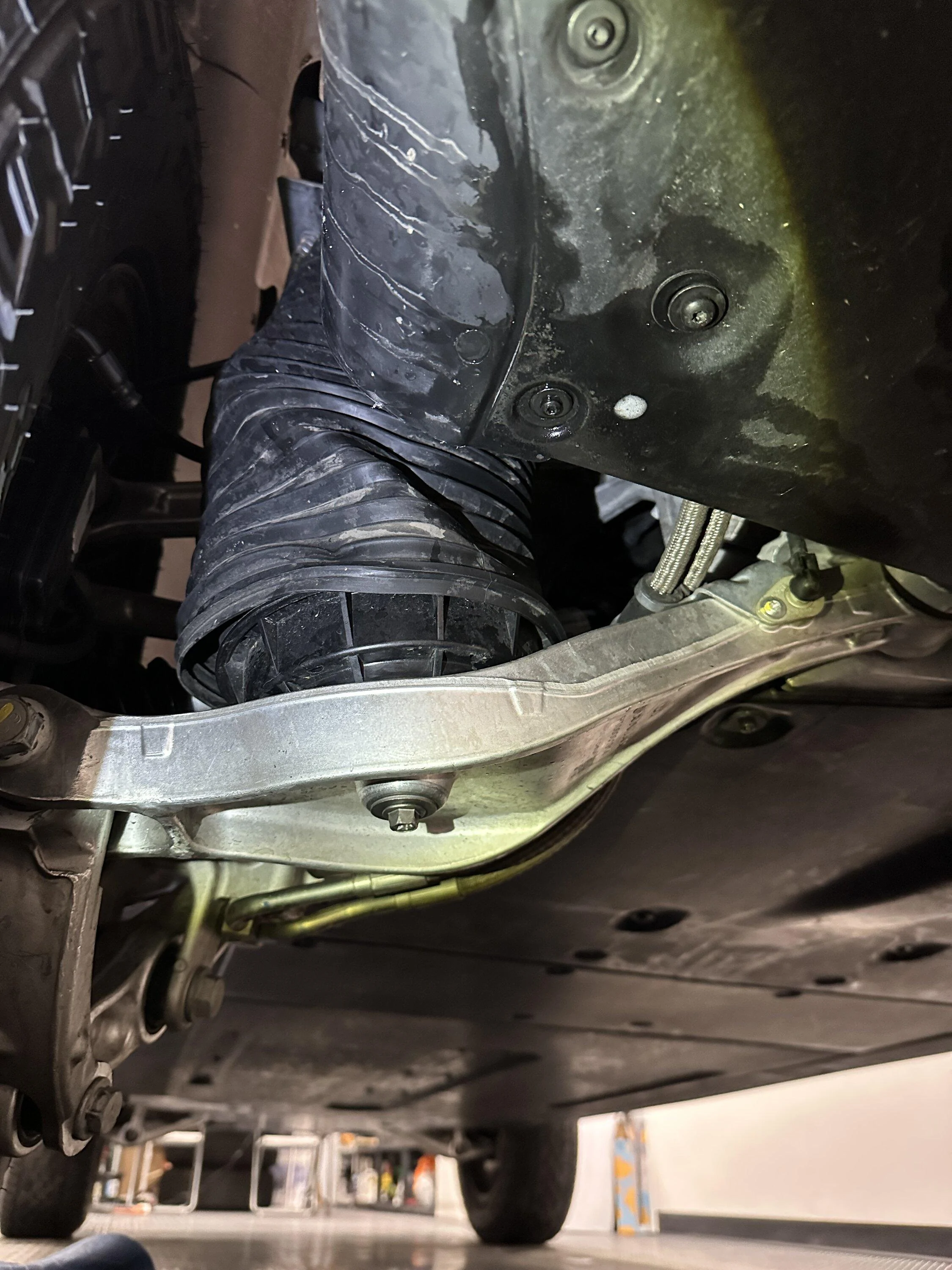

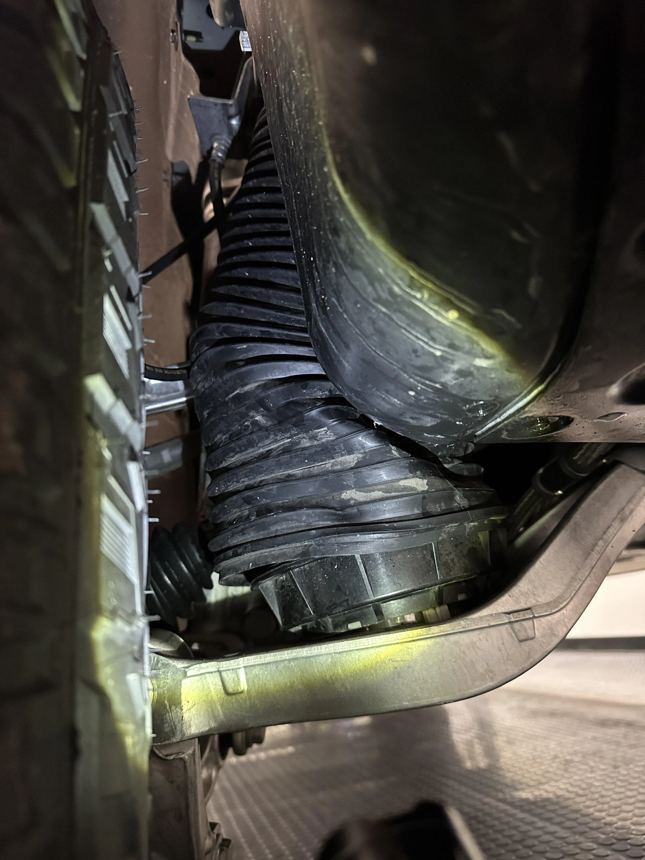

So I decided to call Rivian support. While I was waiting on the phone, I decided to check the vehicle level sensor on each corner. All of them were installed visually properly and the plugs were connected tight.
However, on the RL end, I saw something wrong with the air strut. By that time Rivian support team has answered the phone. I told them the whole story and they told me since I have rebooted the car a few times already and it did not fix the issue, they asked me to force the truck to go into the deep sleep cycle and then call them back. I did it and it did not fix the issue.
So after I have completed all of those steps I raised the car again and went to take a look at what was wrong with the RL air strut.
Here is what I have found.
Rivian R1T R1S Rivian service center messed up (fixed!) IMG_1466
Rivian R1T R1S Rivian service center messed up (fixed!) IMG_1467
Rivian R1T R1S Rivian service center messed up (fixed!) IMG_1468

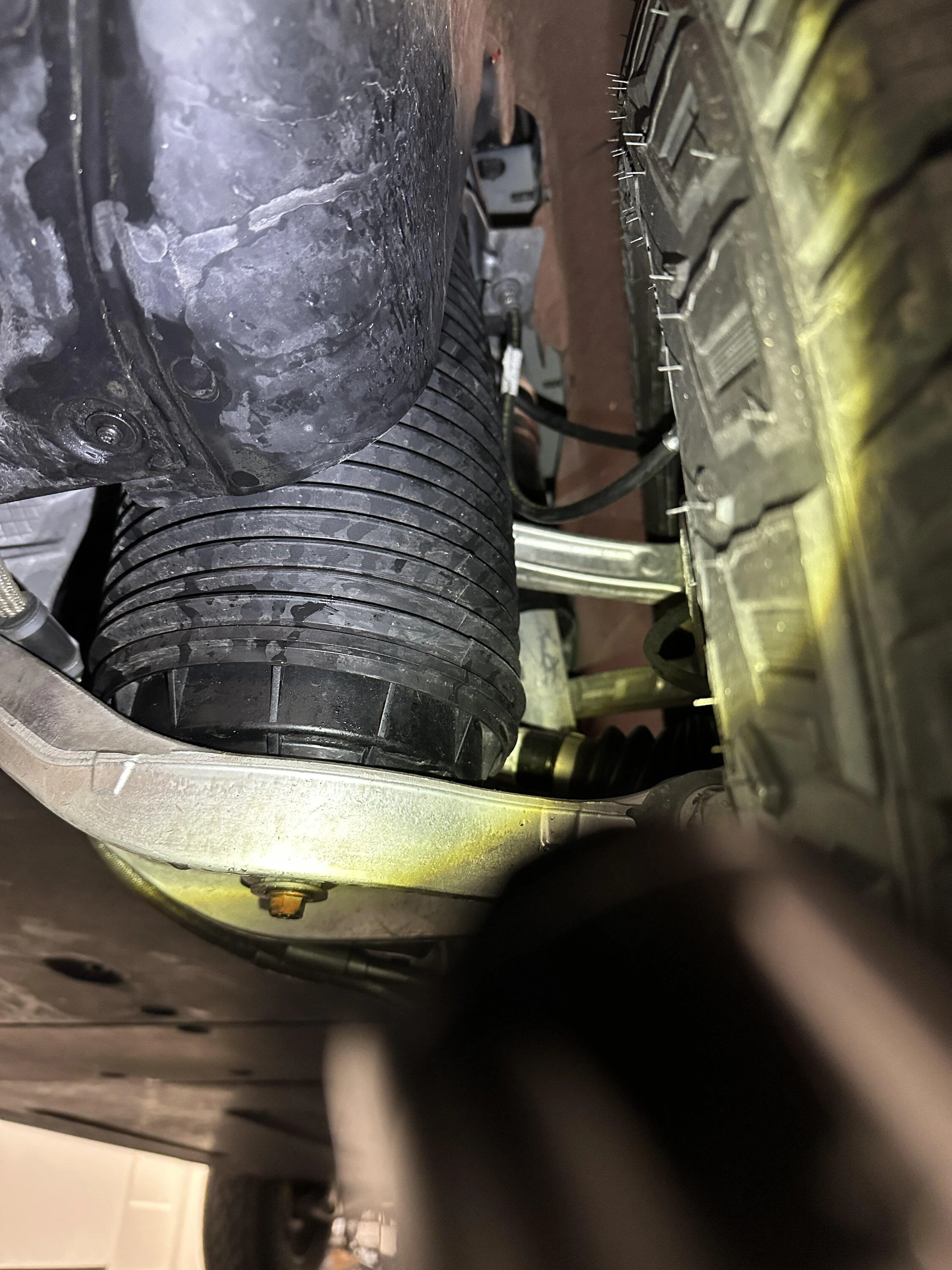

As we can see it is not looking good. Also if you will take a look at where the air strut is connected to the lower control arm it is installed not properly.
Here is the RR air strut for comparison.
Rivian R1T R1S Rivian service center messed up (fixed!) IMG_1469
Also, if I lower the truck to "lower" now I can see this error:

I can't tell if for sure that airspring is misinstalled or the tech just didn't care enough to install the dust boot nicely.
