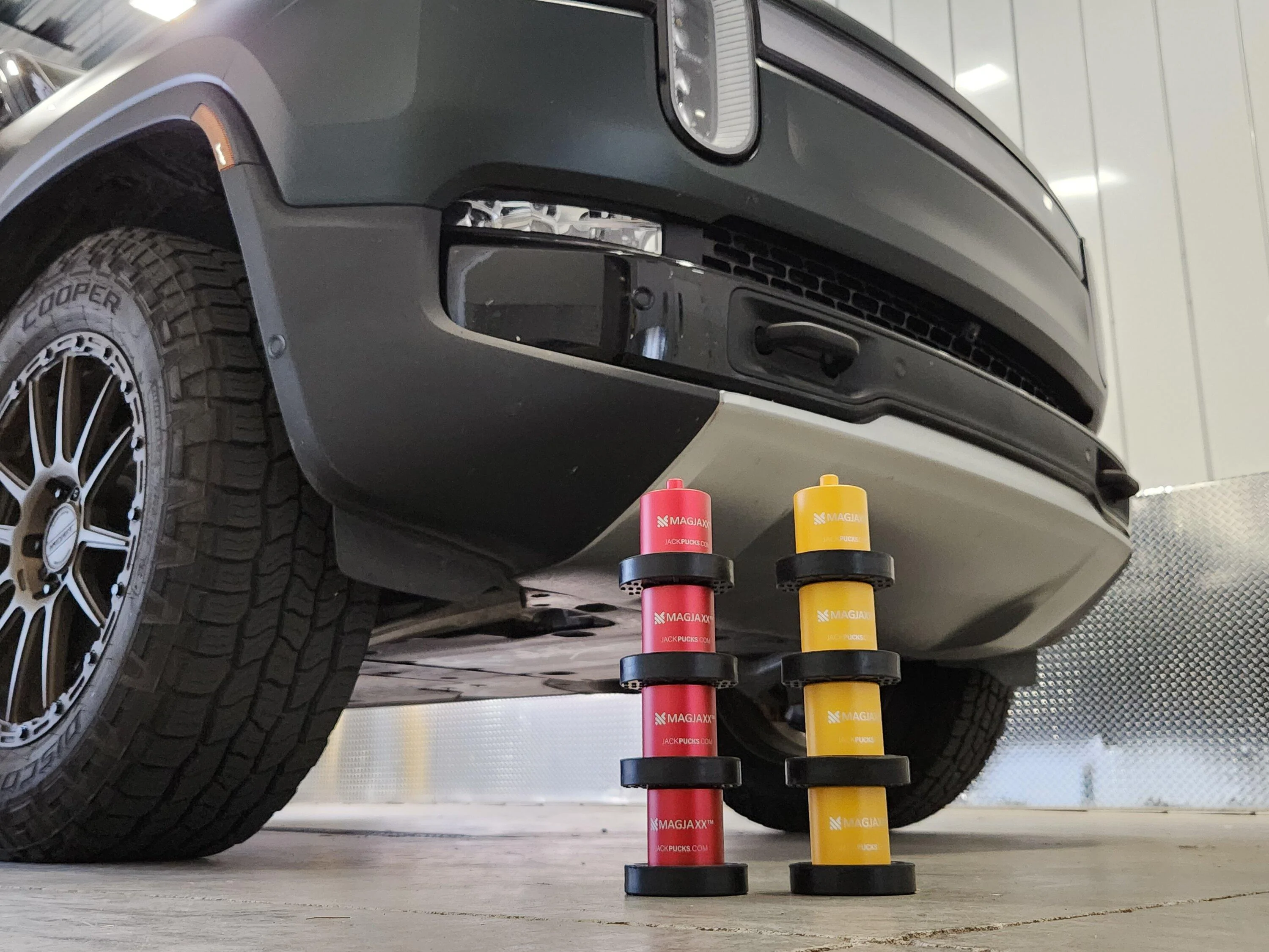

Did Radial Tires have the pucks?
If they don't have them, we do. We have put thousands of our magnetic jack puck kits in owners hands. Buy today, ship today.
Rivian R1T R1S Rivian-Capable Tire Shop Near DC 20231007_083042
