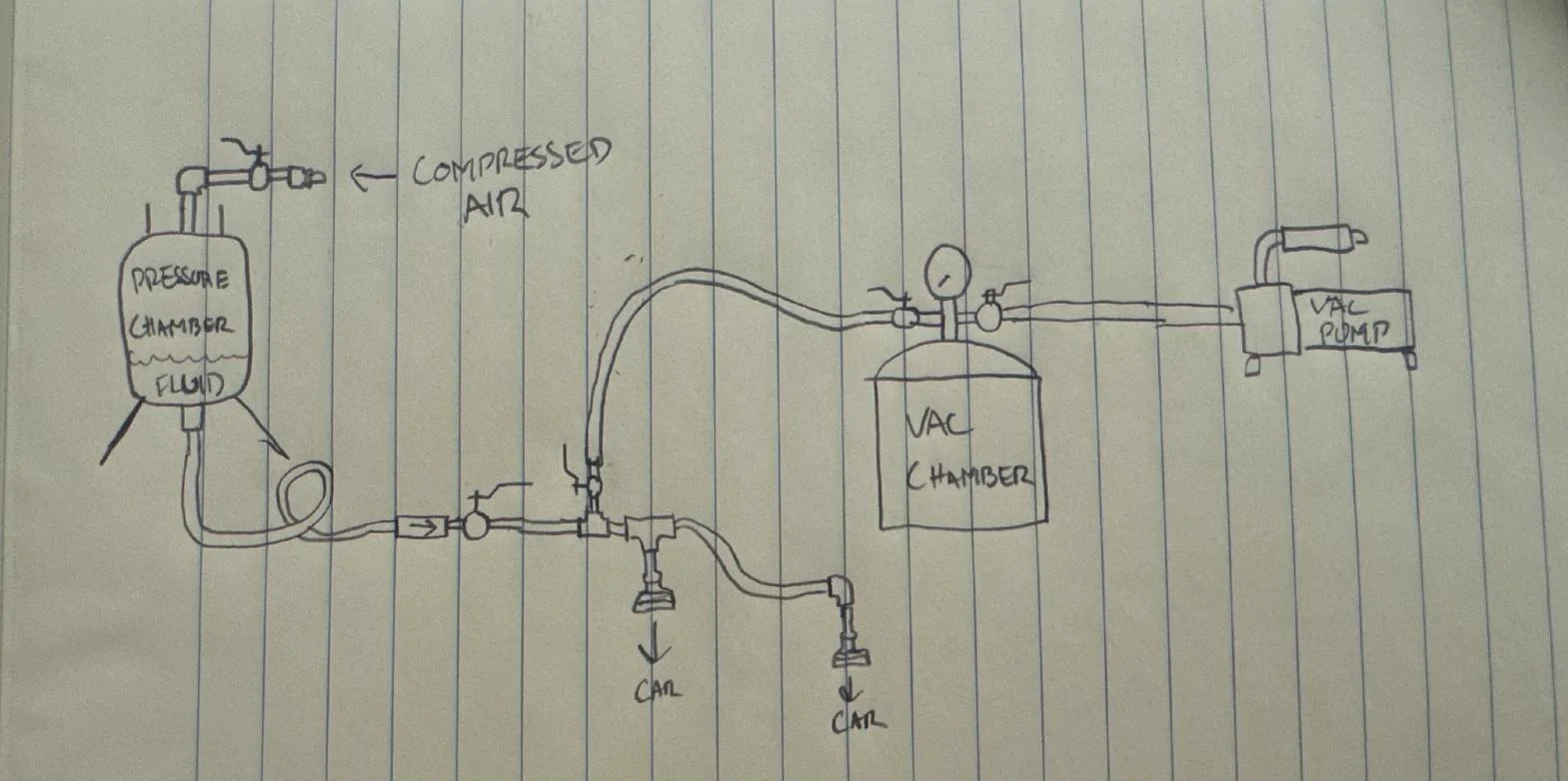

So I made my own like in his video using a Harbor Freight media blasting chamber, an A/C vacuum pump + chamber (as a fluid separator), some 1/4" semi-rigid nylon line, and some misc fittings etc. It certainly doesn't have to be that expensive... probably $600 all told? And I can do it again if/when I need to. These systems are great, but I'm not convinced about reliability. I suspect I'll be back again at some stage needing to flush/bleed, and without a warranty I don't want to pay someone else to do it!
Looking at my doodle again, I omitted the check valve.
  1. Fill suspension pump reservoir, run pump to pressurize line to solenoids, blip solenoids during pump running to ensure no air trapped in line.
  2. Fill pressure tank and line to tank side ball valve (use vacuum pump if necessary), close. 4qt Pentosin CHF 11s
  3. Connect quik-connects (OEM is parker, recommend change to Swage-lok) to vehicle, pull vacuum - removing air + old fluid until a strong vacuum is reached and holds. Close vacuum side ball valve.
    1. You now have some old fluid and vacuum in the vehicle system, ideally no air.
  4. Open tank side ball valve. This will admit new fluid to the system, vacuum pulling it into any and all open spaces in the vehicles system.
  5. Apply 120 psi of compressed air to the headspace in the pressure tank. This pressurizes the system to 120 psi.
    1. If at any stage you see air moving through the line from the pressure tank to the vehicle, begin again from step 2.
  6. Close tank side ball valve.
  7. Disconnect quik-connects.
  8. Enjoy.
  8. Enjoy.
That's awesome @The_Skg and a great help.
And here I thought that having an EV would deprive me of all the "shade tree mechanic" fun. Is it wrong that I enjoy the idea of repair causing me to build something else and acquire yet more tools?
I have compressors and a vacuum pump. The 20lb HF pressurized abrasive blaster should do the trick. Found a 3gal stainless vacuum chamber on Amazon. I have some 1/4" pressure hose, valves and fittings on hand but will likely have to buy a few more. Add a cart and a gallon of CHF 11S fluid.
Quick connects might be the trickiest item. It is tempting to stick with the OEM connector so that it could be used with any Rivian without modification.

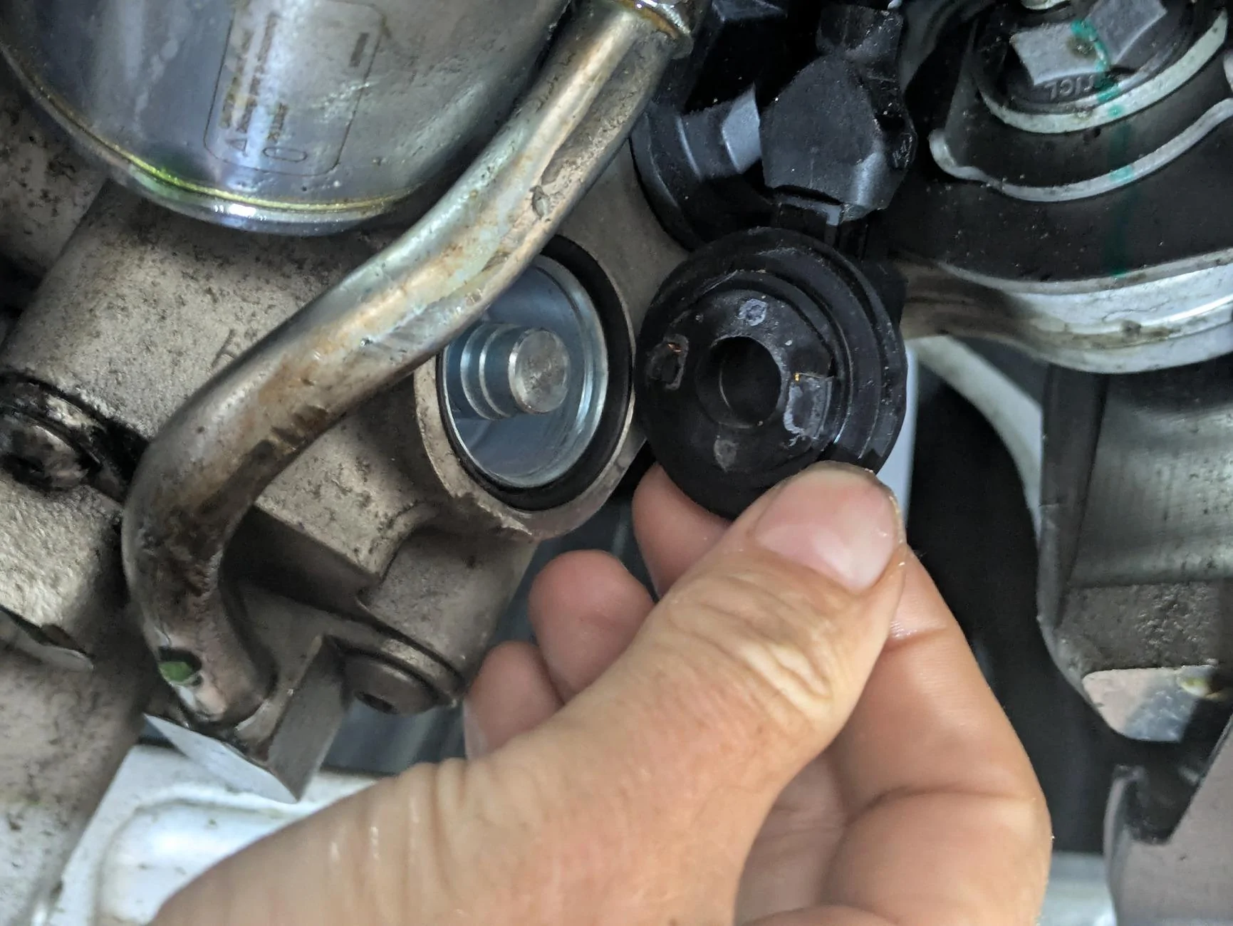

@The_Skg Did you end up having damage to the solenoid? Looks like the retaining ring is missing from my lower one. Haven't found any replacements. Suppose I could secure it with a zip tie or adhesive, but would rather have a solution that's not likely to fail.

Well, I bought my replacement damper directly from my local rivian service center. It came with a new solenoid and wire harness going up to the knuckle. Two or three connectors all came together in one place, if I recall correctly. I didn’t try to repair the unit.
Im missing the entire piece your holding on one side and on the other side it’s damaged. I’m going to see if I can order those. Were you able to get a retaining clip?
