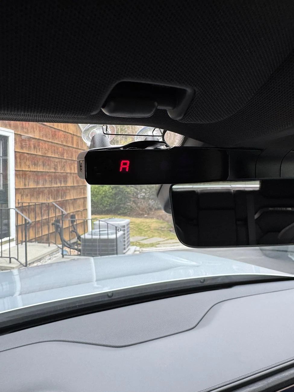

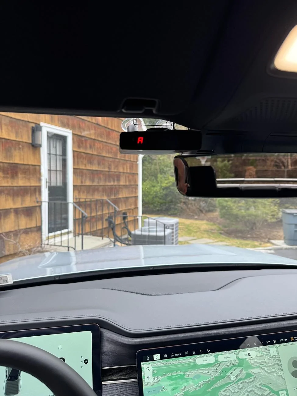

I did the tried and true method of simple suction cup mounts on my Valentine 1
Rivian R1T R1S Radar Detector hardwire, who has done it? IMG_5107
Rivian R1T R1S Radar Detector hardwire, who has done it? IMG_5106

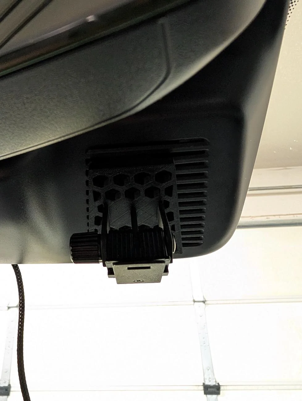

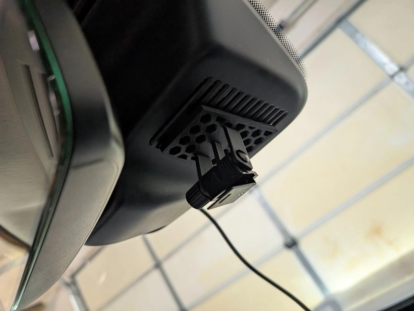

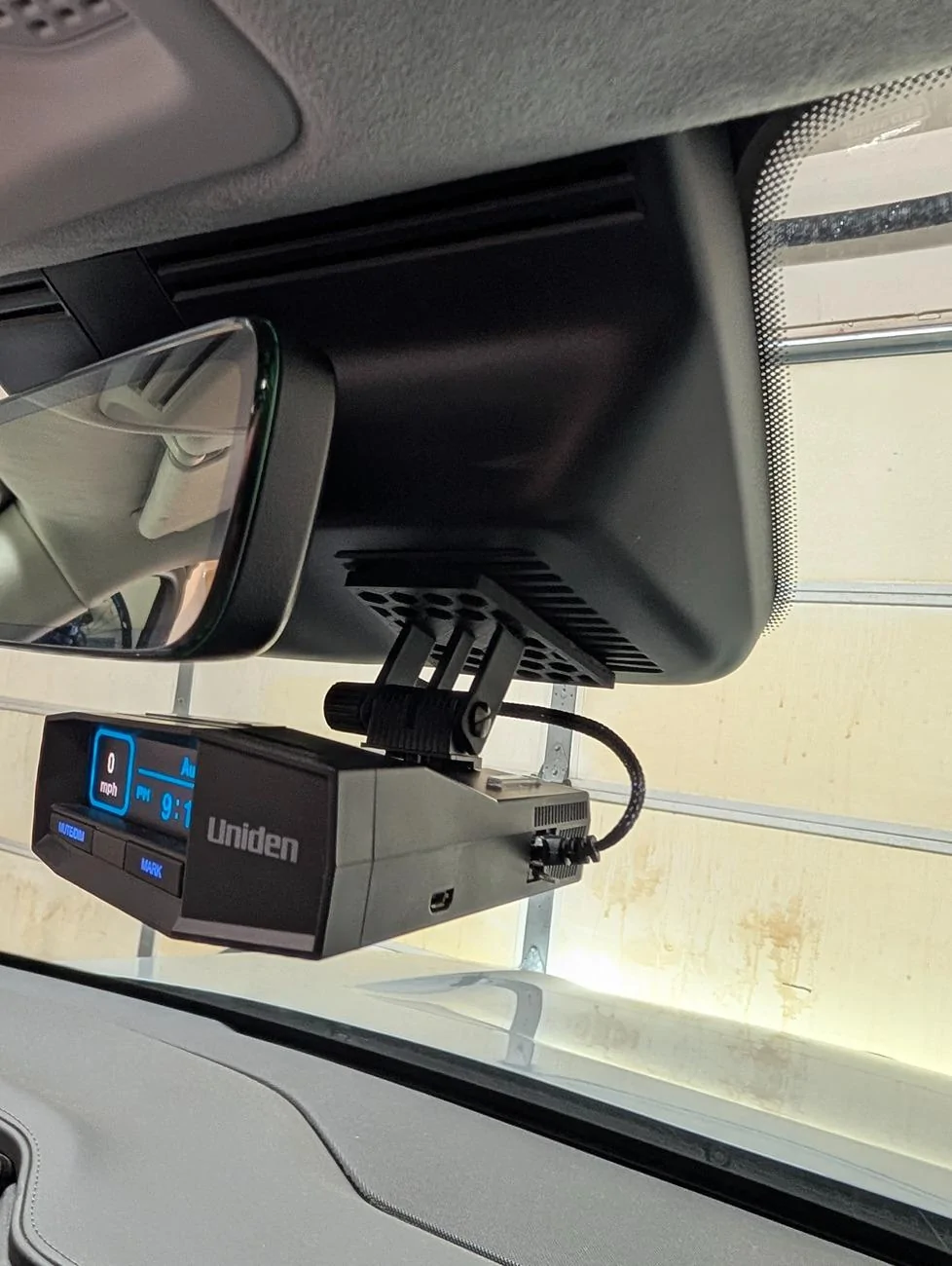

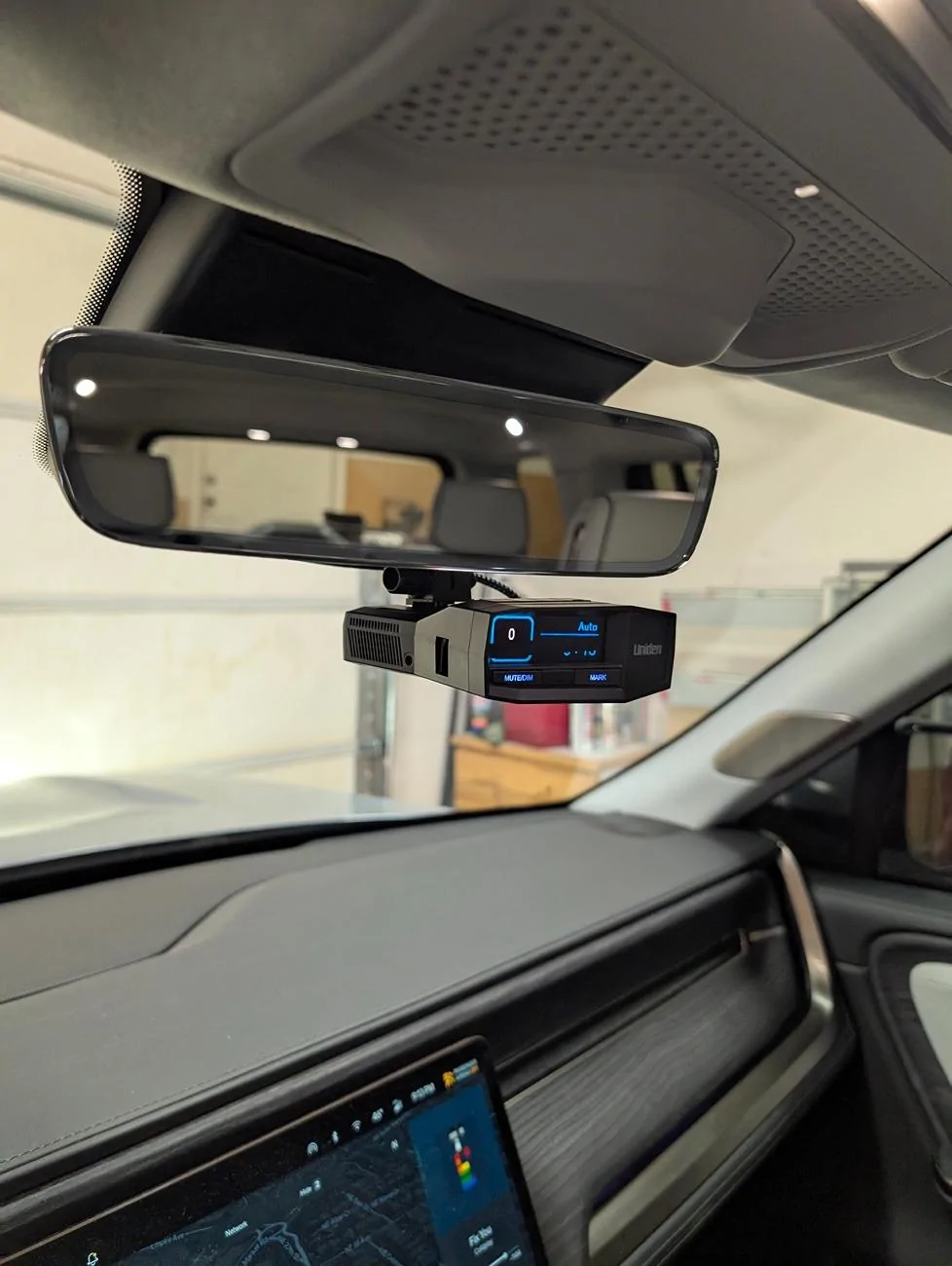

For those who use the Mirror Tap, would you be interested in a mount like this so that you don't have to attach to the windshield? I normally would go with the blendmount route, but it seems like its a crapshoot if one will actually fit and allow the rear view mirror to be adjusted.
YES!
zefram47
Aaron
Feb 6, 2022
2,766
4,540
Rivian R1T, Alfa Romeo 4C
I have it done and ready. I can provide an STL if you want to print it yourself. Otherwise, I can print and ship. PM Me.
I'd be interested in the STL. I'm still using the sticky cup that came with my R4, but it falls off the windshield on really hot days. I'm usually a Blendmount guy, but there's nothing that officially works.
