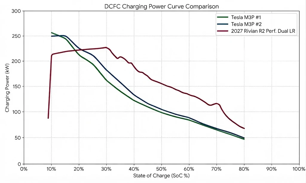

I've been interested in the differences between R2 and Tesla charging curves. Over the least few weeks, I've done some 10% to 80% sessions at a V4 supercharger (posts) with my 2024 Model 3 Performance (Highland) at 8am before it got hot, so no derating. I plotted them on the graph below using the R2 curve from Tom at SOC. I imagine this would be the same charging curve for Model Y as they share the exact same cells, sans the new MYP.
It is interesting to see this in a graphic visual. It confirms that R2 has a much better curve and also charges quicker than Tesla. The area under the curve for Tesla is crazy. It took a few seconds under 30 minutes each time for the Model 3 for 10% to 80%. R2 did it in just under 27 minutes per Tom. Model 3 took 23 minutes for 10% to 70%, R2 did it in 20 minutes. That might not seem like a lot but shaving a few minutes off is a very big deal from an engineering and thermal perspective. Lest we also forget R2 has an 11-12% larger battery too, so one would think the Model 3 could/would charge quicker - or at the very minimum be the same - but it's worse. This shows how good R2 thermals are coupled with the 4695 tabless cells for better heat dissipation
Yes, we all know it is not 800v. We don't need to bring that up anymore. The point is the R2 is still very capable, very good, and beats out its main competition which is Tesla.
Rivian R1T R1S R2 vs Tesla Charging Curve Comparison 1784573943310-l5

Why is 70% on the x axis twice? I was trying to map other vehicles onto this and a little confusing
VSG
Oct 3, 2022
3,426
6,540
R1T LE/RB/OC/20
Funny. Looks like AI slop. There's also a problem with the width of the grid squares around 20% and 50%.
Also, 6 divisions per 10%? So 1.7% per division? That's not wrong, but it's also not what a person would choose. And between the second 70% and 80% it's only 5 divisions not 6 like everywhere else...
Regardless, the shapes of the curves are qualitatively correct.
It would be nice to see the R1 curve on there too - the R1 is similar to but better than the R2, because the R1 holds >200kW all the way up to 50% before dropping off. In my R1 I usually stop charging when the rate drops below 100kW, which usually happens around 75%, just like the R2. That takes longer in the R1 than in the R2 because the R1 battery is so much larger.

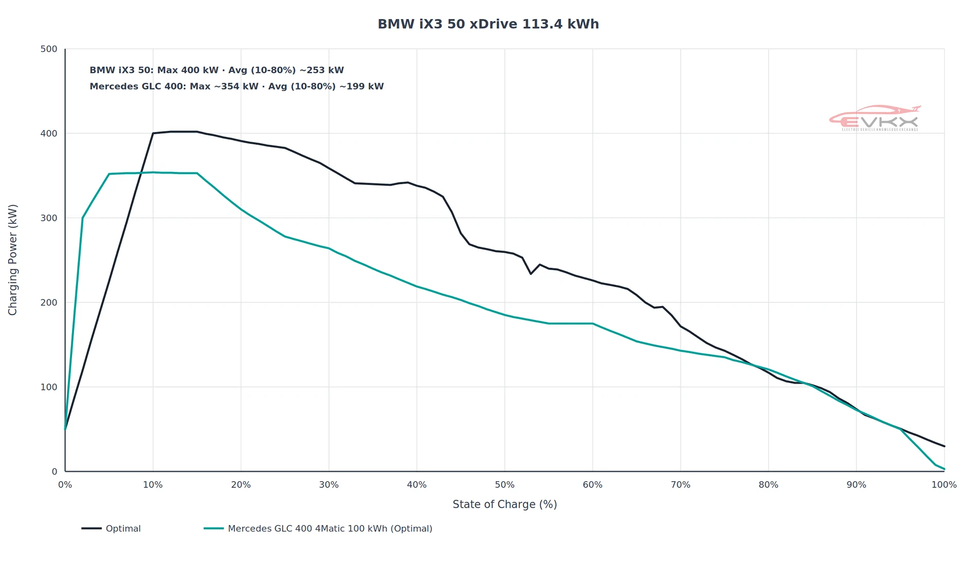

Worth comparing if the R2 data gets sorted are these two competitors.
Rivian R1T R1S R2 vs Tesla Charging Curve Comparison iX3_vs_GLC_charging

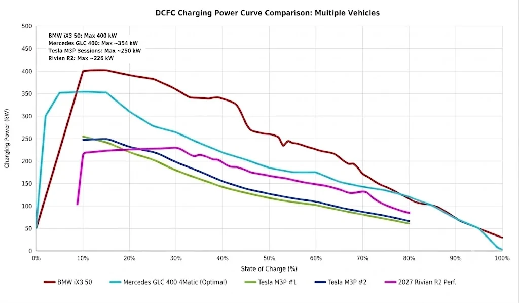

We've all fallen victim to Microslop (rule #1 of the AI era, co-pilot is not really ai).
Updated original post, my bad. Added your charts to the below. Ironically the BMW looks so much better on the graph below but still takes ~21 minutes 10 to 80%.
Rivian R1T R1S R2 vs Tesla Charging Curve Comparison 1784574656141-ma
My bad, fixed. R1 has such a large battery pack compared to R2 (141 kwh vs 88 kWh) it will hold 200kW to about 50% where as R2 holds 150kW to 50%. C rate shows how much better the cells and thermals are on R2. Can do at 30% also for peak rates and it's an even bigger disparity.
50%:
200kW/141kWh=1.42C
150kW/88kWh=1.70C
30%:
~215kW/141kWh=1.52C
226kW/88kWh=2.57C
Now that is current gen charging specs. Looking forward to seeing them tested stateside. Germans on a roll.
Not entirely interested in comparing R2 to what is essentially Model 3 battery tech that launched 10 years ago.
The only thing really keeping Tesla tech relevant is their efficiency.
