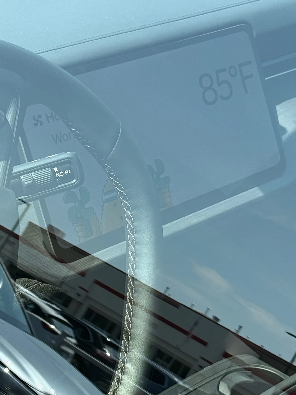

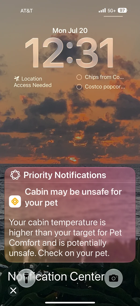

Had same problem with pet mode today. 85 degree outside temp. Car set to 73 auto low fan speed and comfortable on drive to Costco. Enabled pet mode. After about 15 min got a message that cabin was overheated (thank you rivian) and immediately went back to car. Ac running but not enough. Internal temp was 86 degrees. Definitely a very dangerous bug I hope the fix rapidly!
I’m sorry this happened in real world usage and not just to some bald guy sitting in his driveway in the car like mine did - Rivian needs to address this asap. I believe Wassym is aware but I haven’t heard anything yet.
