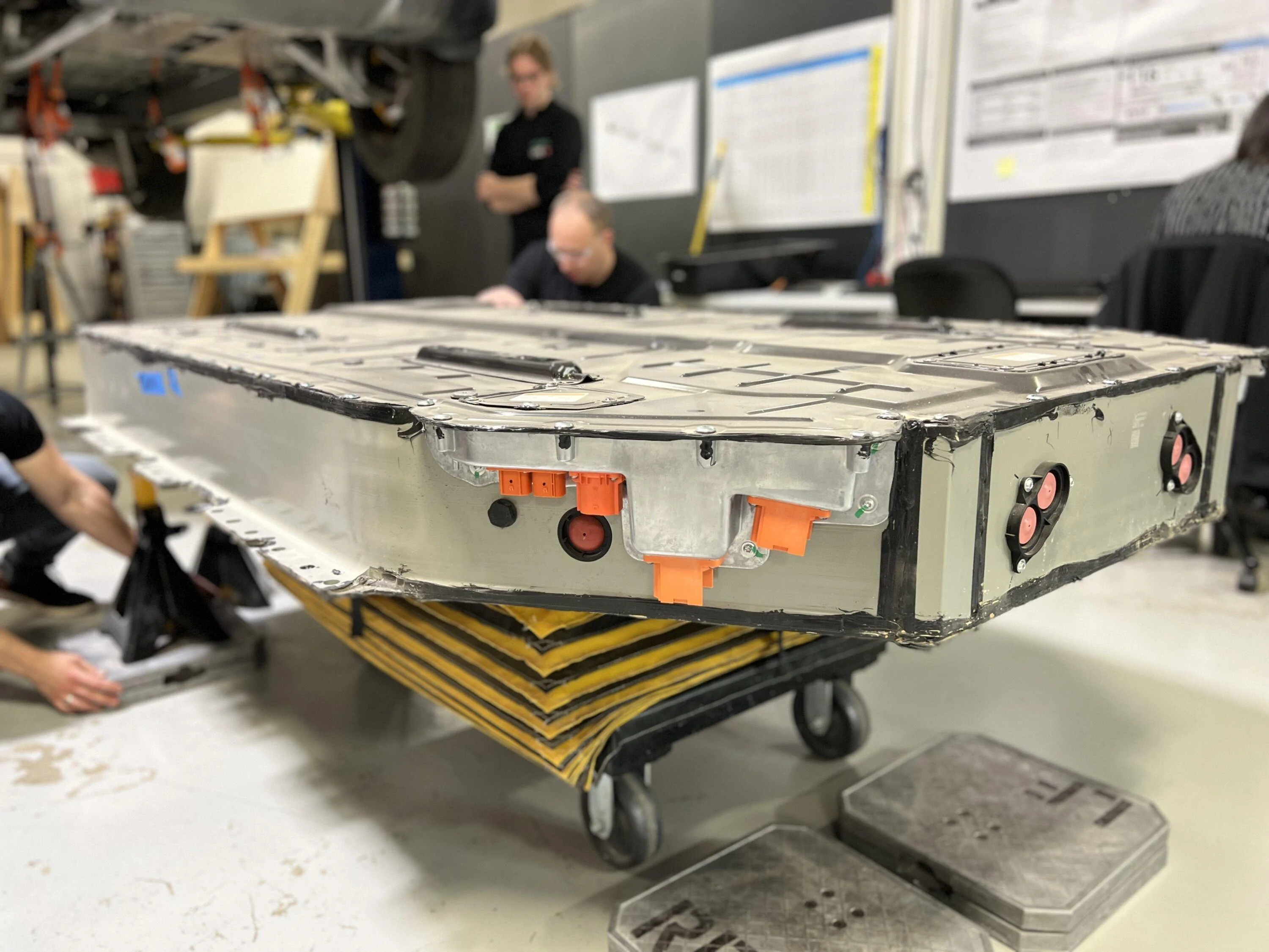

The Rivian 1,750 pound battery pack is a 135 KWh monster.
It does an excellent job with keeping the center of gravity nice and low. A flipped R1T would be a rare event.
