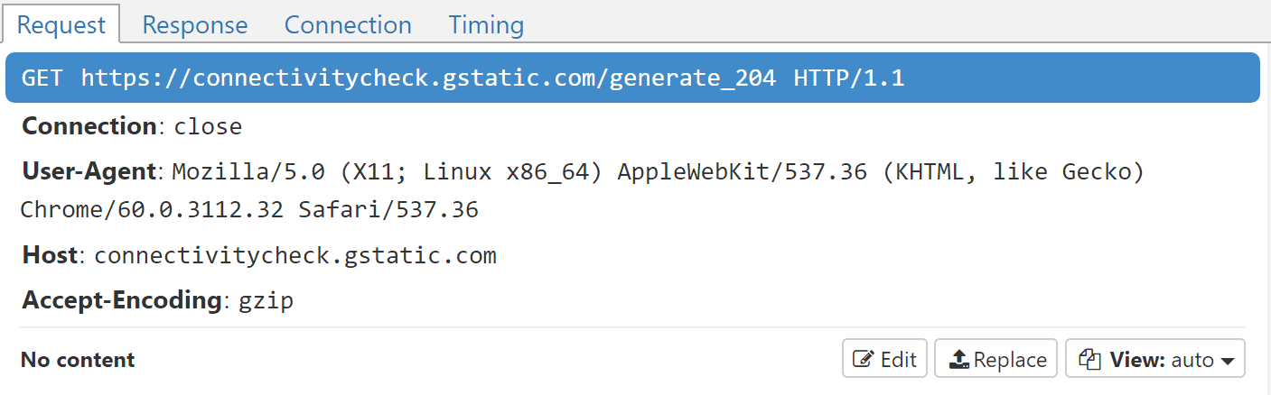

Some more smoke to the Android fire... I've got the truck running through mitmproxy. I have it setup so that tls negotiation failures fallback to not decrypt so things still function but I just pick up the tcp connects and no data. It randomly called out to Google Play while the truck was just sitting in my driveway this morning...
Rivian R1T R1S R1T Network Traffic 1658145022080

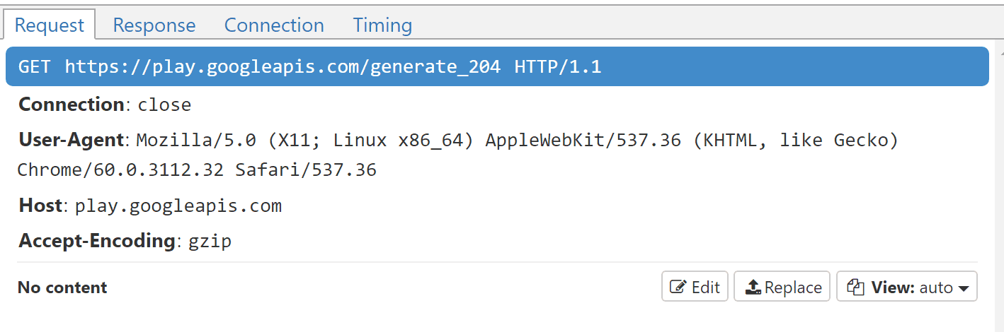

Also seen these previously and while I think it also points to Android, it's not as definite as play APIs.
Rivian R1T R1S R1T Network Traffic 1658145058857

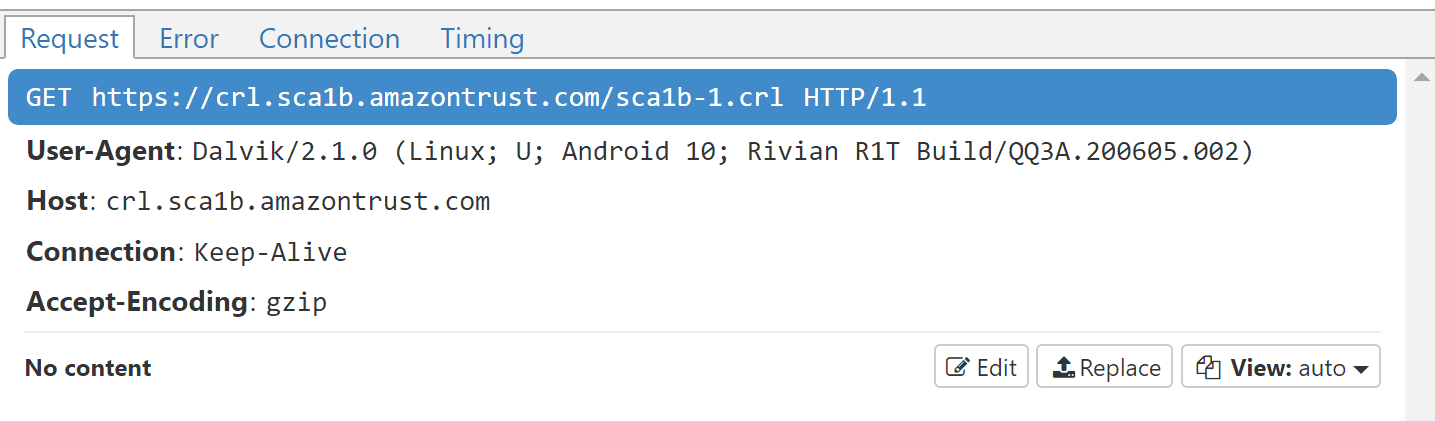

I happened to be messing with the truck and decided to reboot the infotainment. After doing that I noticed some new network traffic to prd-s3-vcloud-package-distribution.s3.us-east-2.amazonaws.com right as it started downloading the latest update. Just prior to that there was a call to device.ota.goriv.co so I assume that url does the coordination and the update files themselves come from the S3 bucket. Too bad the base bucket requires auth and it's all TLS so there doesn't seem to be a way to grab the update file. Would certainly be interesting if we could get ahold of one.
During the update this web request popped up. Is there really any doubt at this point that there's Android running in the infotainment?
Rivian R1T R1S R1T Network Traffic 1657122335523

Some current URLs (all require TLS) after the latest update. Funny that they're using a telenav stage endpoint in production. Either Rivian is making use of things not yet in the telenav production environment or they accidentally shipped the wrong config.
