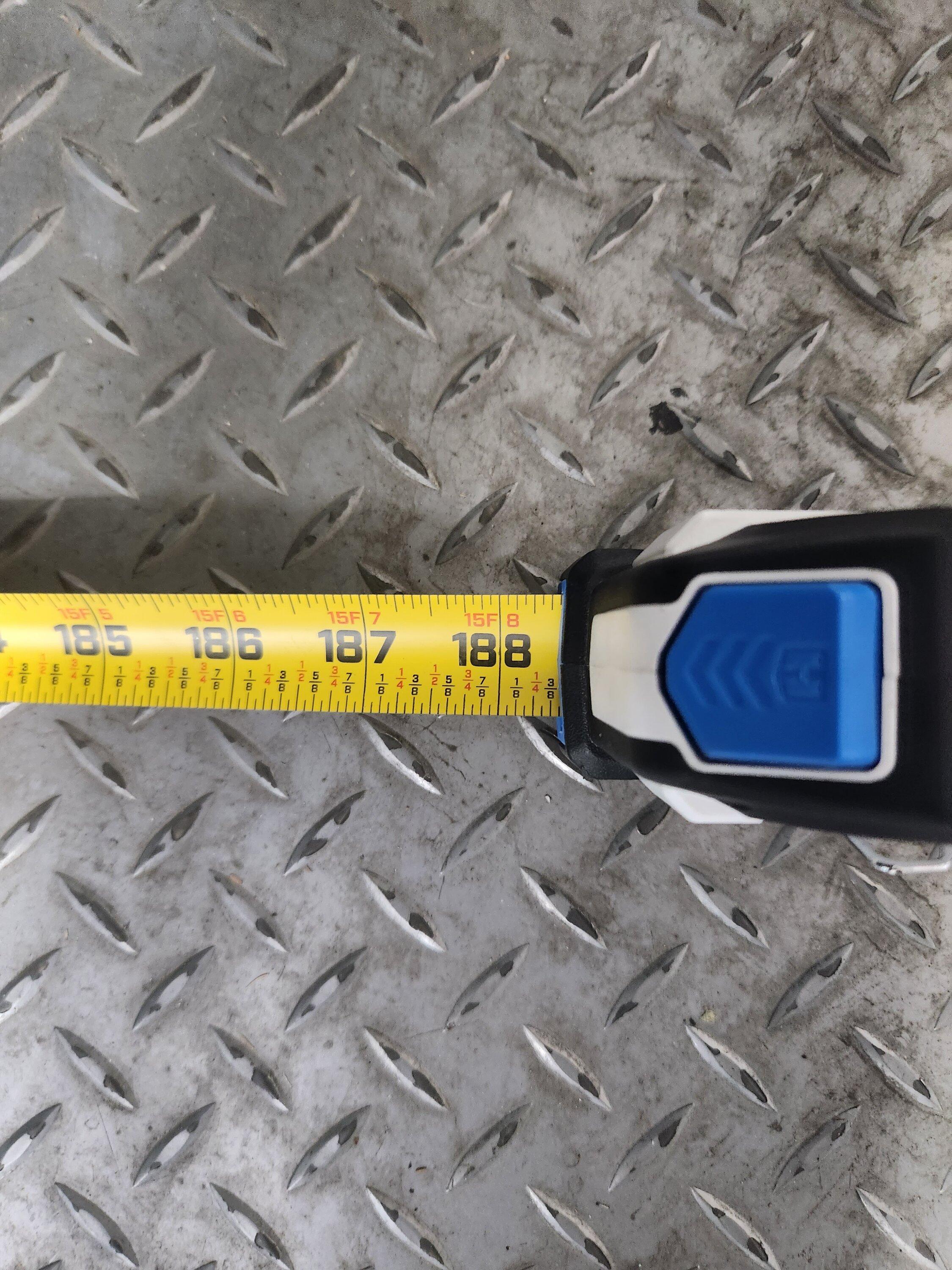

188" or 15.667 ft. 20's A/T

Thanks for the quick responses! I wasn't thinking about the tire size differences. I will have the 20" A/T and just checked the length I have available. Looks like I may have only 1 inch of clearance for the garage door to close. That is not leaving much margin for error so I think I need to figure out a solution.

Yup, that's what I will have to do. I double checked measurements and I have 187 inches between the garage door and the landing which is 7.5 inches high. My wife is not happy about the idea of having to pull it up onto a 7.5 inch landing every time so I am considering cutting the concrete back.

2nd: I have a similar “curb” setup in my garage, albeit more garage depth than you have, so I went out to the garage and backed the truck up to the 7.5” curb (mine is only 4” tall, so I had to mock-up 3.5” more height). I have the 20’s btw.
I then measured from curb to garage door, then subtracted distance from garage door to front bumper; what’s left is 186.5”
Certainly close, but if it works out the curb will act as a perfect parking bumper when backing in.
As you’ve mentioned, cutting the concrete back would be an idea, even simply grinding or chipping away the top 90 degree edge at an angle would give you another inch or two of space.
