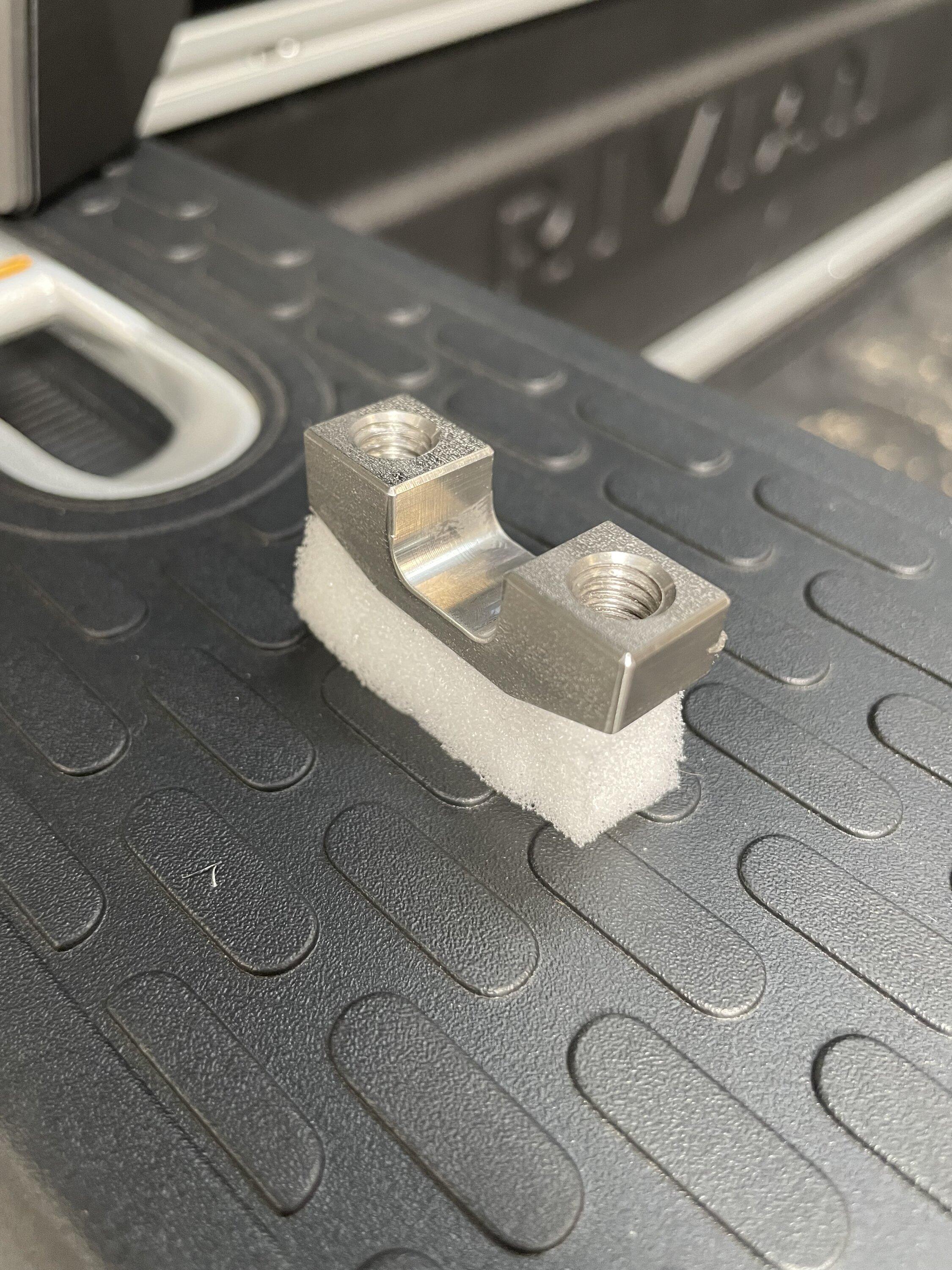

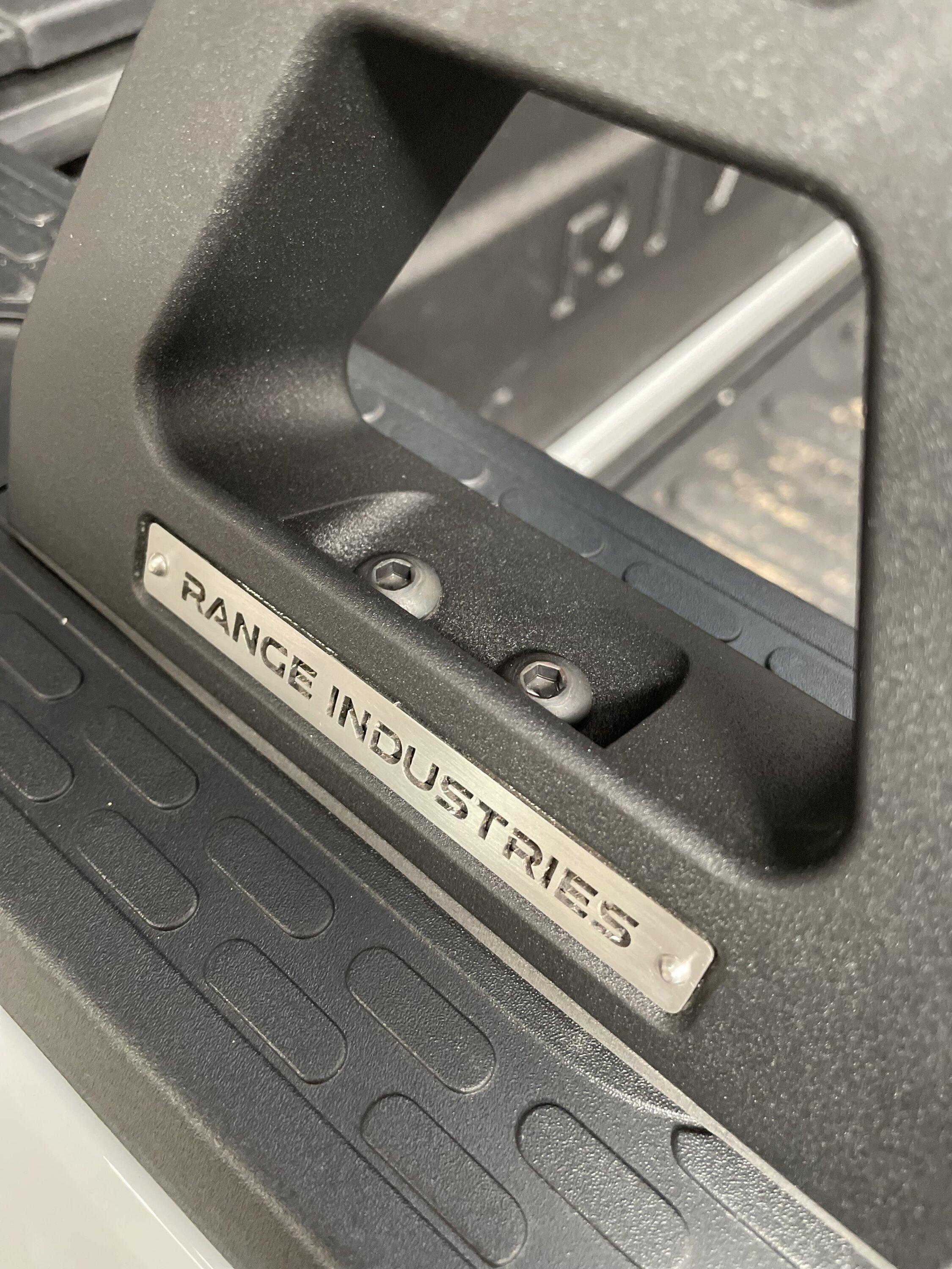

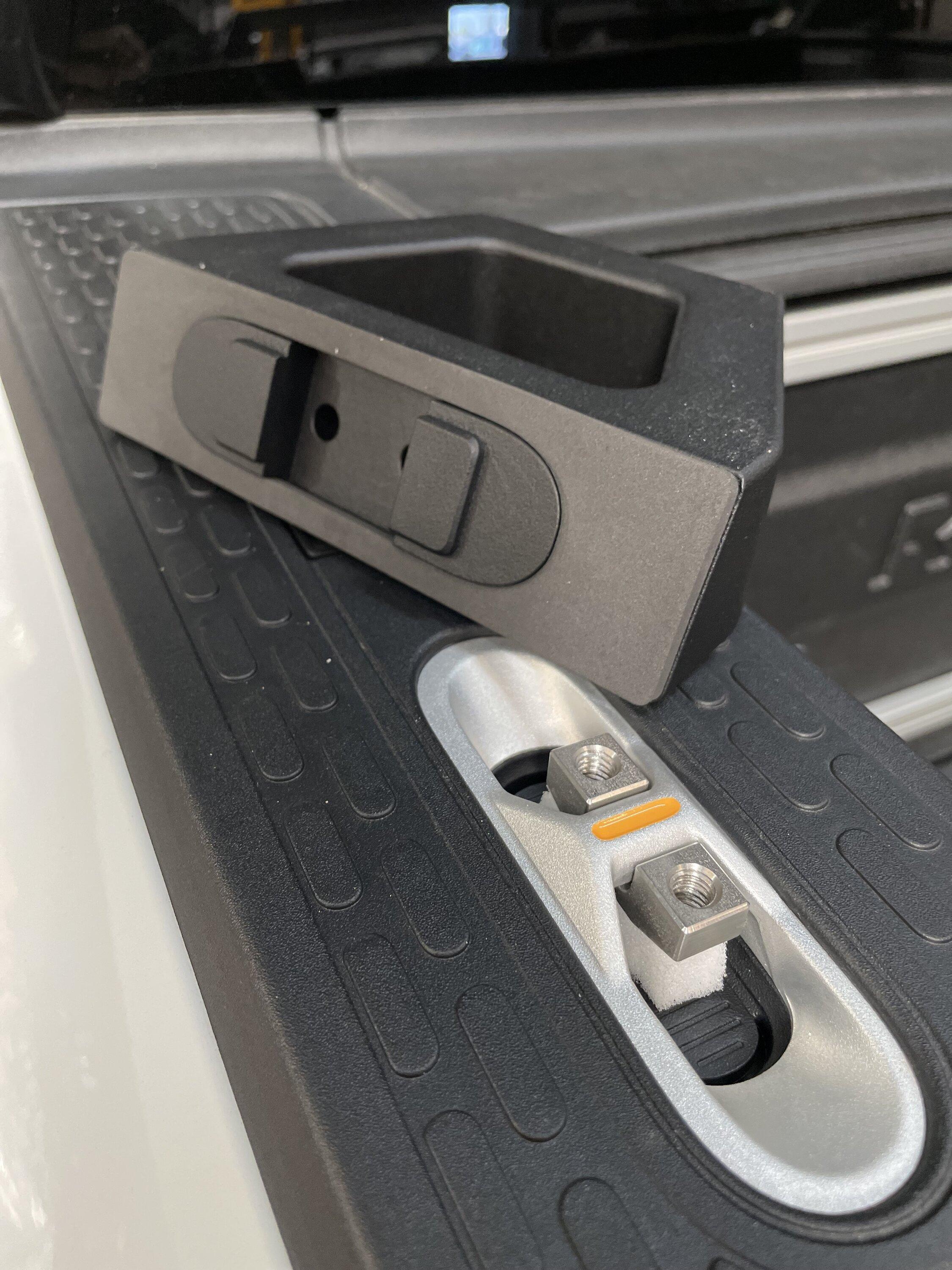

Looks great, does it mount to the factory crossbar points? How involved will it be to mount and remove from the truck? I currently have my RTT mounted to the crossbars and it's a very quick process to just unclip the whole thing and lift it right off the truck. I'd like to be able to do that with a rack system like yours if possible.
For all of our R1T racks we use 303 stainless steel u-nuts to interface with the factory crossbar points. We tried a number of different attachment methods but ultimately decided we wanted to prioritize strength and stability over mounting speed. Rivians factory crossbars are very slick with how easy the are to install and remove from the vehicle, however, in our opinion they leave a lot to be desired in terms of rigidity and stability. With our lower racks (Badwater and Sierra) there are two 5/16"-18 bolts per corner that thread into the stainless steel u-nuts. If one was to remove all 8x mounting bolts (with RTT attached), they should be able to lift the rack and RTT off together, then re-install in the same fashion. Definitely a little slower than the factory crossbars, but should be a sub 5 minute job.
Our roof level rack will feature a very similar mounting style where after removing 2X 5/16"-18 bolts per corner (8 bolts total), you should be able to lift the entire rack off as an assembly. I'll include some photos of our u-nuts and uprights for our Badwater rack so you guys have a better idea of how our systems work.
