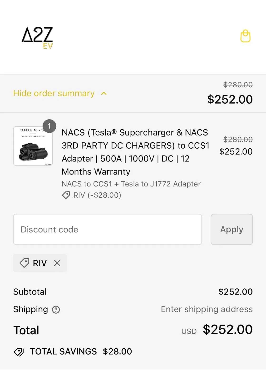

I personally would install a hardwired EVSE with a 60 amp breaker for long term charging.
For right now you can use the Tesla charger you have with A2Z Stellar J-1772 adapter and manually turn down the amperage on the Rivian to around 40 amps or lower. You want to only use 80% of amperage for continuous load as long as your wire / breaker is up to spec.
If I was in your situation, I would order the Tesla AC to J-1772 adapter so you can use the Tesla charger you have while you figure out a hardwire solution @ 48 amps / 60 amps.
You can get both Tesla AC and DC chargers on a bundled sale from A2Z which would cover all your charging scenarios at home or on the go. The Stellar AC (home) Plug is normally $112 and Typhoon DCFC (Tesla fast charger) is $197. You can get both of them with the bundle discount and "RIV" coupon code for $252 with free shipping.
