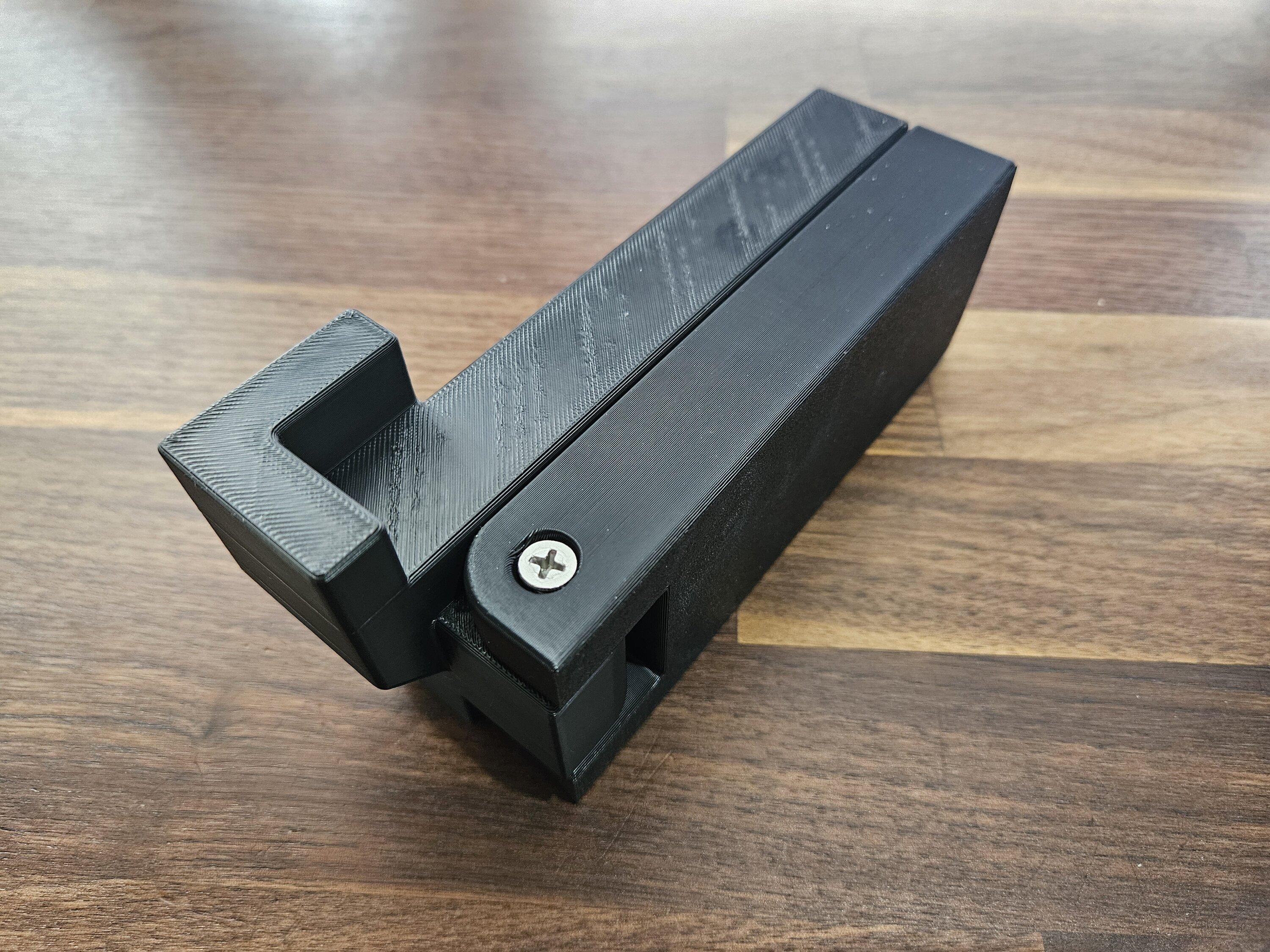

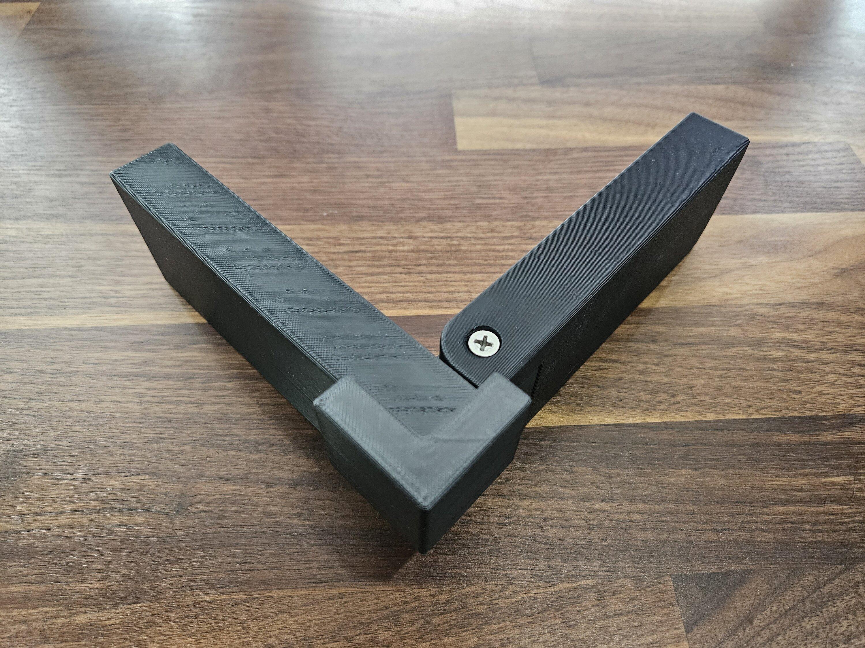

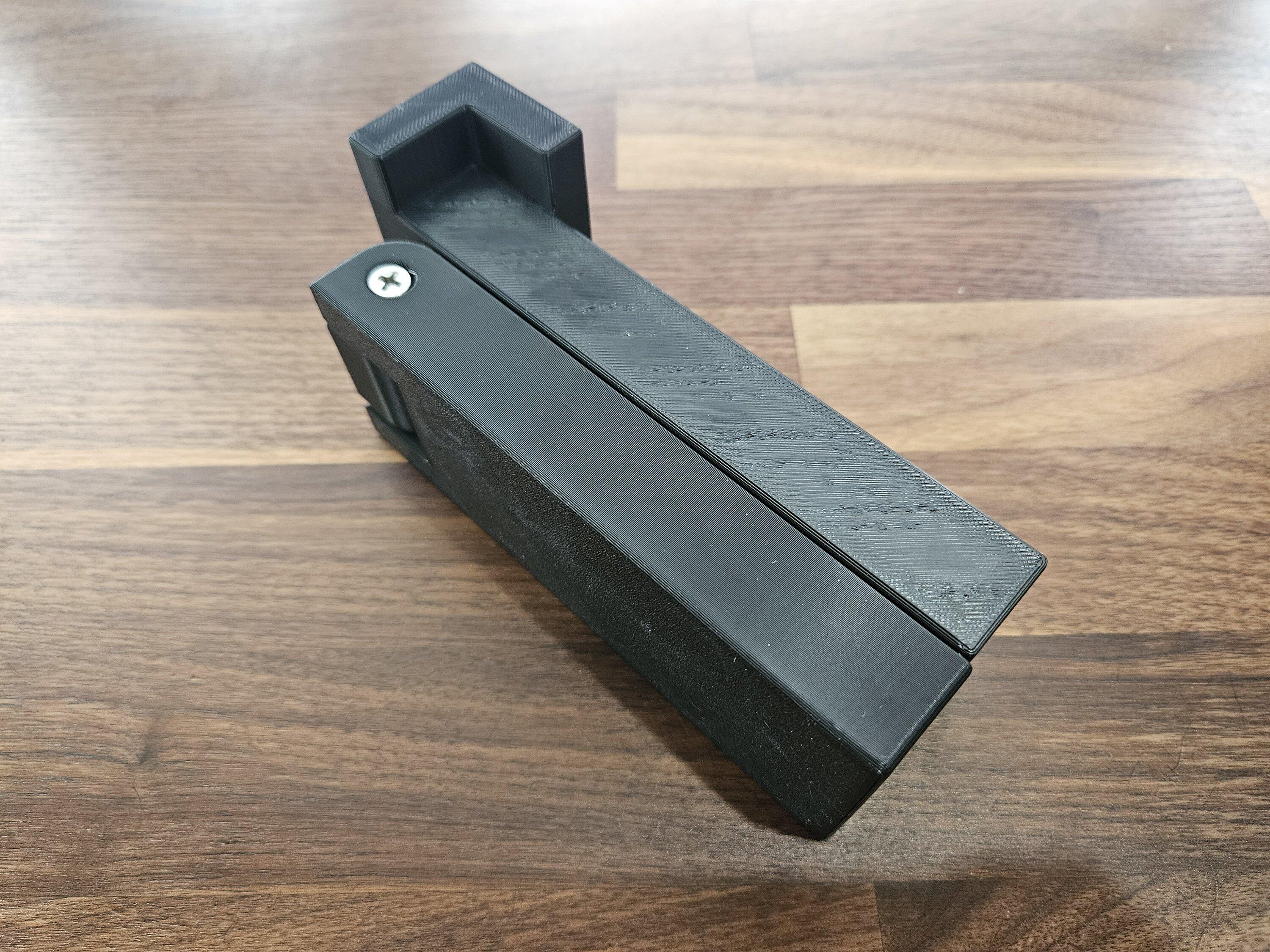

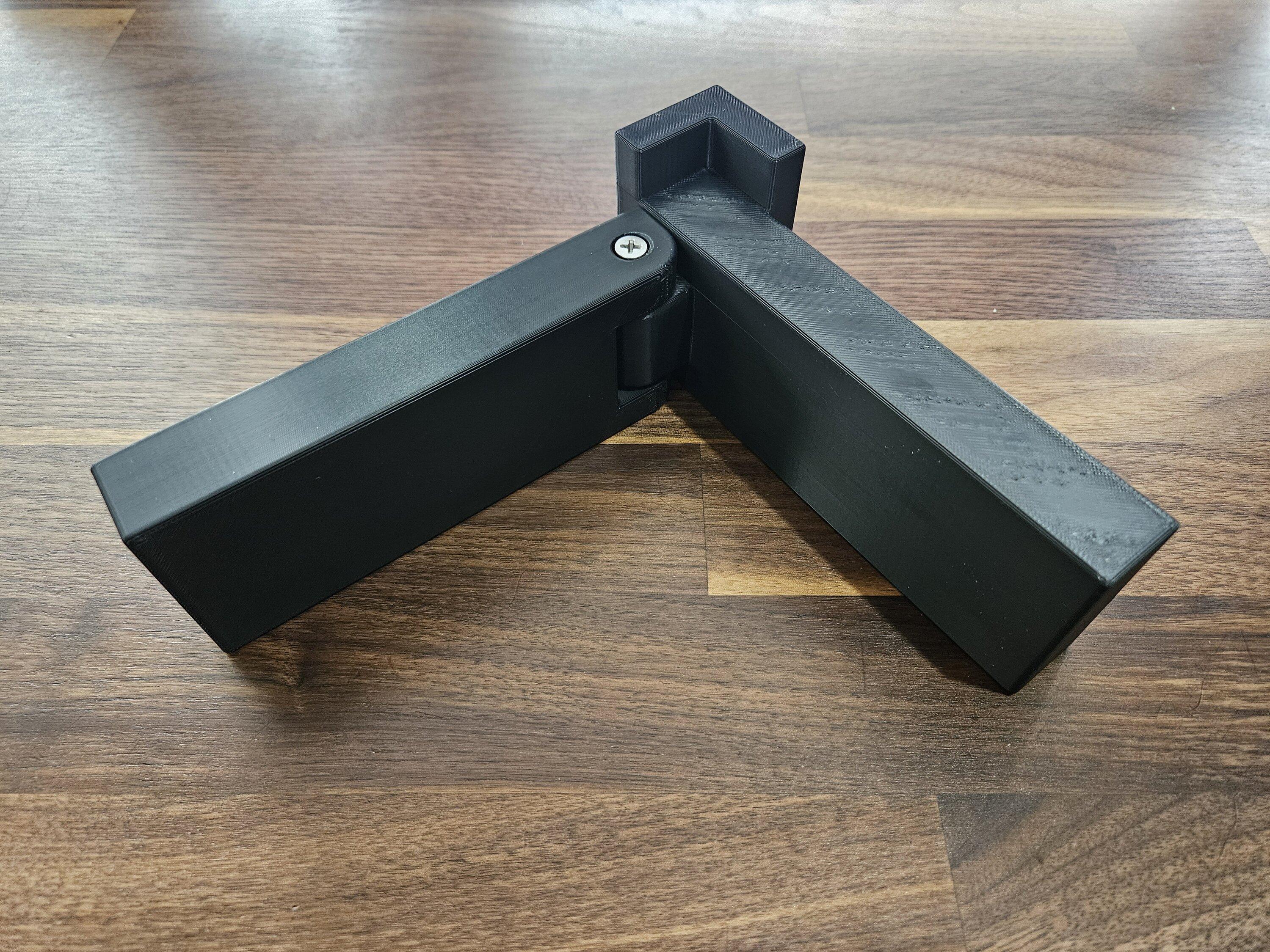

Quick update on my end - I've been working on the batch production version, and the first prototype is hot off the printer. My updates are likely going to consist of:
  1. Enable attachment via standard fasteners. The model as posted uses a friction fit pin.
  2. Tweaking the interface between the two corner parts to be a 1x2 setup instead of a 2x2 setup. This is done to make production easier (eliminates all off-plate supports) an allows for some clamping force with the fasteners. The goal is for this to stick open or closed and not flop.
First, I want to note that the model is excellent. Seriously, it's simple bit but extremely consistent. The angles are right, the filleting is quite well done. The curves allow for easy collapsing. It's also really substantial. Printed in ASA with appropriate wall count and infill, this thing should be tremendously durable.
As it stands, I'm dialing in the fastener bits. Both the geometry and finalizing exactly what hardware will be used. I'm thinking an M6 bolt is the optimal choice here, despite it being overkill. We're looking at a 55mm long bolt and it's also more available, even at a Lowes or Home Depot.
A few pictures. Please diregard the finish on top as it's a prototype only:
