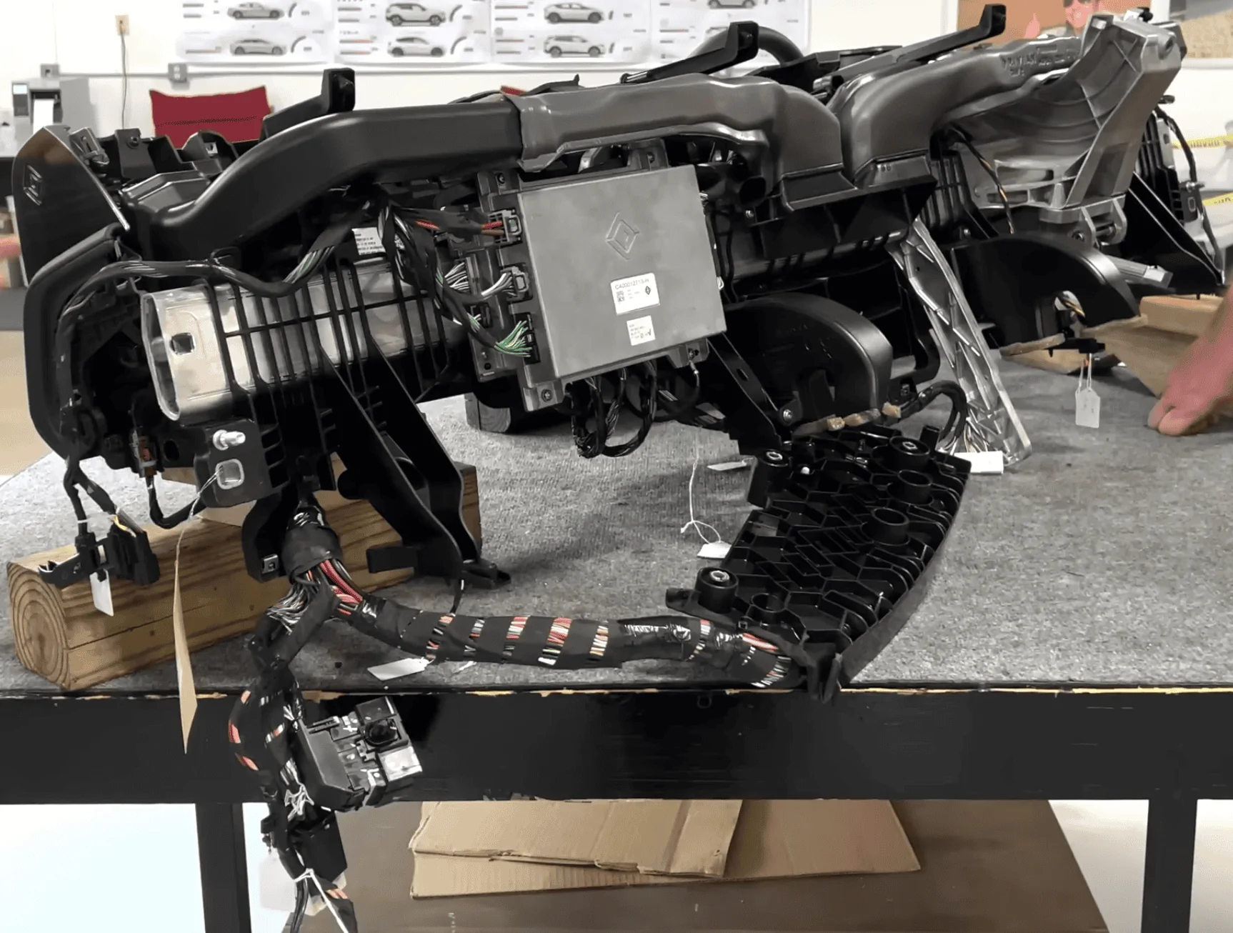

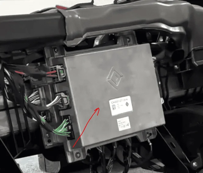

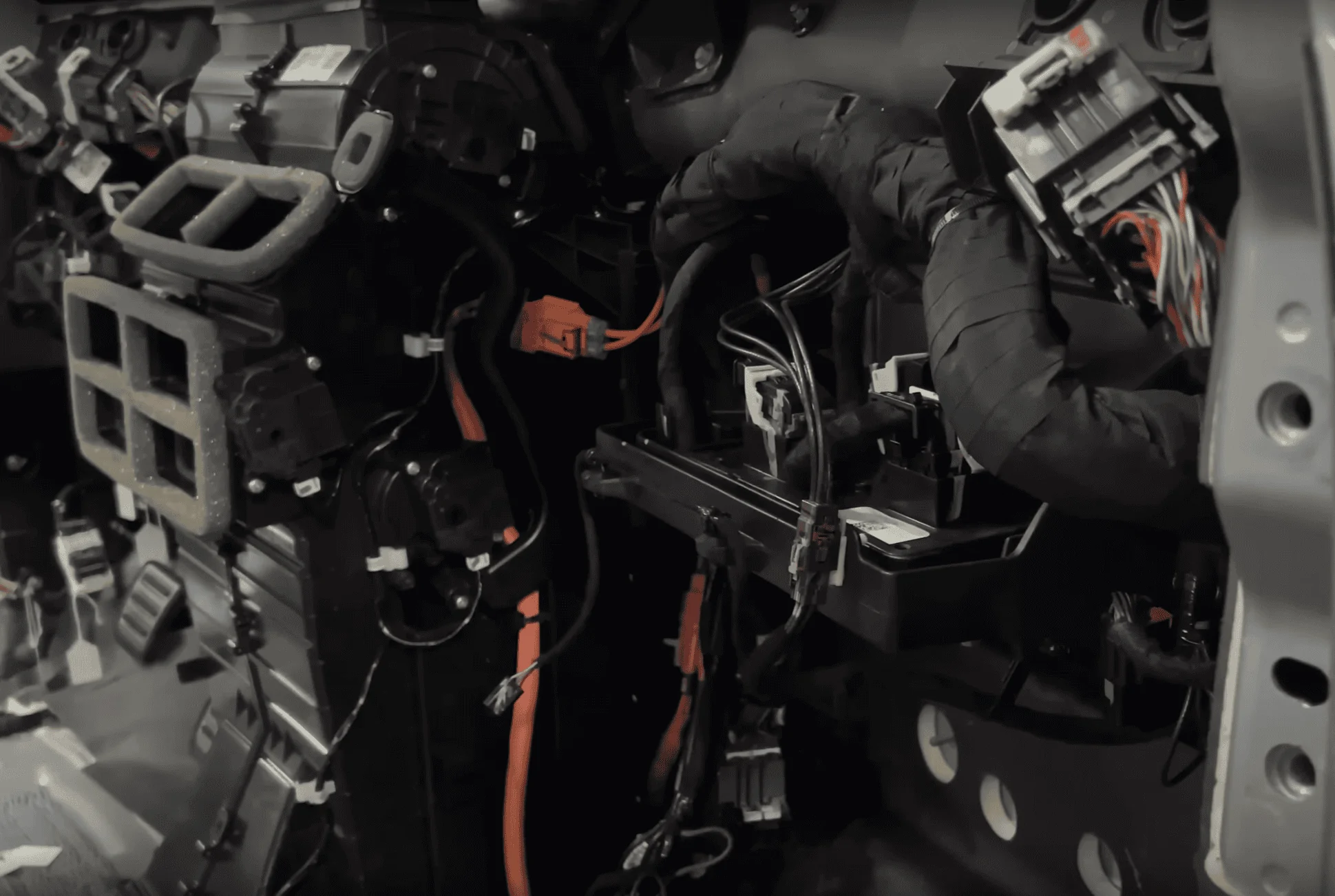

Does anyone know where the head unit is located and where the FM antenna lead plugs in?

So there is just a bunch of unused space where the glovebox could be.
The ICE computer is much deeper on the frunk side of the beam.
I wish Sandy showed removing of each piece. It looks like if the drive you write the video to get worn out and fail, it will be a pain to get to and replace. Unless you can get to it from frunk.

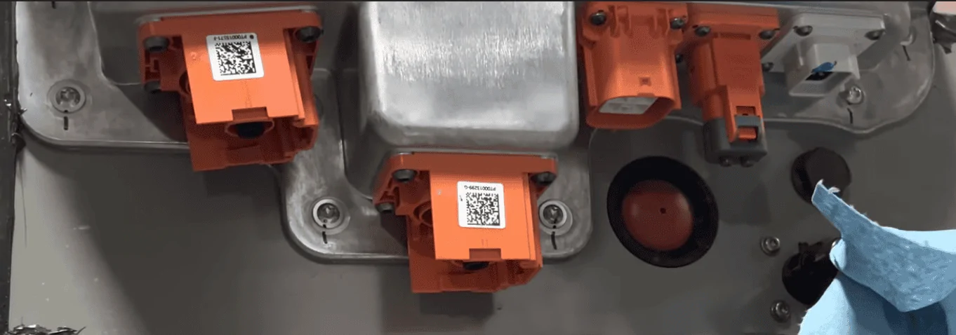

Love these shots. They are so good Rivian may ask for their removal. I am curious what do you guys think these components are?
I am guessing 3 may be the tank for air compressor. 2 looks like a motor for something but I am not sure what? is 1 tailgate release button?
Except for the lack of blue anodized color, that looks a lot like an ARB compressor. I wonder how hard it would be to swap it out for an ARB twin compressor. I'm also thinking that installing a larger air tank would be an interesting mod. Then you can tap that air tank for sustained air tool use.

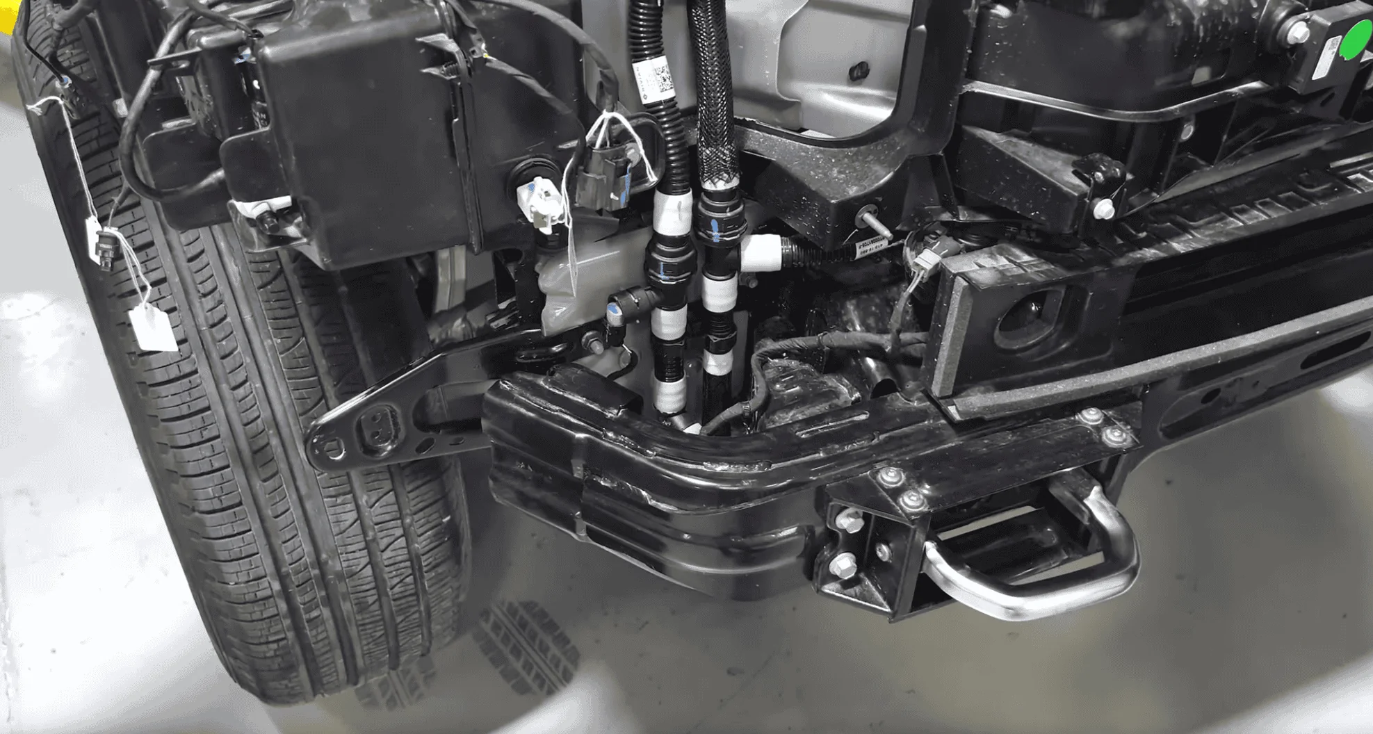

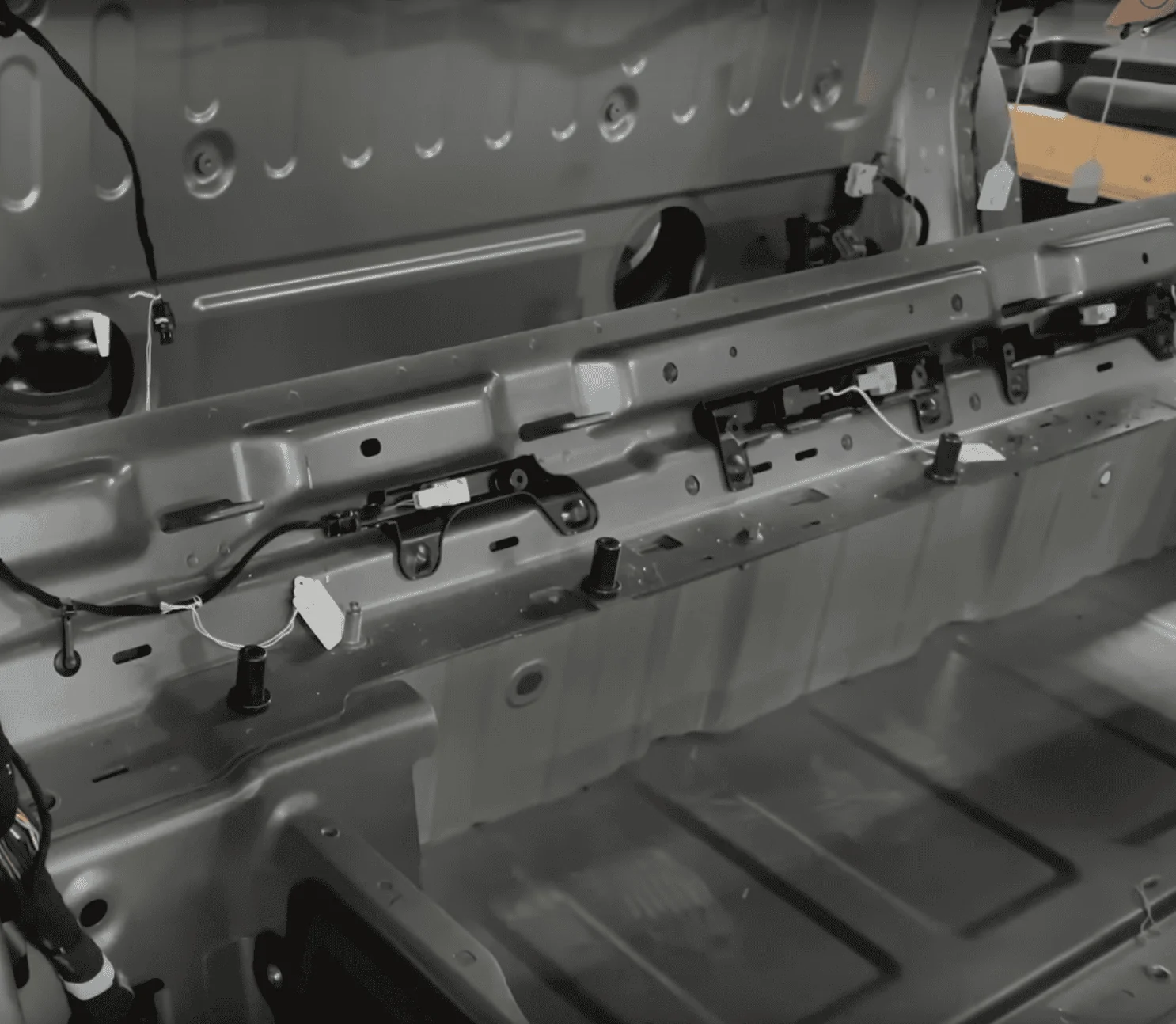

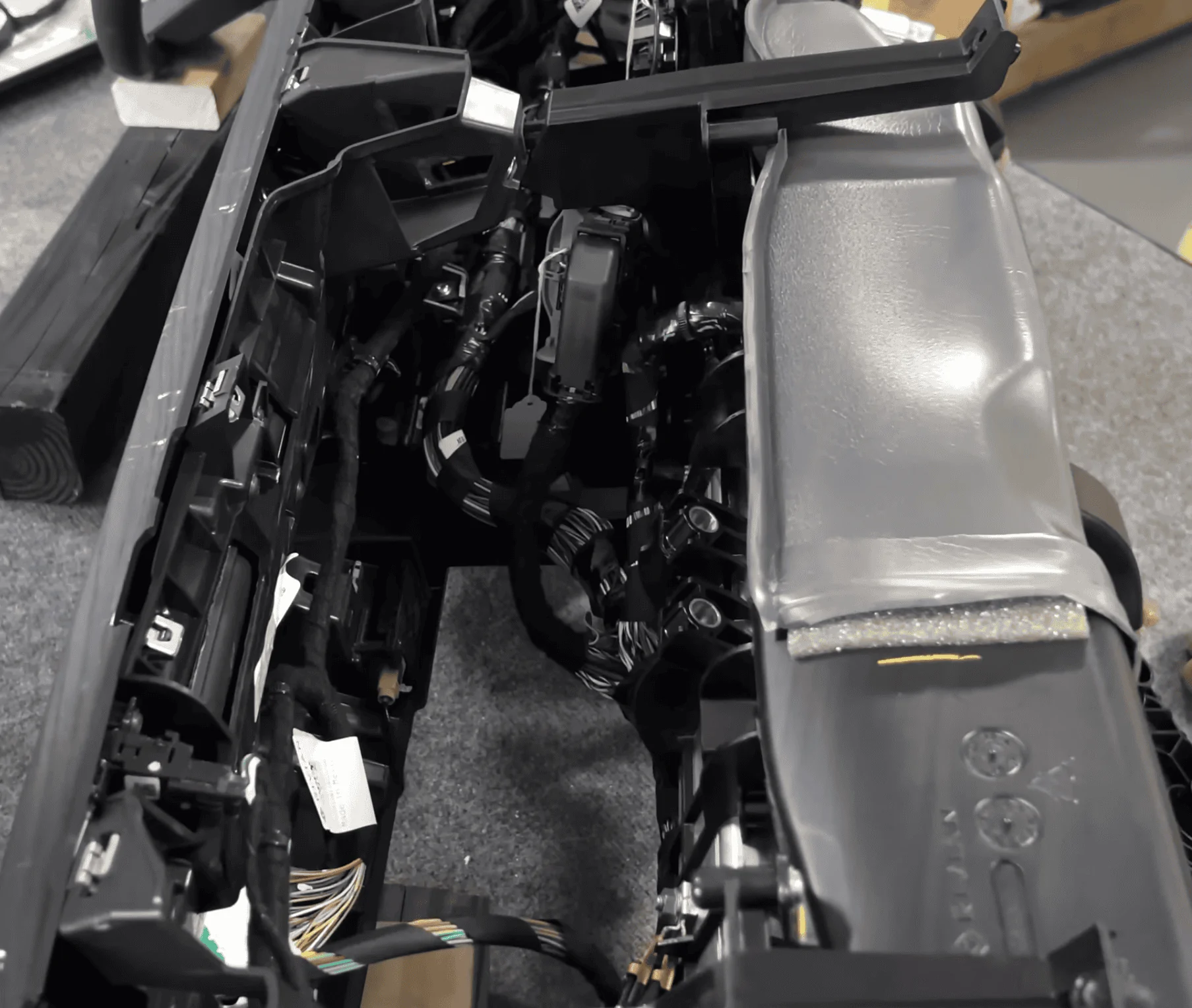

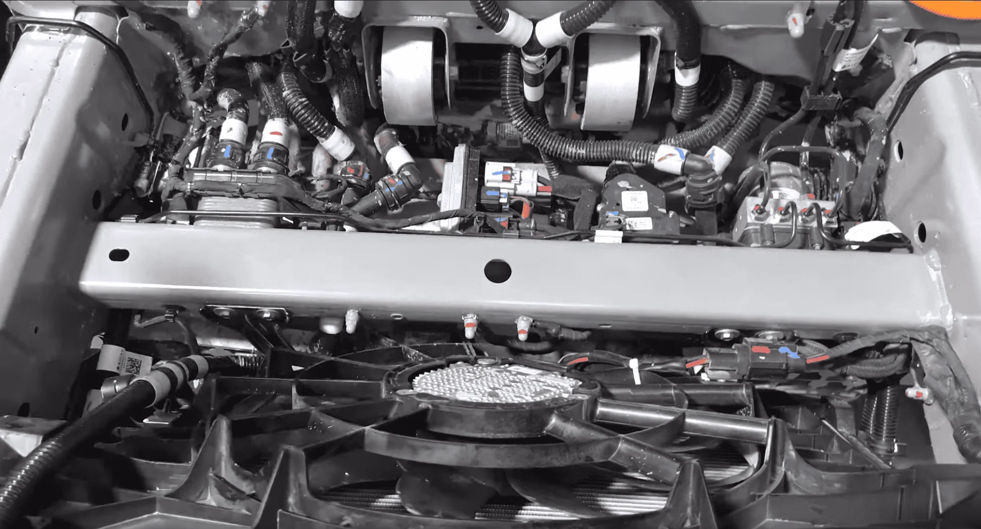

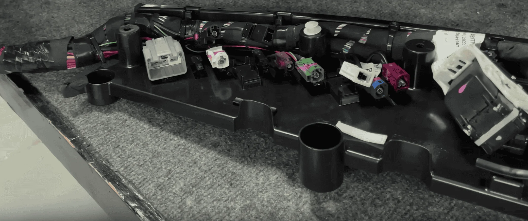

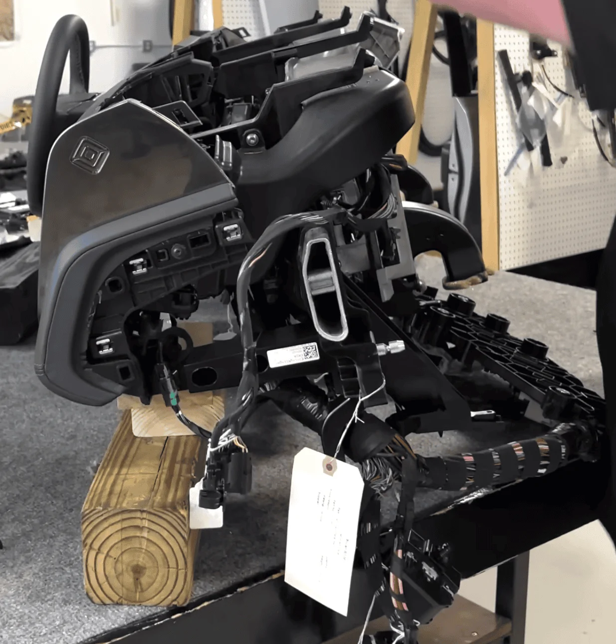

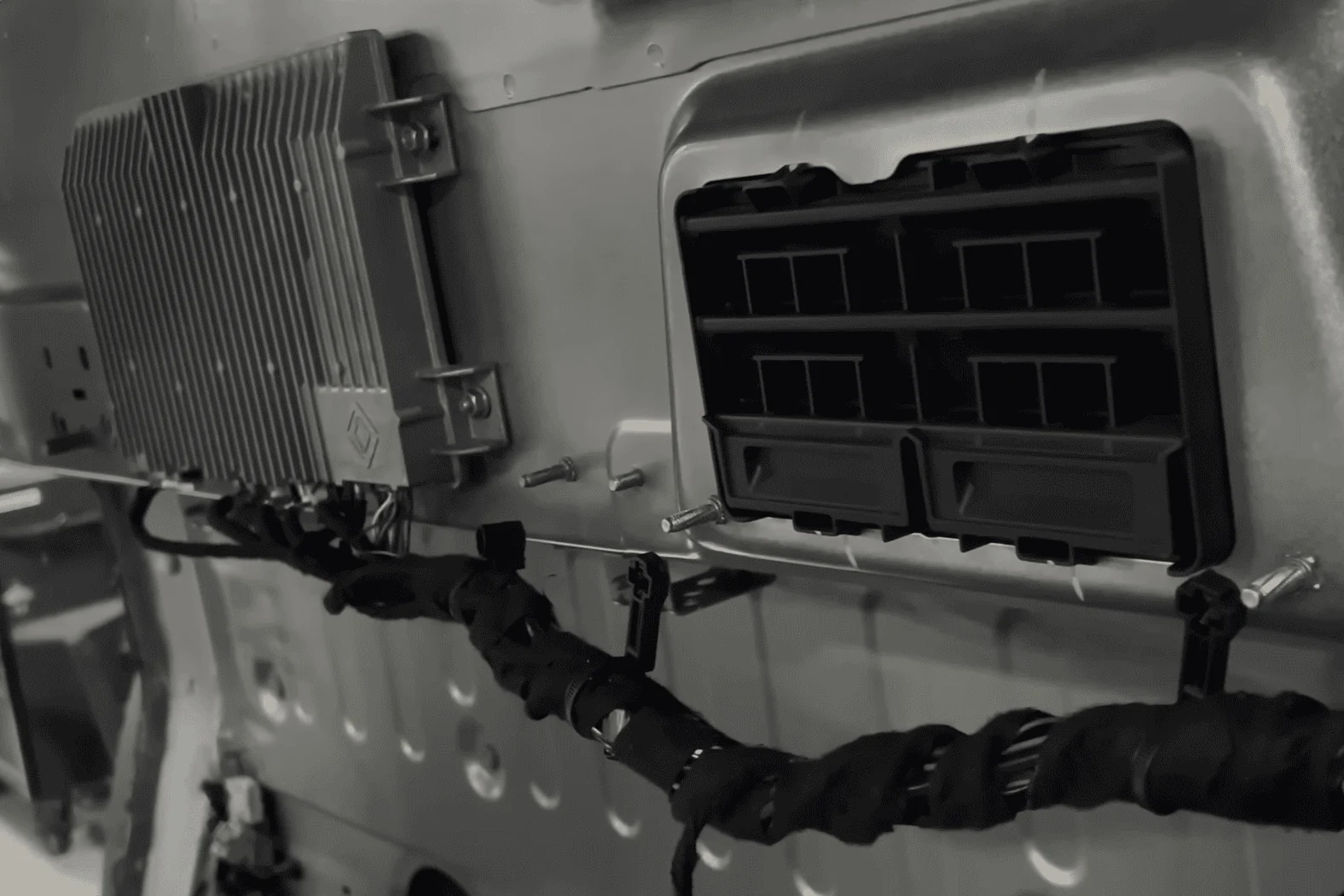

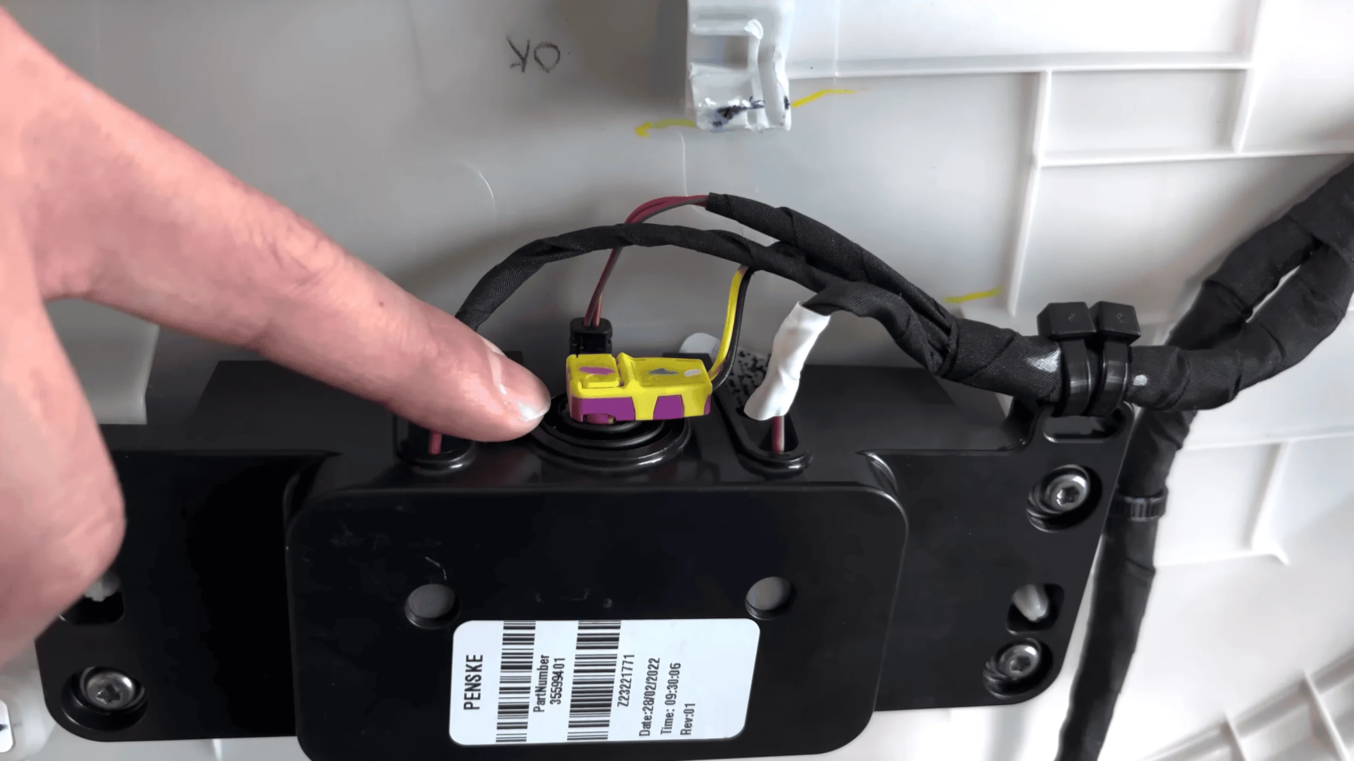

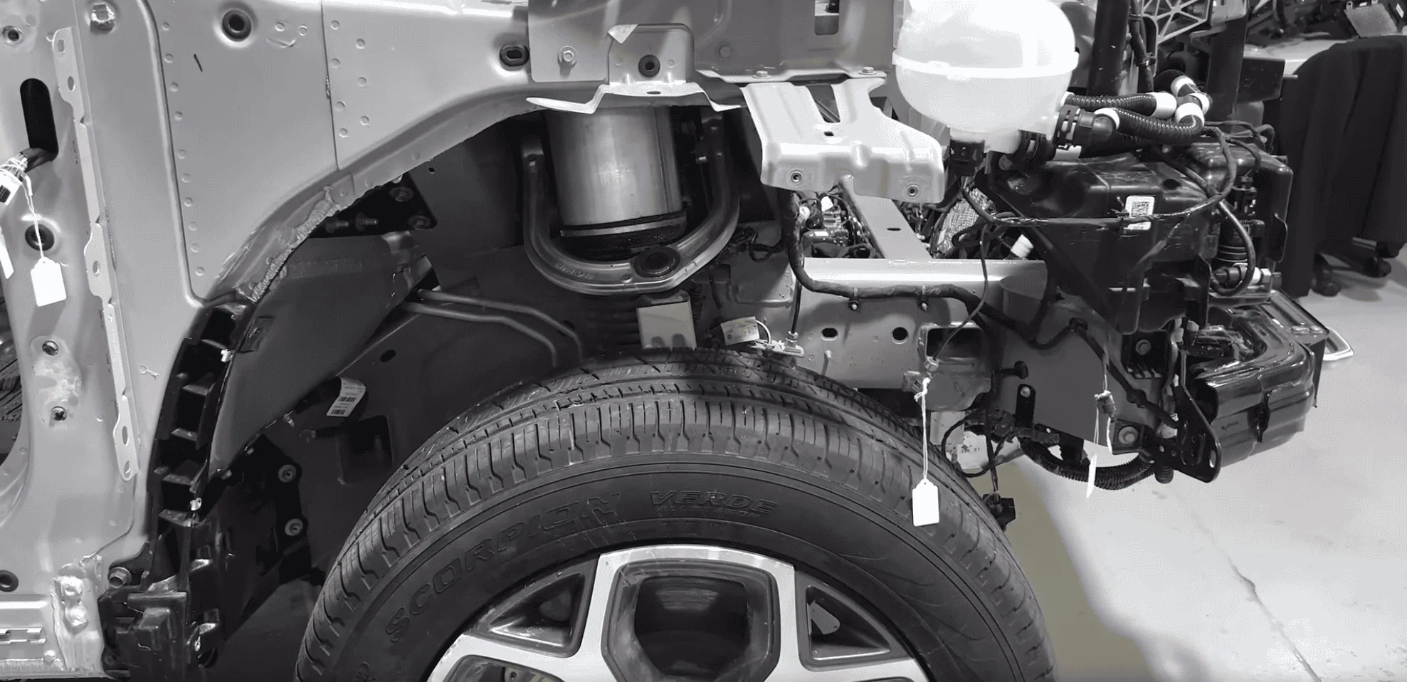

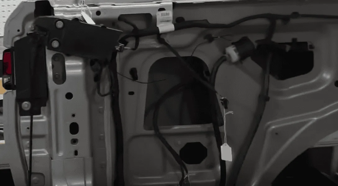

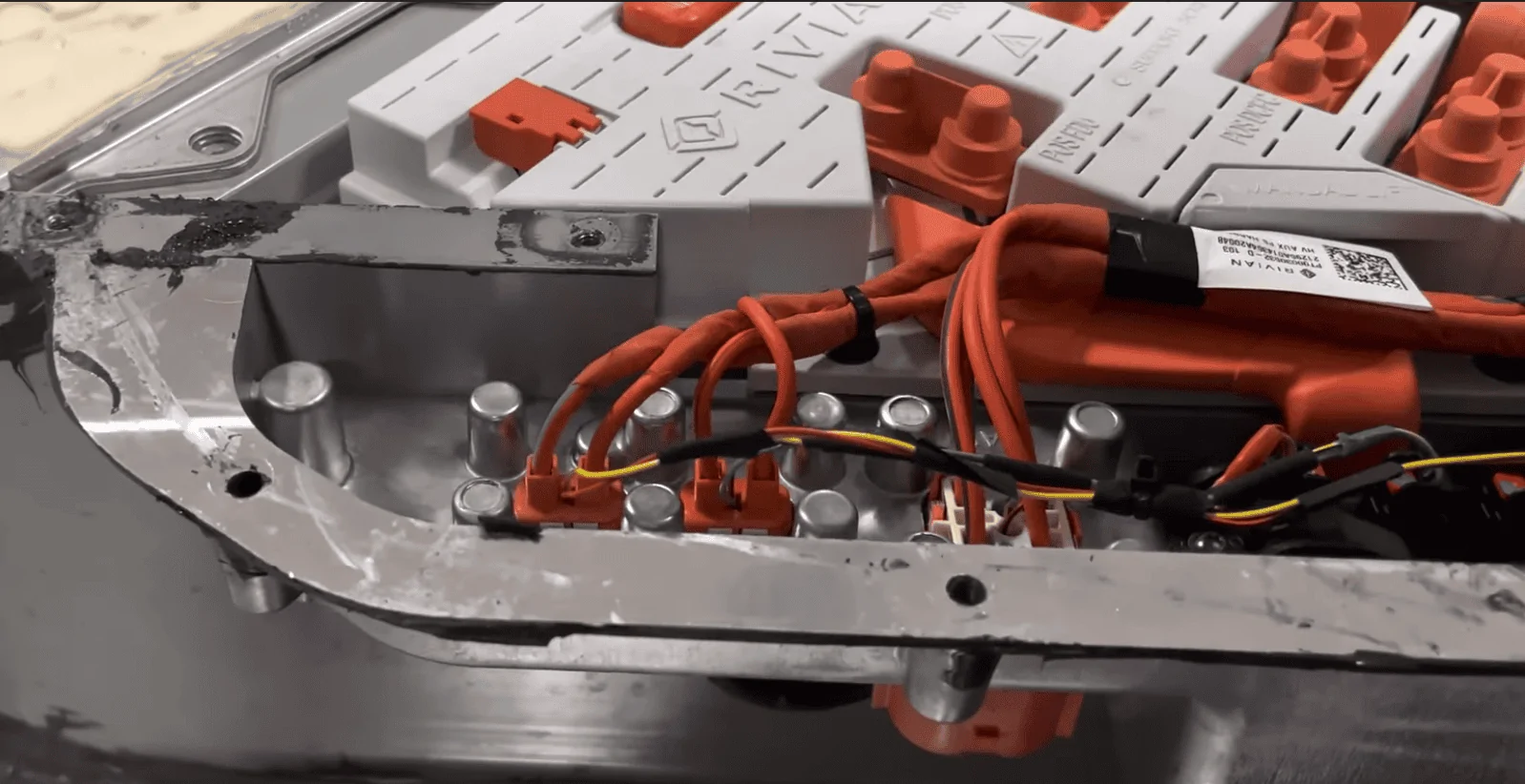

More from Sandy on Wire Harness:
On hinge pillars of body:
Rivian R1T R1S R1 Teardown 1655303463737
Rivian R1T R1S R1 Teardown 1655304291593
Rivian R1T R1S R1 Teardown 1655304874493

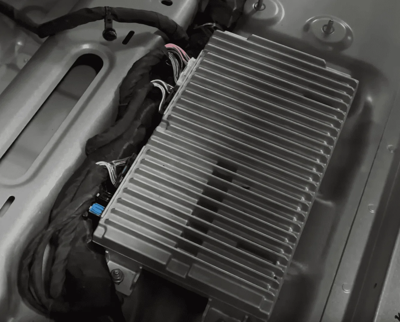

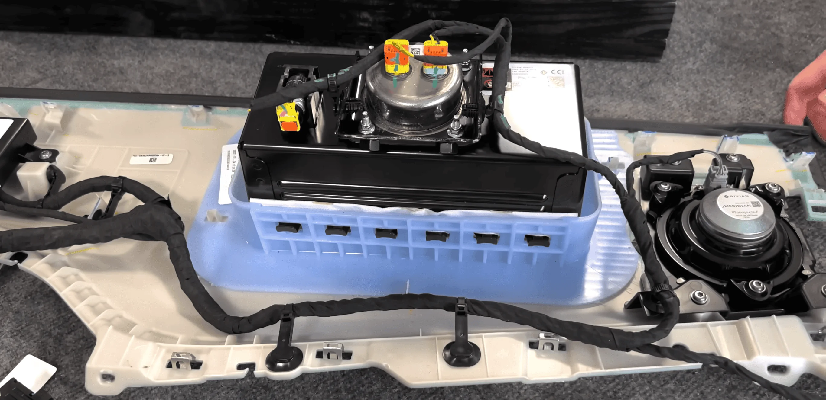

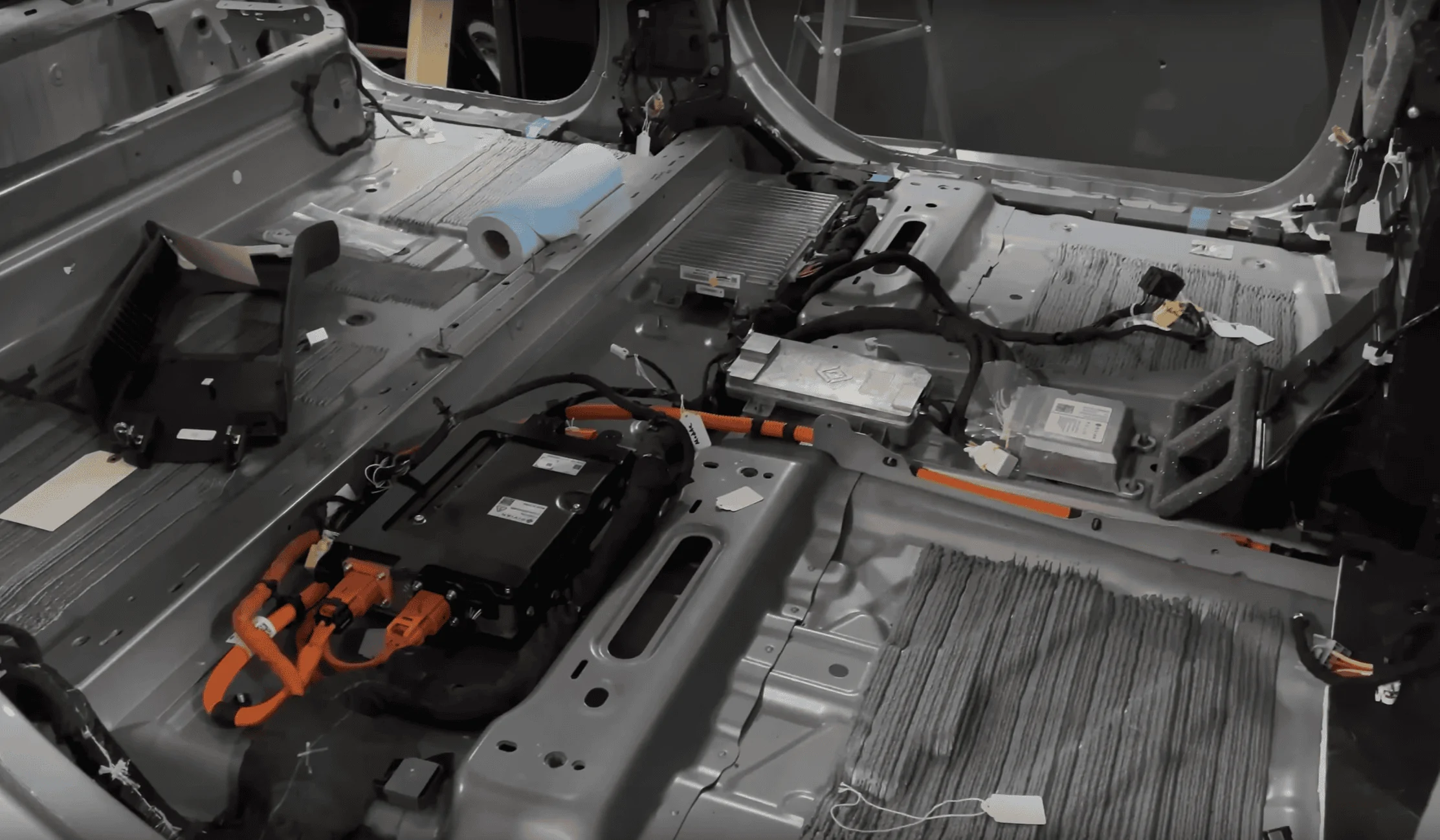

Amplifier close up on the floor:
Rivian R1T R1S R1 Teardown 1655305900670
Rivian R1T R1S R1 Teardown 1655305256348

passenger side:
Rivian R1T R1S R1 Teardown 1655304696236

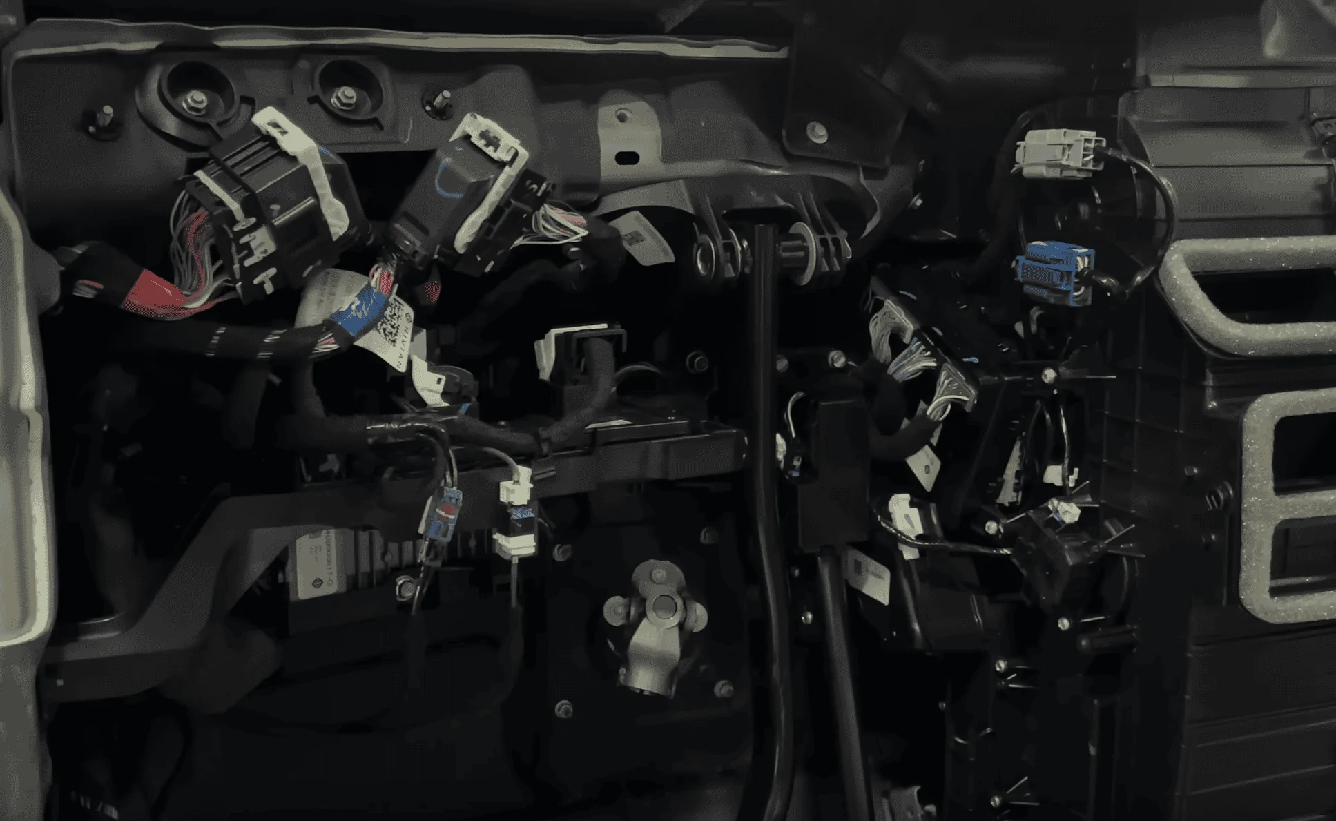

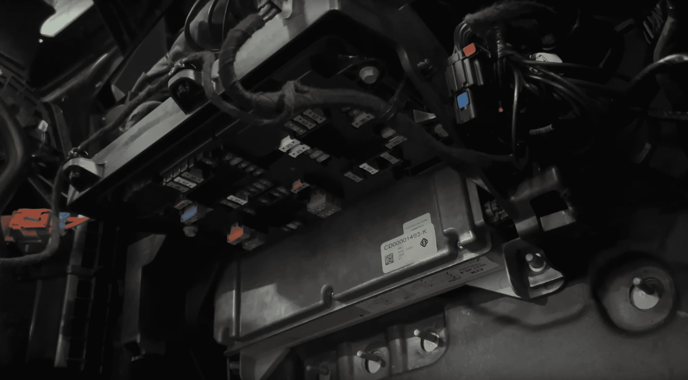

Fuse box under dash passenger side:
Rivian R1T R1S R1 Teardown 1655304623507
Driver Side:
Rivian R1T R1S R1 Teardown 1655305679014
Back of the bed, driver side
Rivian R1T R1S R1 Teardown 1655305356247

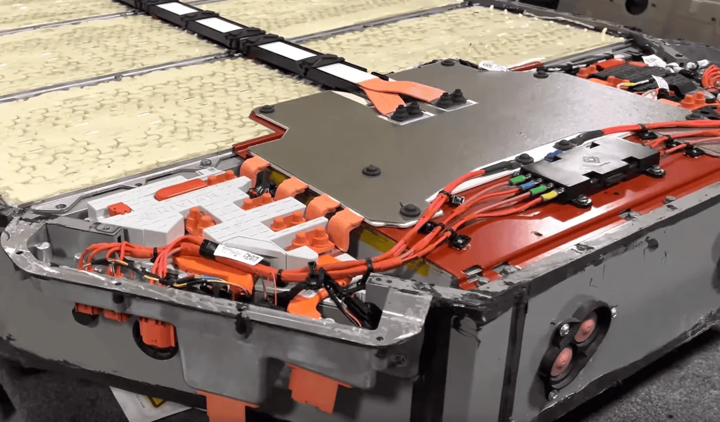

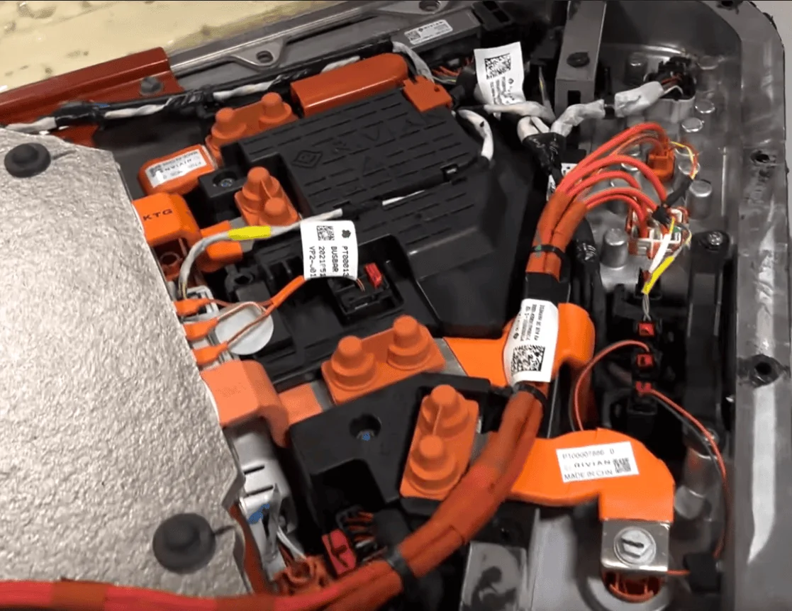

I am more concerned about pyro fuse that seems like much more difficult to get to. I have no idea how exactly it is triggered. Now I am afraid if I hit a speed bump the wrong way and that thing blows, it may have to be towed at least 150 miles away for disassembly. I don't know how to make sure it does not explode by accident, well, you know what I mean ;)
