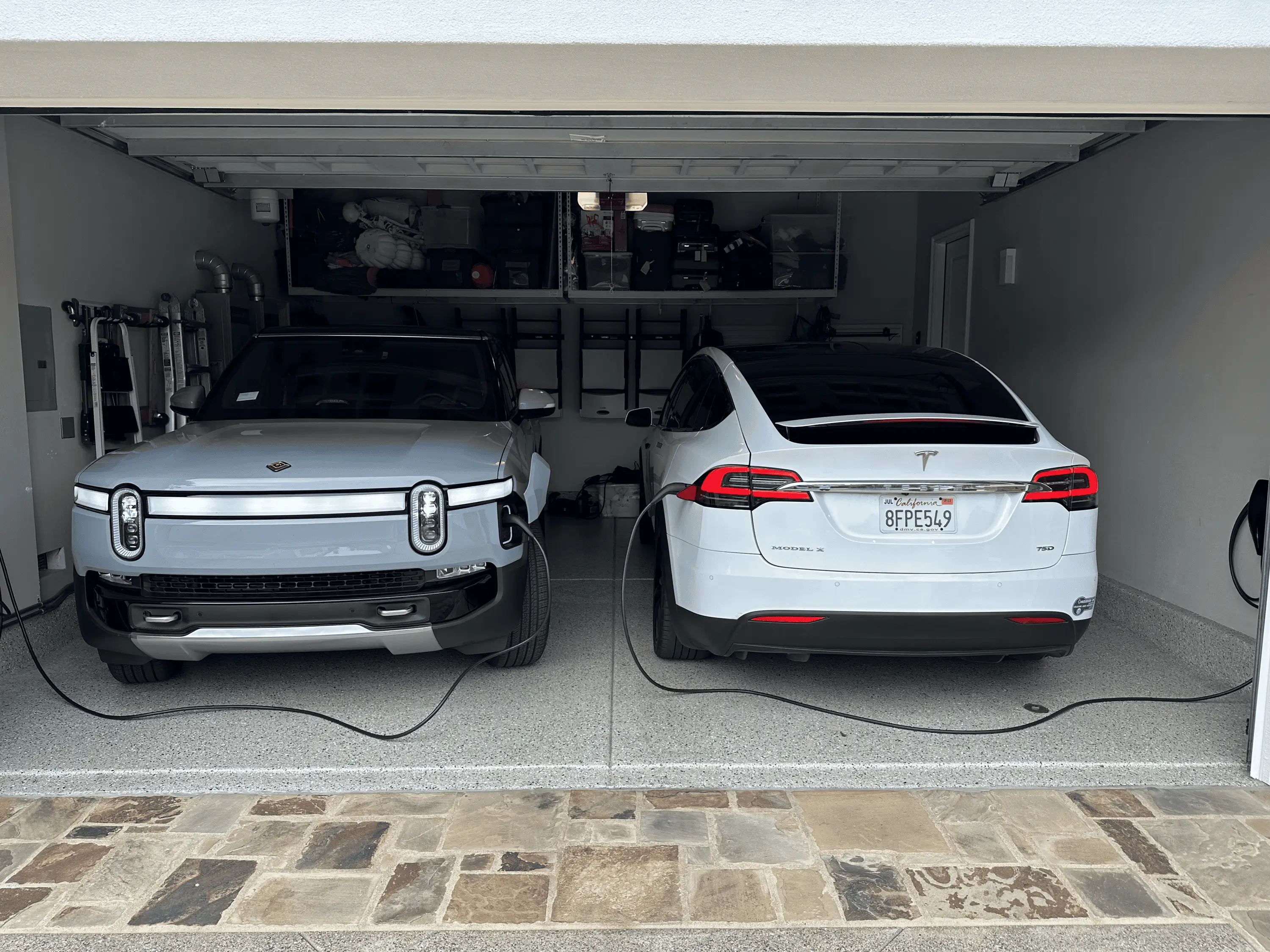

We had two teslas alternating between a single charger for years. Finally upgraded to the new Tesla J1772 wall connector and installed two of them on a single 60 amp breaker. They power share perfectly and I use the Tesla adapter from the J1772 to charge my wife car nightly. Now we plug both in each night. The adapter that comes with the Tesla is pretty solid and we have not had any issues

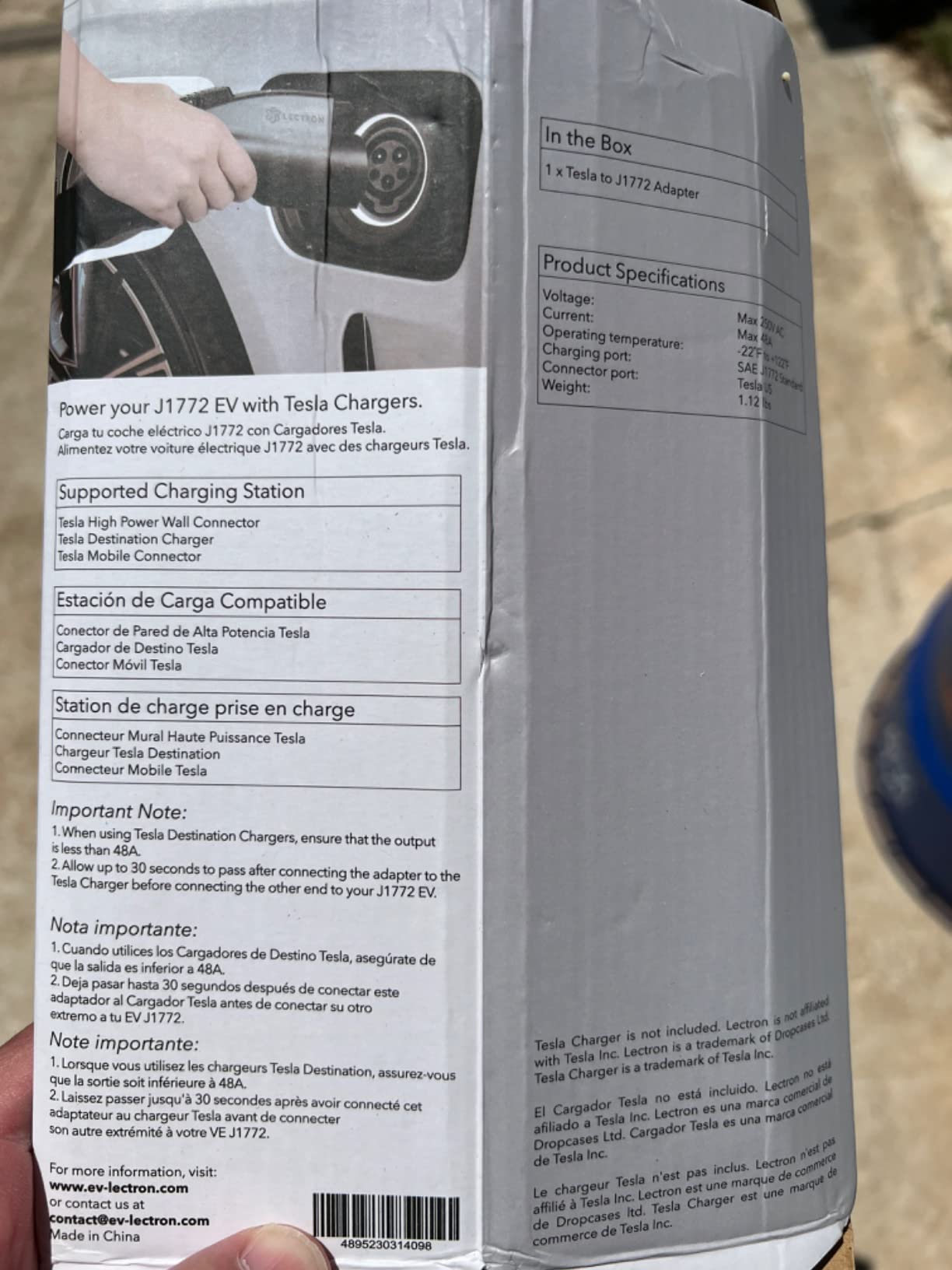

I'm skeptical the issue was caused by the lectron. Did the service center examine the lectron adapter and note something specific on the adaptor that was problematic? If not, they are probably just making a simple assumption. There are enough people that have used it without issue that I doubt there is a design flaw with the adapter. I do have the 48 amp compact lectron adapter that I bought for a road tip, but have not actually used it yet.
Generally speaking, electrical adapters and extensions are dangerous and should be careful to never exceed the amp rating. I would likely bump down the amps a bit below the rated amps (48 in this case) for any adapters/extensions just to be safe. However, I'm not concerned when I eventually use this adapter at 48amps for short durations and slightly lower amps for longer durations. I'm also looking at eventually getting the lectron J1772 extension cable, but would likely bump it down to ~32 amps for over night charging when speeds are not needed.
Update:
Was just looking on Amazon and noticed a picture of the box states "ensure that the output is less than 48A." I'm surprised it doesn't say "less than or equal to 48A" which is it's stated rating. I'd reduce the amps when using this or any adapter...

The Lectron (1 piece) us unlikely UL rated. The Amazon listing says this - "Rest assured that the Lectron Tesla to J1772 adapter is safe and reliable, having undergone UL testing for your peace of mind"... but I can't find any other documentation or markings to support this. They are now using a SGS mark in their product images. More info needed there, but seemingly positive.
OP - What amperage were you charging out? I'd suggest lowering the max amperage via vehicle settings when using the Lectron adapter.

I would imagine a lot of people using this setup out there without issue. I would error on a single faulty Lectron adapter before saying they are all bad in this configuration.

She drives the X and mine is R1S. She is debating her next car so we installed two of the J1772 chargers so we have options outside Tesla. you can install multiple on one 60 amp breaker to power share
Update:
Yes, the tech inspected the adapter and the charger (he use to work for Tesla). Charger was fine, but the adaptor had a tarnished color to it and and the ohms doubled when adding the Lectron adapter showing the increased resistance.
