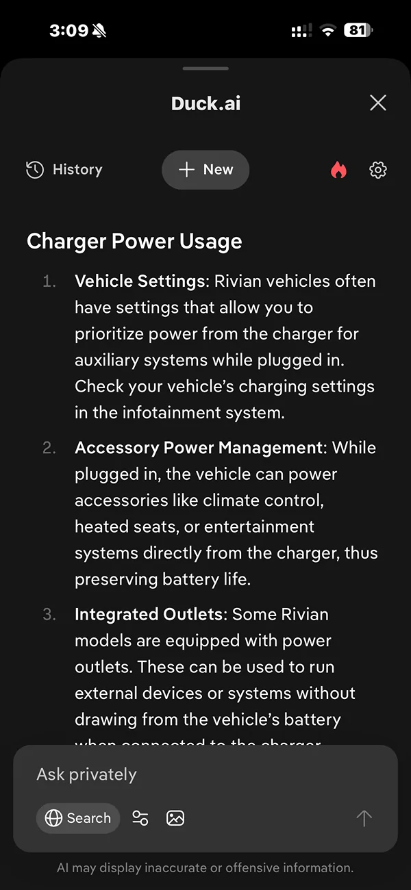

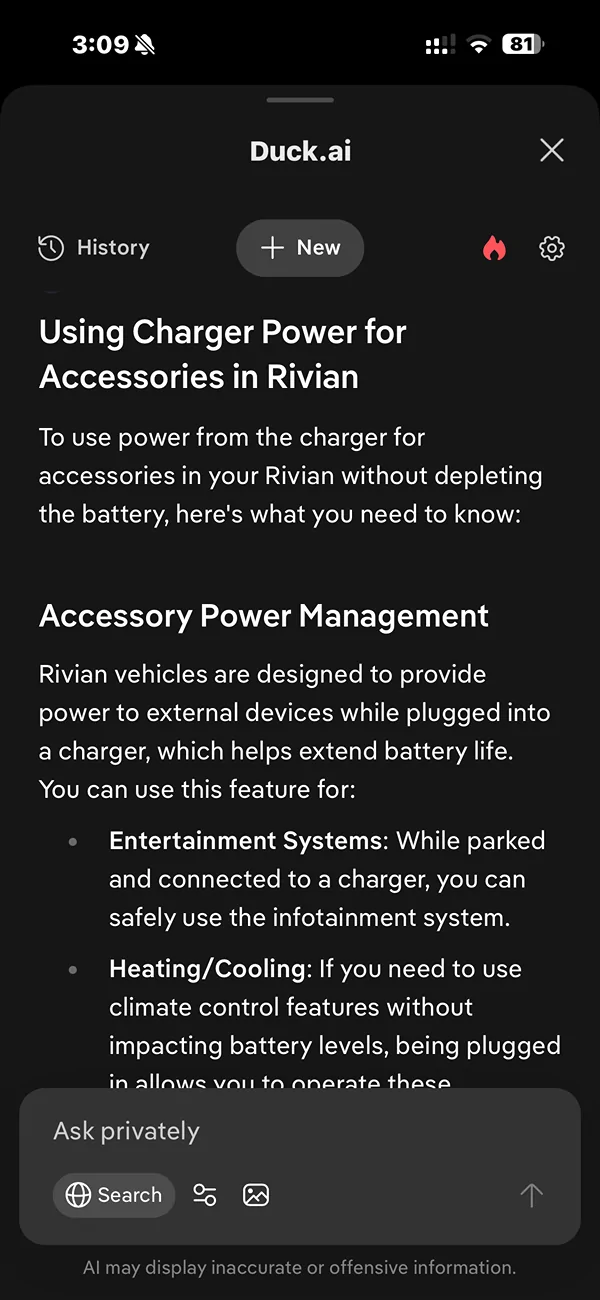

LOL, if you want to believe an AI go right ahead. But then why bother asking real people like us?
There's only one charging circuit, which goes directly into the HV battery. There's no HV battery bypass that would allow the wall charger to power the 120V outlet directly.
