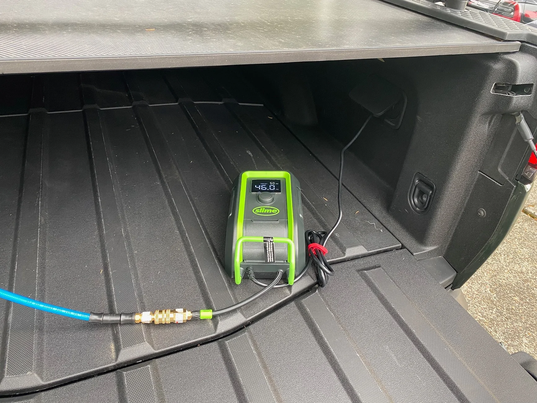

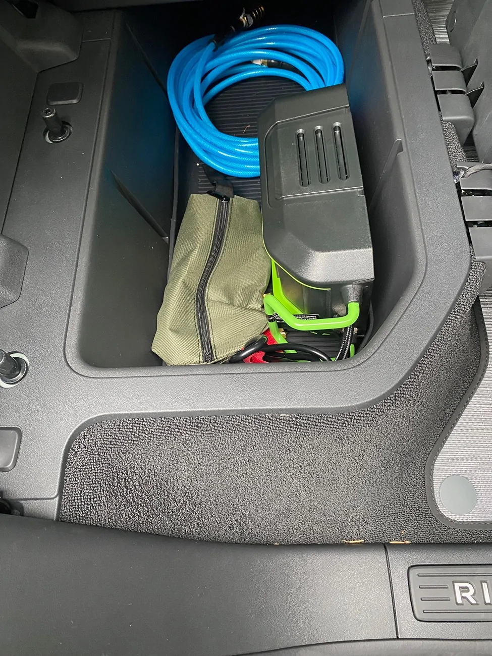

I got the Slime 40082 120v inflator for around $80 for my R1T Gen 2. There is only the one 12v outlet in the gear tunnel and it is fairly low amps. You aren't going to connect straight to the 12v battery which is what many of the higher amp 12v inflators require. I looked at adding an ARB (or Vevor) on board air unit but there is the same 12v amp problem. What we do have are multiple 120v outlets.
The Slime unit gets poor reviews but they are almost all regarding the hose and chuck. It comes shipped with the hose detached. I got a Schrader to 1/4" NPT fitting (male-male) and put a regular female quick release air fitting on the end of the whip from the unit. Then a regular air hose and chuck. The unit fits nicely in the rear under seat storage compartment. It is fairly quiet and has worked well. So far I have not inflated a tire from flat but did inflate all my tires from 33 to 49 psi and it worked fine.
Rivian R1T R1S Portable tire pump? IMG_0141
Rivian R1T R1S Portable tire pump? IMG_0144
