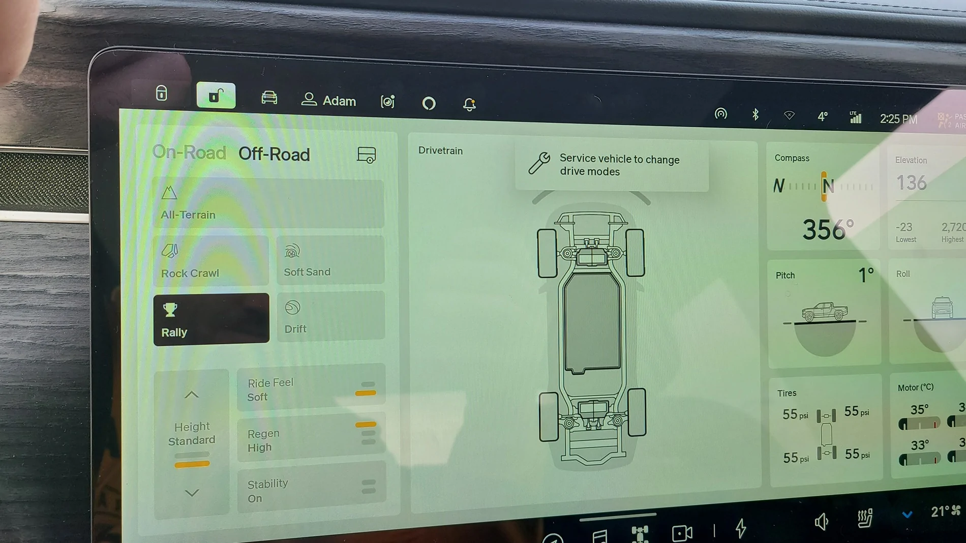

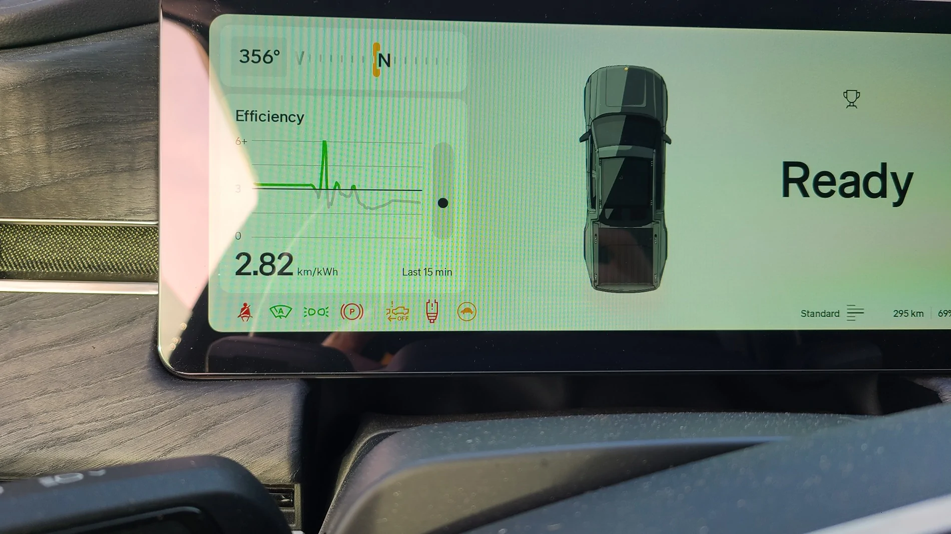

I had a suspension issue which got worse over a few weeks. There were minor signs, and I ignored my inner voice on taking it in. Would partially dive toward the front passenger side going over expansion gaps on bridges, and pull slightly to that side on rebound.
Anyway, was in rock crawl mode going though some snow, and suspension faulted a couple minutes after raising it. Was confined to 31km/hr, but fortunately could coast down the hill faster šŸ˜‰.
After several resets, was able to quickly change from highest into Rally mode/normal suspension height, before the fault prevented it. Then a 45 minute sleep cycle allowed me to at least drive max 85km/hr, and was able to drive the 50km to the service centre.
Rivian R1T R1S Poll: Has your Rivian ever turtled? 20241231_142507
Rivian R1T R1S Poll: Has your Rivian ever turtled? 20241231_142451
I don't recommend driving a Rivian at speed with all the dampers and hydraulic sway bar defaulted to wide open. If you do, make sure you make driving inputs like you have Jessica Tandy in the back seat.
Front damper had a blown seal? Rivian took it in January 2nd and had it repaired in a day or two? 100% whole again.
So turtle mode is borderline a check engine light, once the issue is resolved, icon goes away. So don't give it much thought.
