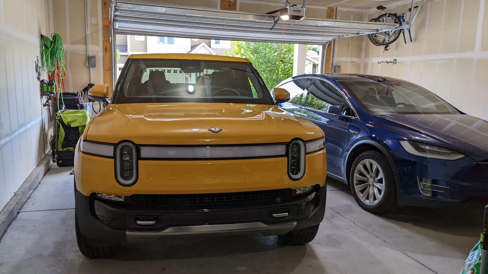

Congrats on your truck but WHERE is the picture? You gotta show us the goods brother!

Sorry! I'm in Atlanta now so wife ran out for me.
You had an illusive Compass Yellow and you were holding out on us?!
Congrats, man. That's a sharp looking R1T!
