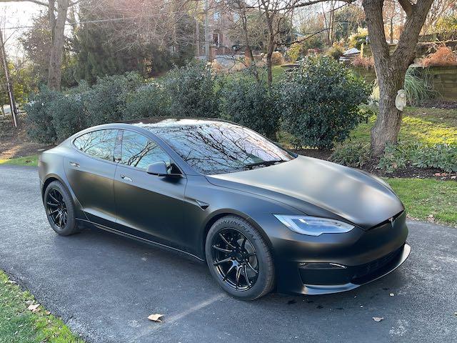

Xpel Stealth with ceramic on the Xpel is what I went with on my 2021 Model S. 70% tint on windows. You could certainly go darker with the tint. I used Detail Authority in Fairfax VA. Excellent work. I plan to do this on my R1T in LA Silver, or whatever color I end up with.
Rivian R1T R1S Paint Care Protection Thread TMS Stealth Wra
