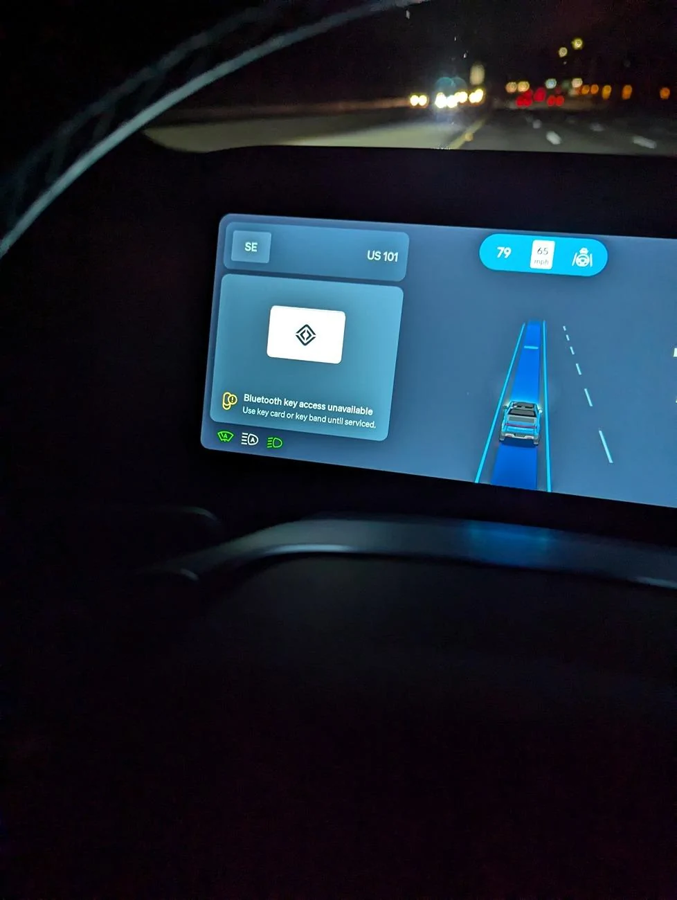

Yes! After updating to 2024.43 on Monday, I got a Bluetooth /key warning message while driving to work... Then when attempting to leave work, no keys were recognized. I had three keys: phone, card, band (no fob). None of them were recognized, and I spent about 45 minutes trying to get them to work. Soft reset, hard reset, restart phone, etc. Rivian service sent some sort of wake up signal which instantly revived the vehicle, and allowed me to drive home. Although at about the same distance on that second drive since the update, I got the same Bluetooth warning. Hoping I will be able to drive the truck on Tuesday...
Rivian R1T R1S Paak not working after latest update? PXL_20241203_044300216
