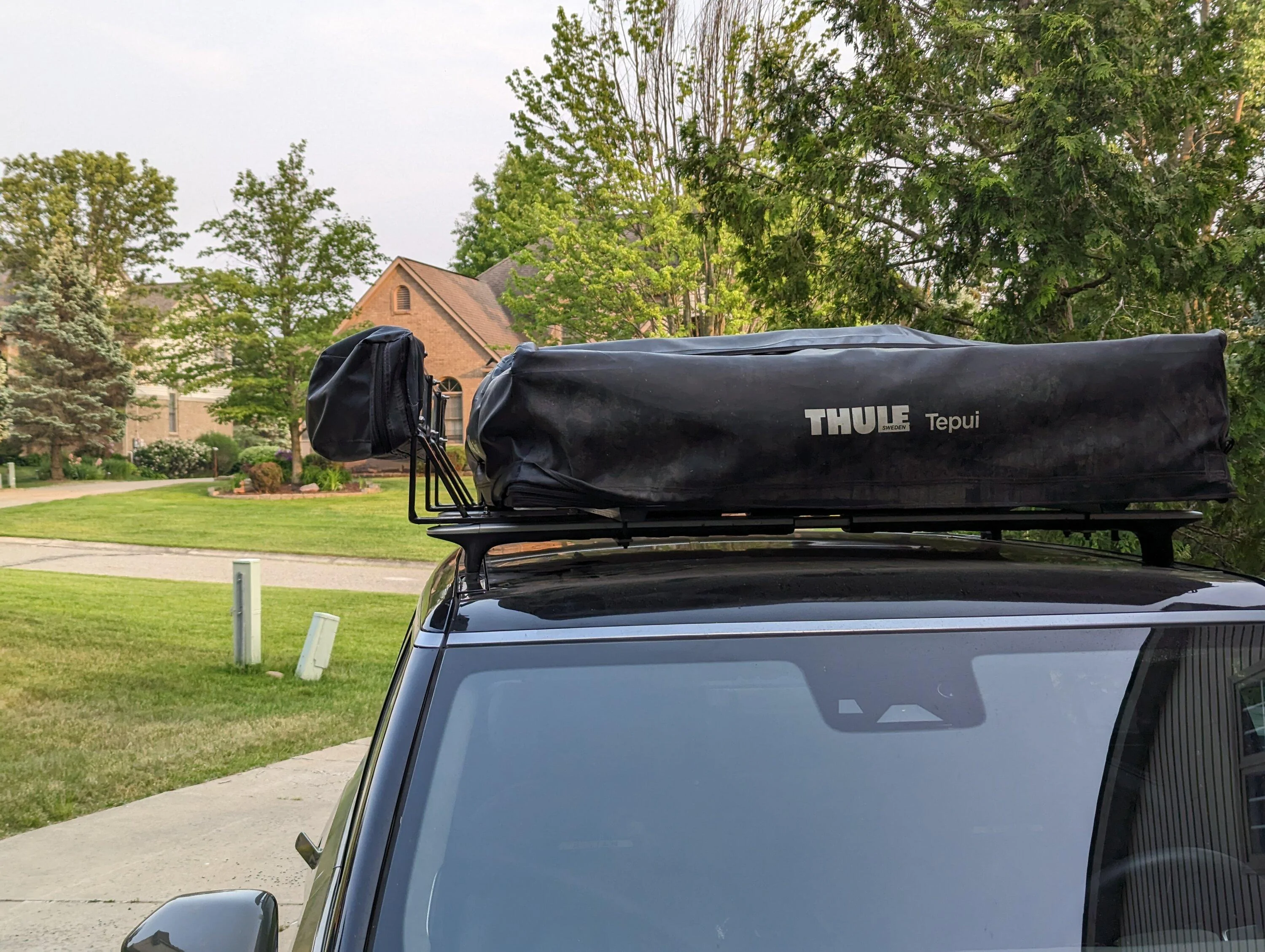

Is the awning higher than the tent when everything is closed up?
Thought I had posted this too. There's a mattress we stuff into the tent that's not in there currently. It's pretty close to the same height overall with the ladder under the tent. I was planning on repacking the tent tonight and putting the brackets back up, I'll take some more pics with a focus on height and measure it out from the ground as well.
Rivian R1T R1S Overland Systems 270 degree awning installed PXL_20230603_170030614

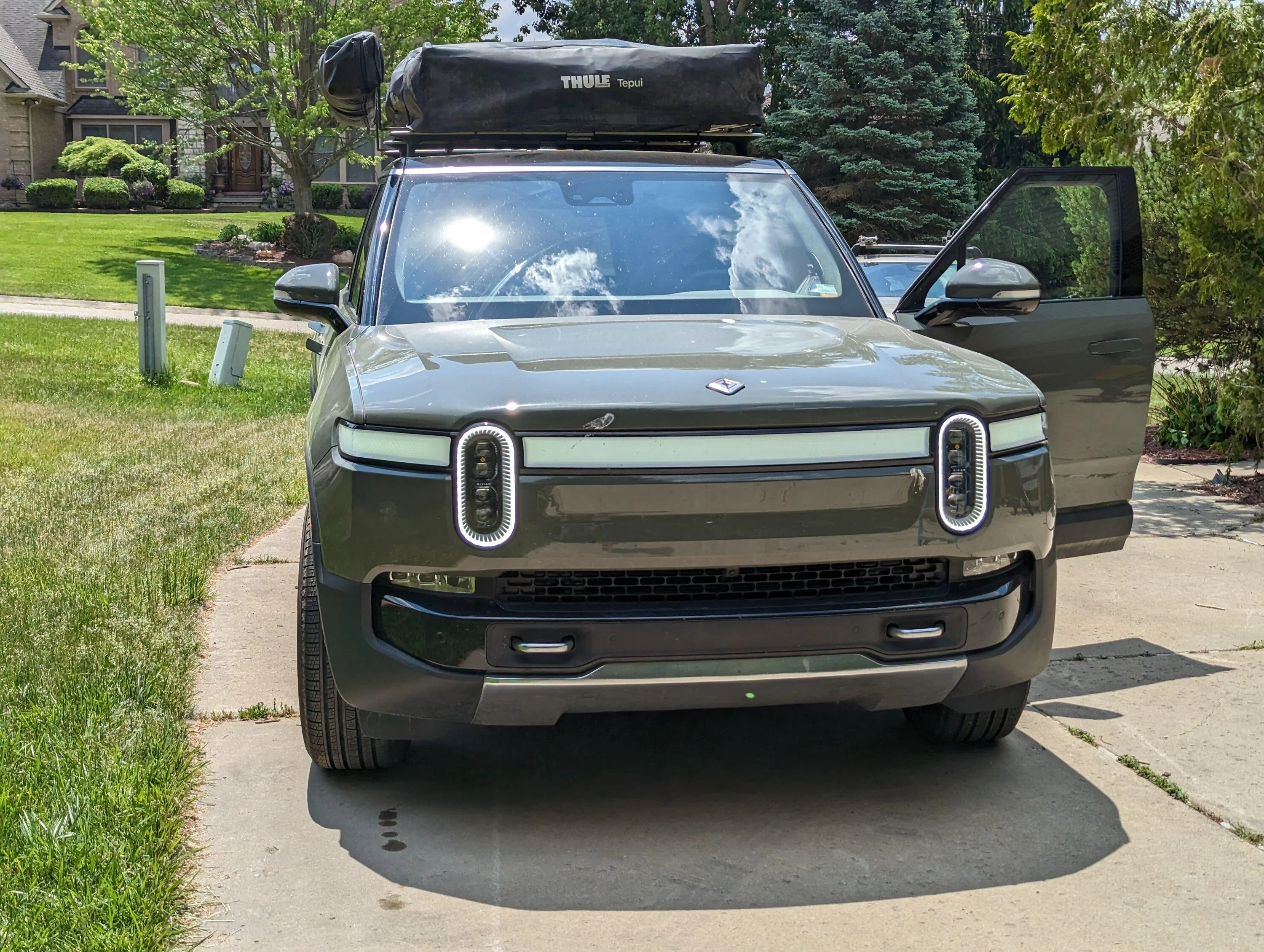

Fought with the brackets a lot to get the awning up on three of them. After welding the cross brace in, there ended up being enough variation to make things difficult. Not worth making a jig for three only brackets though. I intentionally put about 1.5 degrees tilt in the brackets because the roof rails tend to have that slight bow to them. When I had it on my truck the ends tended to sag down a bit. Will see how it works out.
Still need to re-stuff the tent. In lowest suspension mode the highest part of the awning is about 7'3" off the ground.
Rivian R1T R1S Overland Systems 270 degree awning installed PXL_20230606_000559470
