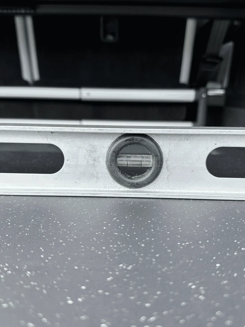

It's level left to right
Rivian R1T R1S [Update: Travel Kitchen worked great in first use] Travel Kitchen installed, but not level front to back on R1S 1724192458983-32

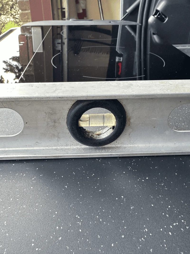

However, it is really sloped from the rear towards the front of the R1S
Rivian R1T R1S [Update: Travel Kitchen worked great in first use] Travel Kitchen installed, but not level front to back on R1S 1724192630716-bl

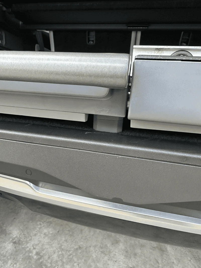

Stability Foot "deployed"
Rivian R1T R1S [Update: Travel Kitchen worked great in first use] Travel Kitchen installed, but not level front to back on R1S 1724192679590-i2
What am I missing? Anyone else have the same issue?

Is the tailgate level without the kitchen on it? Is the tailgate level when you sit on it?
Rather than this being a problem with the kitchen or with the vehicle's ability to level itself, I would not be surprised at all if the tailgate is just not parallel with the vehicle's frame.
My tailgate quite clearly moves when I put weight on it. Only one cable is taught initially, but both sides become tight when weight is added. So weight is causing it to twist. If my tailgate was perfectly level with no weight on it, then it definitely would not be after putting something on it. I complained to Rivian, they say it's normal.

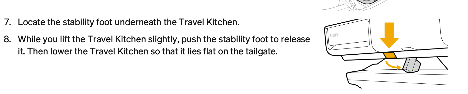

I have no idea as I don't have my overpriced kitchen yet, but from looking at the manual, can you adjust the stability foot to make it level?
Rivian [Update: Travel Kitchen worked great in first use] Travel Kitchen installed, but not level front to back on R1S {filename}
https://assets.rivian.com/2md5qhoea...5dc77/travel-kitchen-guide-en-us-20240808.pdf
Played around with it quite a bit but no real adjustability

The car is level at the door sills, harder to say on the tailgate. Interesting thought about putting a little of my "road hugging weight" on the tailgate to see if I can drop it a bit.

I did contact Rivian yesterday and sent pics at their request. I'd be amazed they could make the decision to recall these so quickly...but maybe?
It seems like the stability foot is just too 'tall' when deployed.
