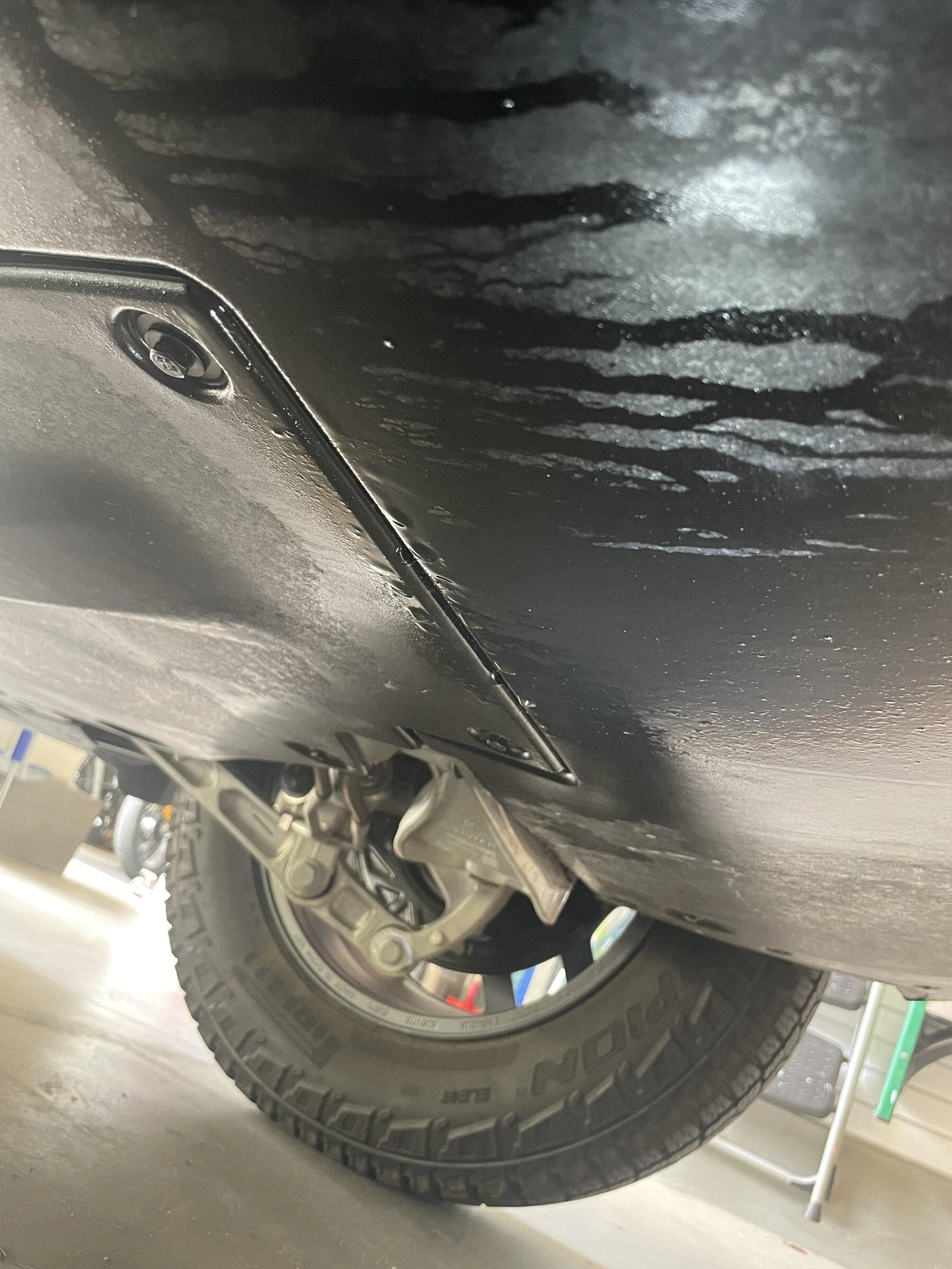

Well, the tow truck came and got it…waiting for diag and time to repair!
PJ
Feb 20, 2024
Arizona
2023 R1S
Just got the call from RIV service dept. they explained we had a front drive unit leak from two places, one being the plug and the other being the half-shaft: Technician details:
The customer states Underneath front of Rivian is leaking an oily clear fluid. The cover on thebottom is coated and puddles in the garageCause:- Verified customer concern as shown in media. The first few photos uploaded shown oncustomer's epoxy floor appear to be condensation dripping from the front evaporator drain.This is considered normal of any vehicle and can be expected to continue. Oil leak found atunderbody shield and surrounding areas was in fact verified to be front drive unit oil. Removedfront underbody shield and inspected front drive unit for leaks. Found passenger front halfshaftseal leaking past seal and down drive unit housing, eventually ending up on shield. Removedand replaced output seal as outlined in service procedure. Also found front drive unit drain plugleaking, drained fluid and installed updated plug and washer as outlined in service procedure.Power washed underbody shield and surrounding areas to rid of oil residue. Test drove 15 milesand verified no leaks at this time. Vehicle is operating as expected.
