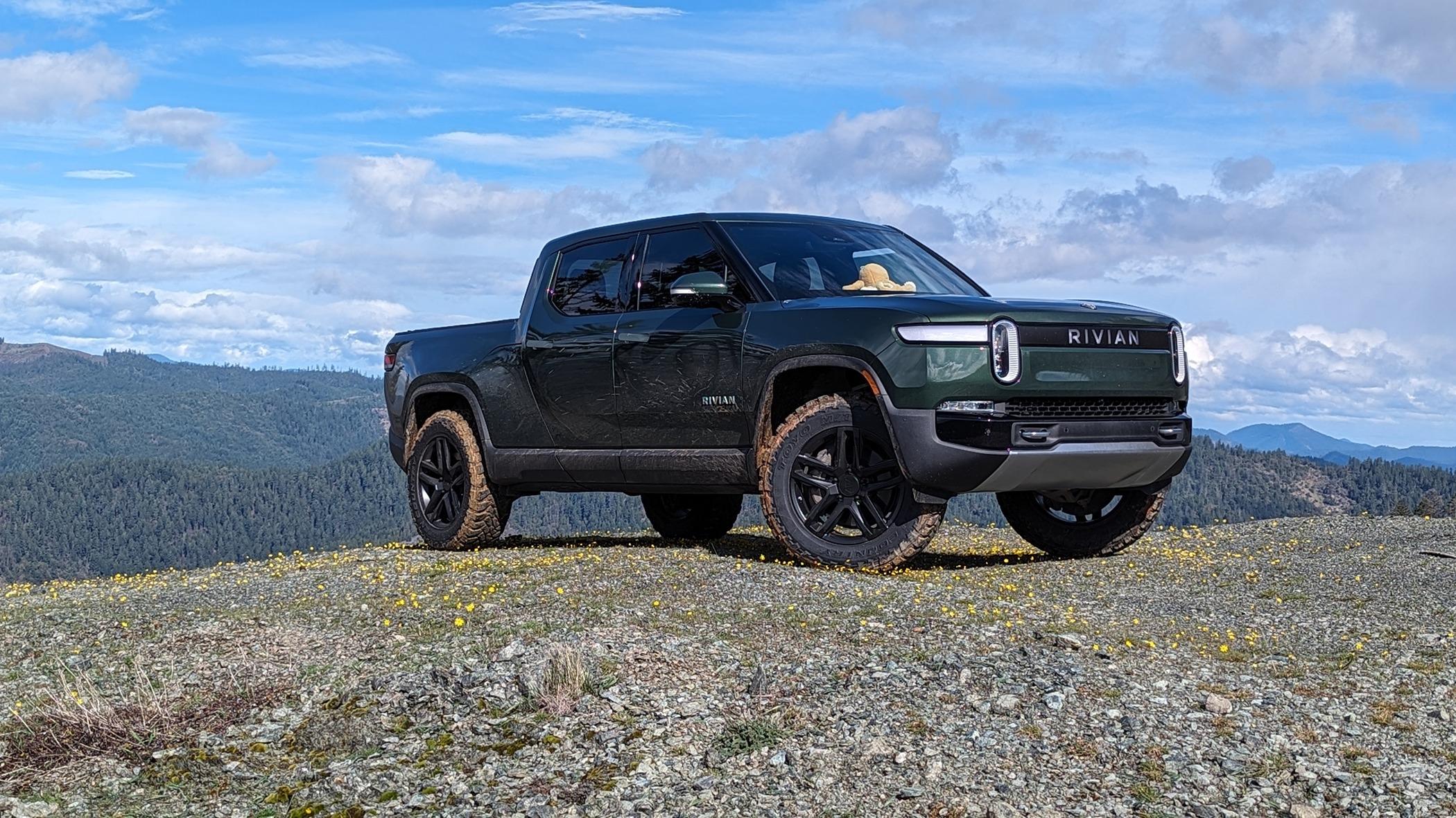

I have gotten quite a few off-road specific questions today regarding how to use traction control settings. It seemed reasonable to start a discussion thread, so others can chime in with their experiences.
This thread is going to mainly concern the DM machines. It is no secret that I am not a fan of the QM for the type of off-roading that I do, so I will let somebody else do the QM thread. QM's have a number of off-road modes to try to compensate for the lack of a differential. Some situations they do fine, others they do not. I'll leave it at that.
The DM does not need special modes to try to help the computer understand what it is driving on, because it has differentials. The differentials act as mechanical devices that automatically vector torque all by themselves; no computer or outside intervention needed.
For most driving situations, nothing more is ever needed. The differentials will smoothly balance power where it is most useful, while giving the vehicle the best possible lateral stability in slippery situations. The DM has "Snow" and "Sand" modes, but frankly, it does not need them. Snow mode does reduce torque to the wheels, but the driver can do that with his foot. Handy for the very inexperienced I suppose.
For the driver that wants to experiment with more challenging off-road trails, however, understanding how to use the truck's traction control to your best advantage can be helpful. I will address some common obstacles:
Rock Crawling:
This is where lockers would be best, but since they are not available (yet), start with TC "On". You want the least slippage possible. If the vehicle starts stalling because of lack of footing, switch to "Reduced" to get some more wheel speed. Careful, rocks can really do a lot of damage.
Lose inclines:
Use "Reduced" setting to keep wheel speed up.
Lose declines:
Use "On" setting for best all-wheel holding while regening down the decline. Try to use regen, with as little brake as you can. Braking will take away your lateral grip, regening (in a DM) will not.
Mud:
"Reduced". If digging is going to help you (hardpan underneath), use less TC.
Off-camber slippery:
"Off". If you cannot get enough traction with it off, try "Reduced", but you may slip sideways more.
Flat slippery:
"On". Usually. If you need more wheel speed to dig through it, reduce TC. If super slippery and you have to dig all the way to what is underneath, "Off".
Slippery incline:
"Off" for maximum lateral stability. Switch to "Reduced" if you need more traction.
Slippery decline:
"Reduced", to improve lateral stability. Try to use regen, with as little brake as you can. Braking will take away your lateral grip, regening (in a DM) will not.
Water crossings, with boulders:
"On", think of this as a rock crawl.
Water crossings mud/sand:
"Reduced"
Deep snow:
Usually "Reduced" or "Off". but snow can vary a lot. If digging is going to bury you, then "On". If you need to dig to the gravel below, "Off".
I hope this gives DM drivers a better idea of how the machine functions, and makes you more confident playing with your settings next time you are on the trail. Another tip is to keep the vehicle in "Standard" height unless you need the extra clearance. This gives you the best articulation and keeps your center of gravity as low as possible.
Happy trails.
